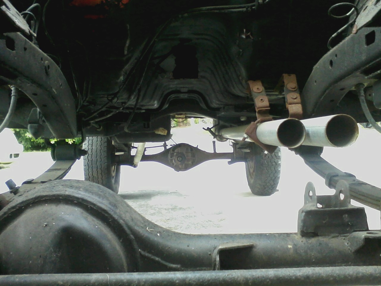

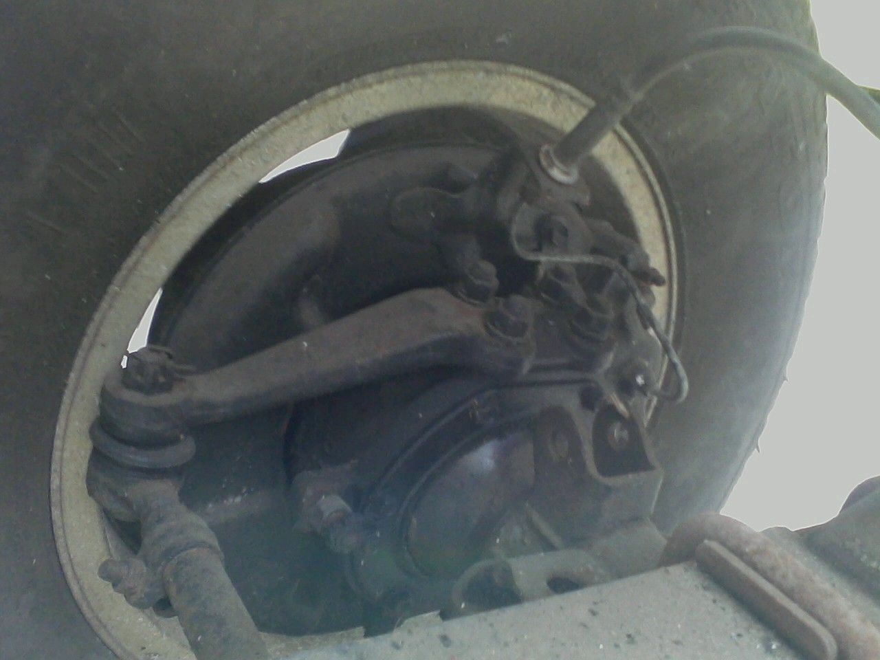

Anything I should take off the motor before installing? Tips tricks? I will get some engine and action shots tomorrow hopefully.New 82 with 83k in 84 pieces!-photo-28-.jpg

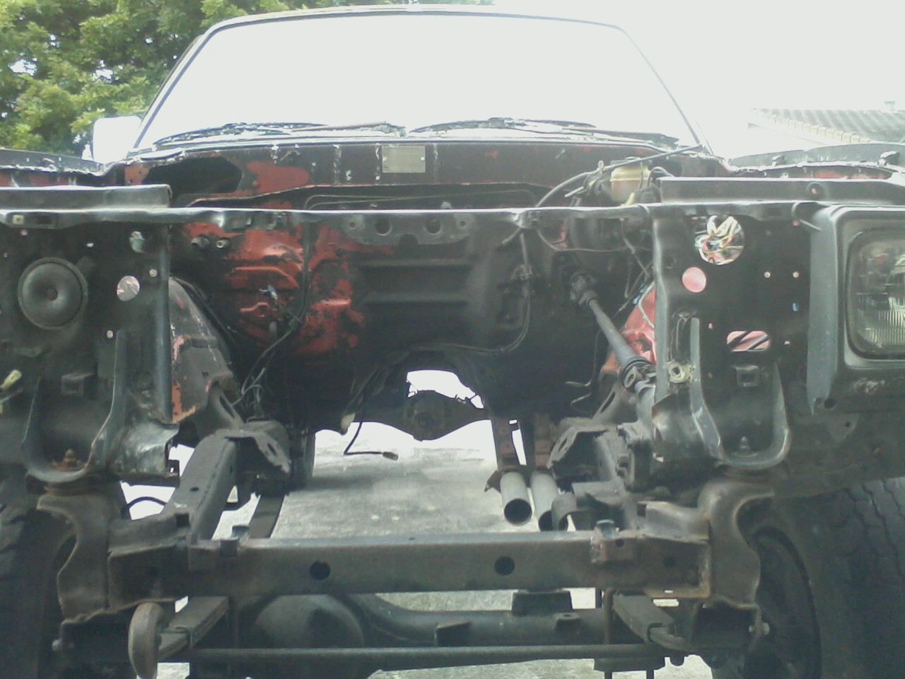

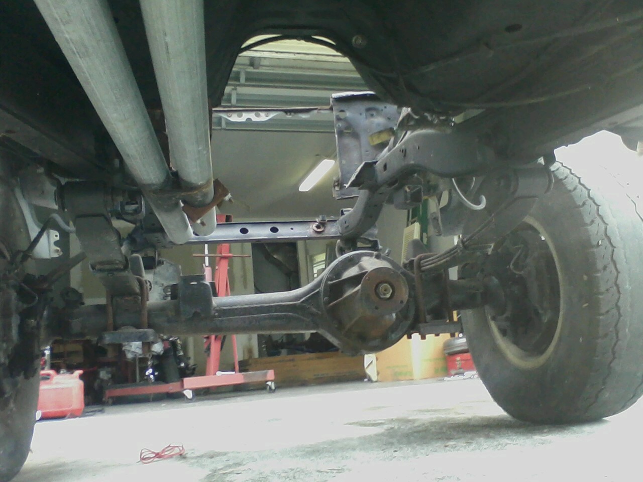

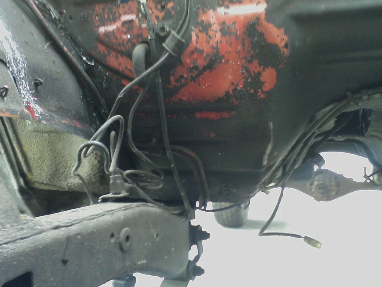

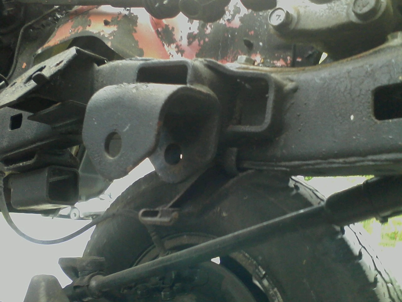

Anything unusual here besides the dual flowmaster exhaust?

Yep.... I wouldn't say that the PO was GOING to do a V8 swap, I would say that he did or at least started to based on that hacked up radiator support. Couple that up with the dual FlowMasters and lack of engine, I would venture to say that something other than a 22R was in there at some point in time. You're going to want to check to make sure the engine mounts on the frame and the tranny crossmember aren't modified. Might want to check the thirds too incase a V8 was hooked up to them and caused damage

The v8 never got into it, he got as far as mounting a chevy auto trans mounted to a toyota TC with downey adaptor (for sale). He cut the supports to fit a volvo radiator and made slight addition to the crossmember that apparently will not interfere. It's been garaged for 12 years.
He also painted the engine bay chevy rust color.

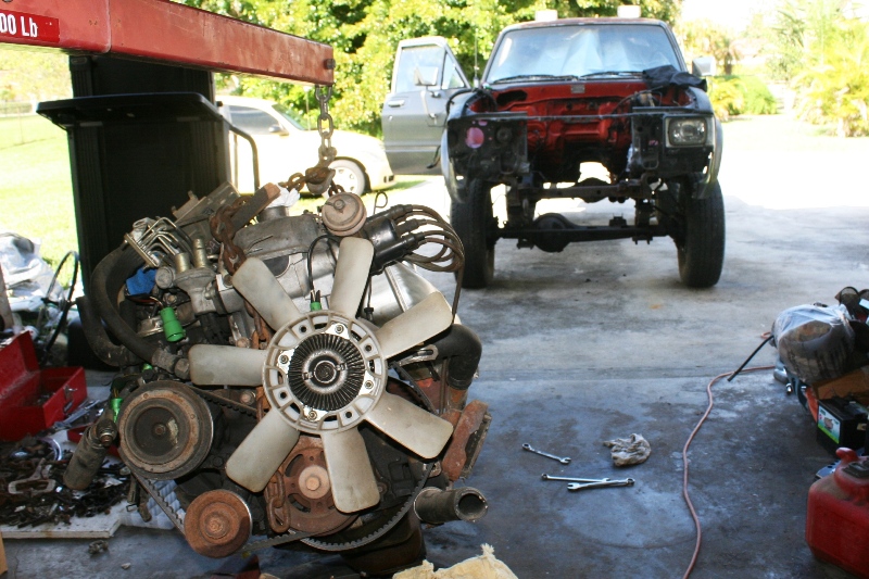

motor in

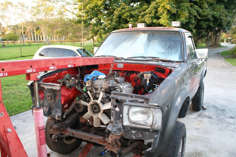

made progress, motor and ignition are in and the truck it's in my driveway. Be careful hiring a flatbed on the list, I have a long and thankfully funny story not for polite company on the experience.

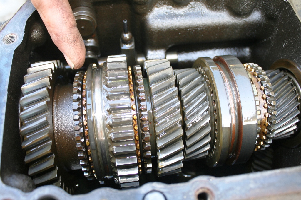

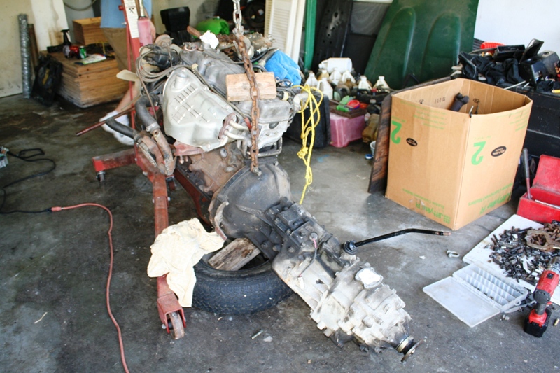

The shifter came out and went back in after some jiggling; I didn't think it was going to work out for a few minutes.
Gears look nice but the only L-50 gears I ever saw so IDK. Pretty big tank of a case for nice little gears like that.

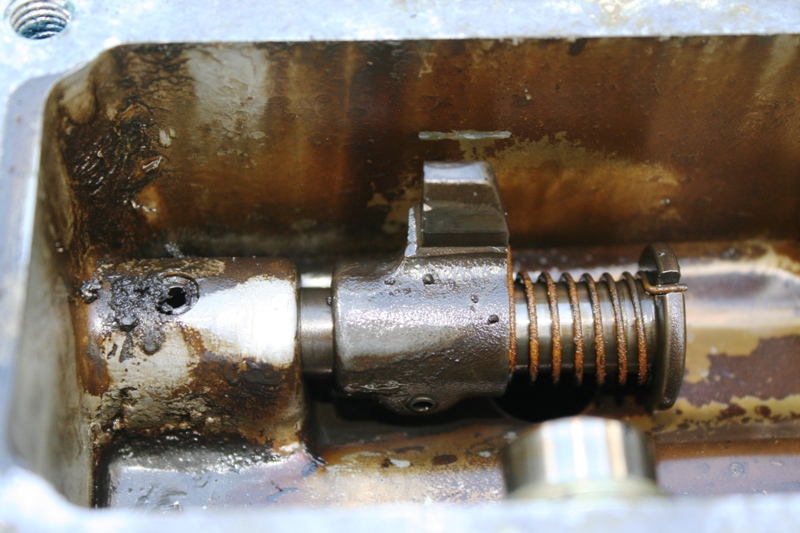

There was some silver sludge sediment crud in the shifter cup part and a wear mark.

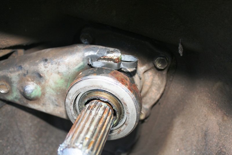

the Throwout bearing retainer clips were not what I was expecting but seem to be the correct part. Can anybody confirm that these are the right ones? the pic revived my curiosity.

The clutch fork, throwout bearing and clips are all correct. I know it seems a little cheaply put together, but it works. Be sure to check the clip on the other side of the fork that holds it only to pivot ball - sometimes those can be a little worn out.

Wrote a long-winded reply and got cutting-off. In short; I did not install a pivot retainer clip or know it existed until now.
Could I get it on through thes side maybe or rig an external brace?
