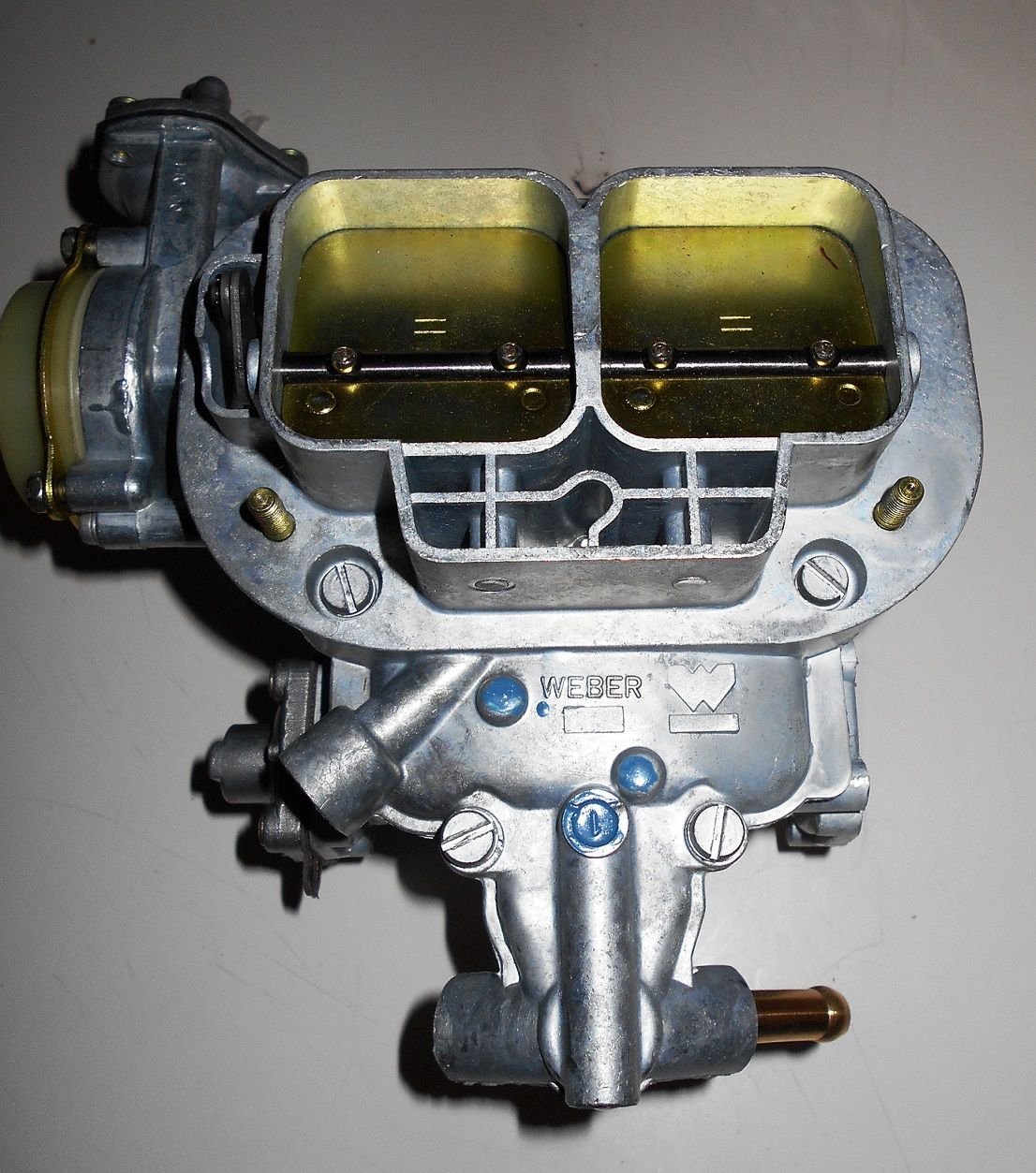

Sorry to burst your bubble, but that black choke element cover shows it's not a european weber (http://genuineweber.blogspot.ca/). And I don't know why you would want another transmission unless you drag race a lot and want to push more than 200whp, anything other than the L-series will require a relocated crossmember and driveshaft modification, the l52 is usually plenty strong even for off-roaders and crawlers.

I didn't mean anything I said in a bad way at all, just trying to help as I did with previous posts on your build thread which I enjoy. You said you were waiting for an italian weber, then said there are no chinese knock off parts on your engine build, then I pointed out that your carb was a chinese made ''weber'' with a link you can use to spot the differences. Maybe the ''bursting bubble'' saying doesn't mean the same thing in my language.

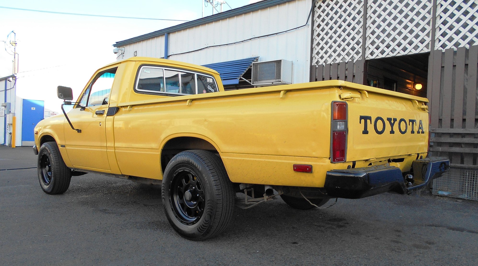

Got the wheels in and installed tonight. 205/70/15. Truck looks so much better ;-)

Did a bit more checking into this issue and after contacting the company that the work was preformed at I questioned the owner and to his knowledge a genuine Weber was sent. I pointed out the facts that you showed me. He's ordering me in the proper and real Weber. Thanks! I would have gotten bent a bit and not even known it

The wheels before was normal car wheels. Couldn't find anything at that time and wanted something NOW!!
Three trips to the tire store and that was the best choice out there and they nailed it this time. Looks more like a trunk now

Just got the new carb in this morning and its a real Weber this time. Thanks for your help Dave
Just went out for the test drive with no adjustments and the truck runs AWESOME. Feels like twice the power after having that crapper on as long as I did. Feels good for a Toyota..this is my first time restoring a rig

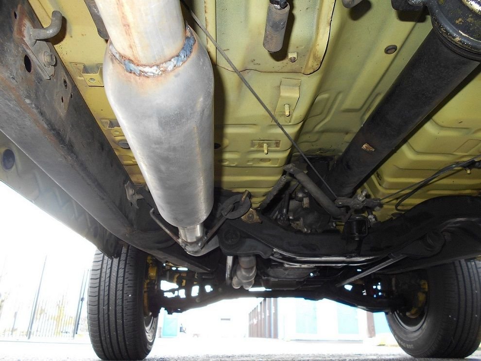

Crawled up under my truck this morning and after a bit of scrubbing this is how it turned out, looks good for being the original paint under here. Got to get back under there and get the underside of the bed scrubbed and degrease the transmission and frame rails. This was originally a California truck that was brought here a few years ago. No rust anywhere but the little that was hiding at the tailgate area that was cut out

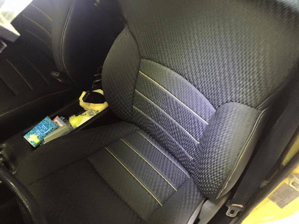

Seats, carpet and door panels completed. Black on black with Yellow stitching

Not too shabby! Looks like they added some bolsters to the seats - Were those the original seats?
