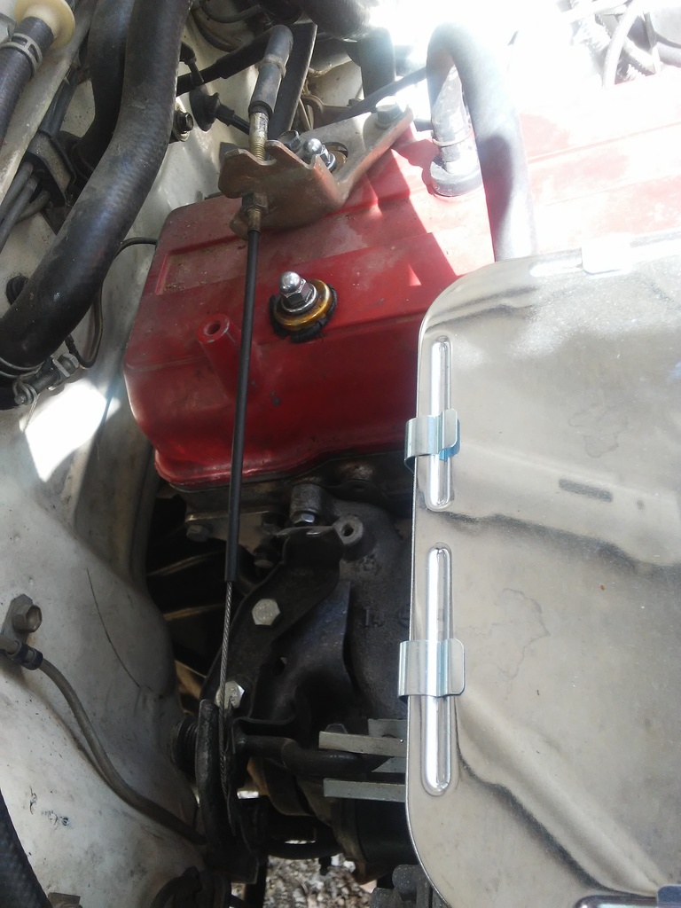

That explains a lot. I just figured since it was a fake that the throttle cable went to the front. Thanks for catching it. I'll switch it around tomorrow so my throttle cable doesn't have to lay acrossed the valve cover.

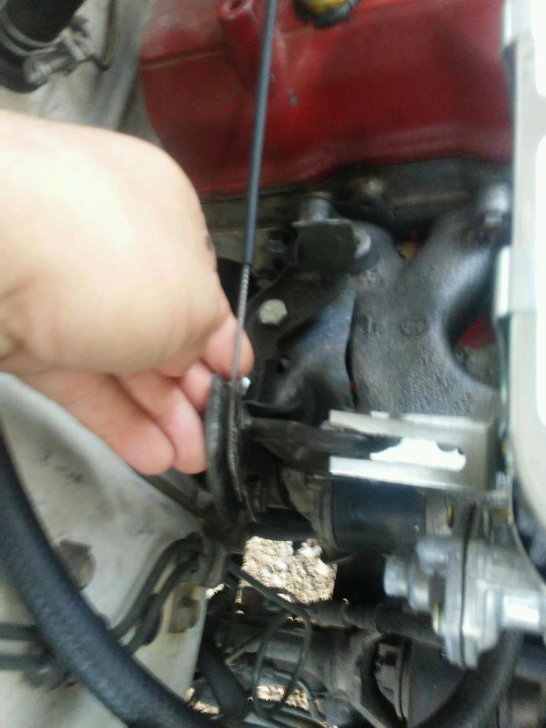

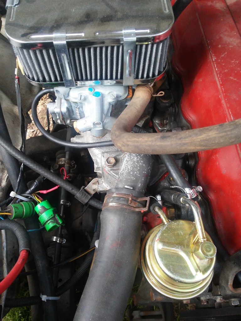

I am having difficulty with Photobucket but here is how I have my cable for the Webber. Really pay attention that it lines up well with the cable holder where my hand is as it can cause idle problems. I will get another picture for how I have my fuel lines routed as soon as I Photobucket straightened out.

Here hopefully you can see how the cable is mounted to the Valve Cover and how it should run to the carb.
