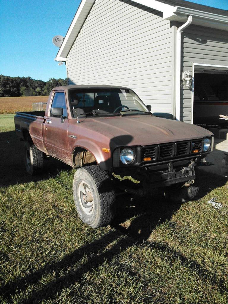

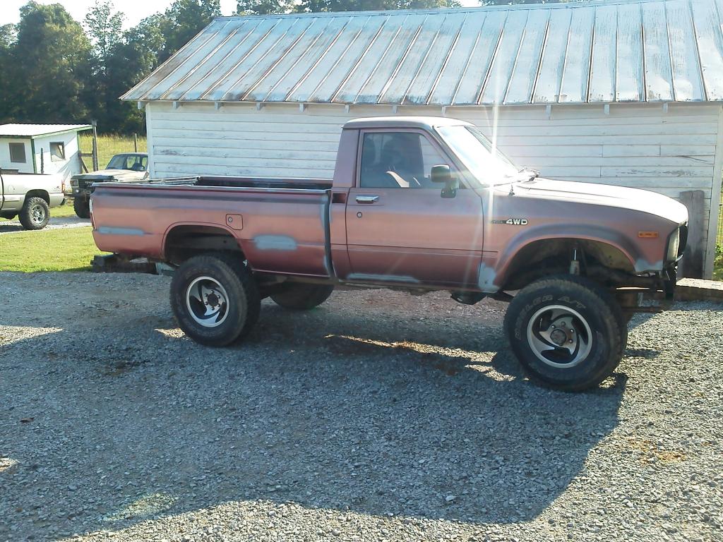

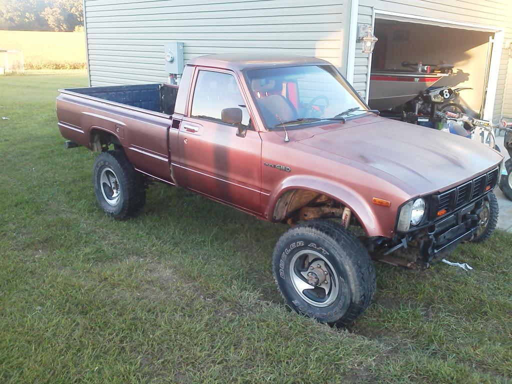

I've been lurking on the site for quite a while now and have finally decided to start a build thread on my truck. it is an 81 long bed 4x4 with an 84 22r and 5 speed swapped in by the previous owner. I'm not sure how many miles are on it, but then again I don't really care lol I believe it has a 2wd bed on it(someone correct me if I'm wrong) and not sure if it is lifted any either. it looks like it is a little bit with 31x10.50s but I'm not sure how high it should sit with 31s. anyone know?
my plans for the truck are to make it a capable offroad truck but also be a reliable daily driver. so I want to keep it simple. I was thinking 33s, regear to 4.88 or 5.29, lockers, weber 32/36, headers, armor, paint, and possibly power steering. I kinda like not having it because its one less thing to go wrong, but then again turning 33s would be a bear I guess.
I have already replaced the front main seal, oil pump cover seal, and i pulled my bed off and fixed a bad spot on the frame. so that's where I'm at right now. ill try to figure out how to upload some pics.

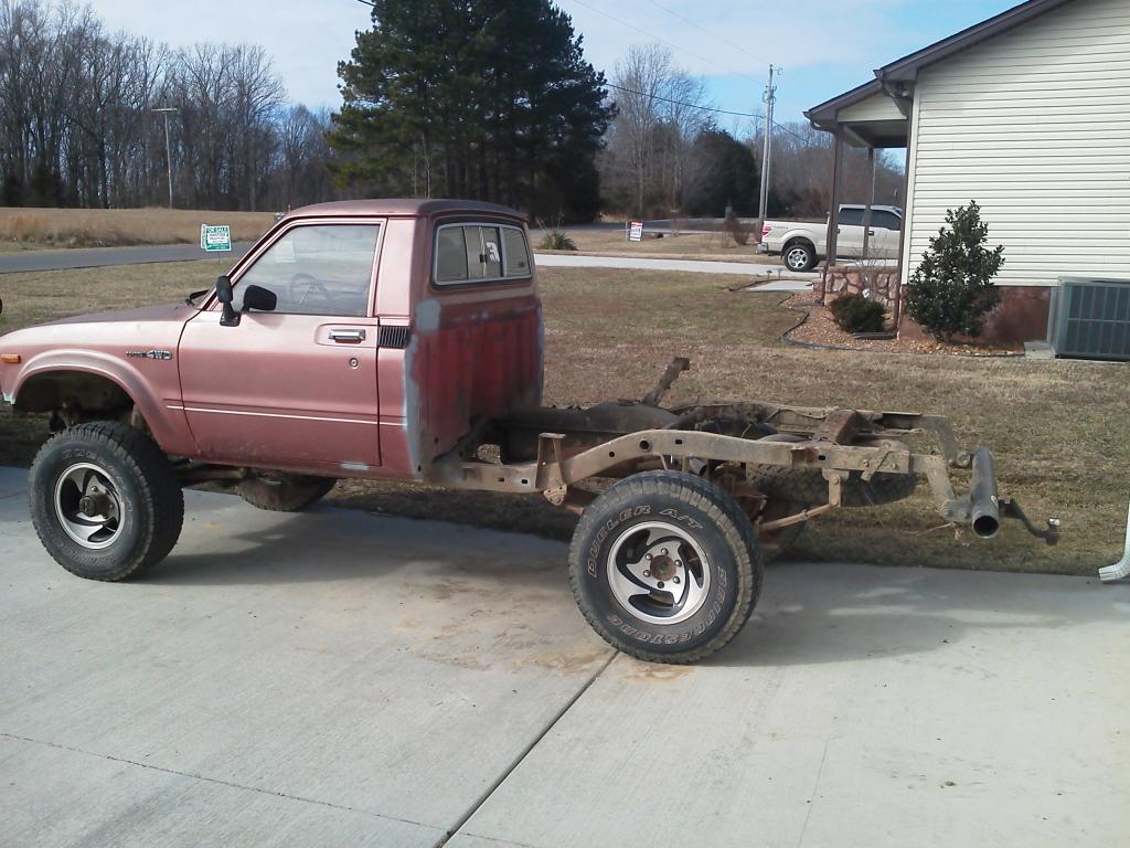

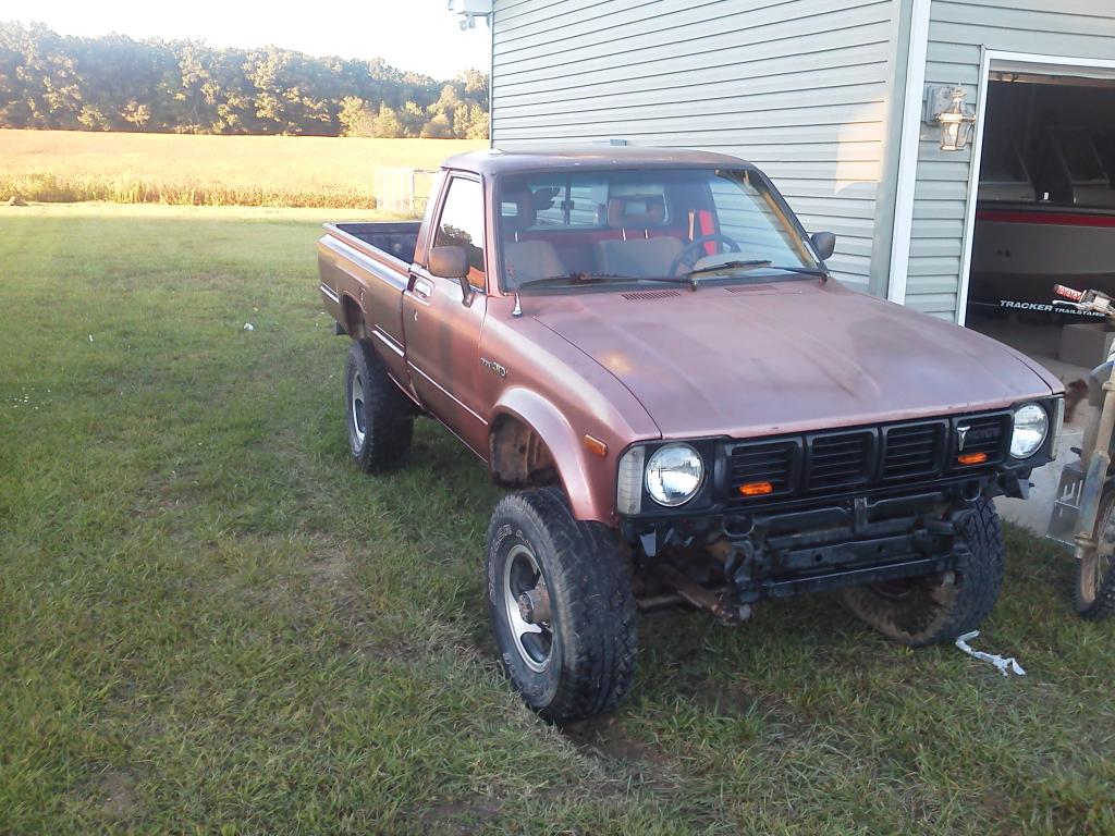

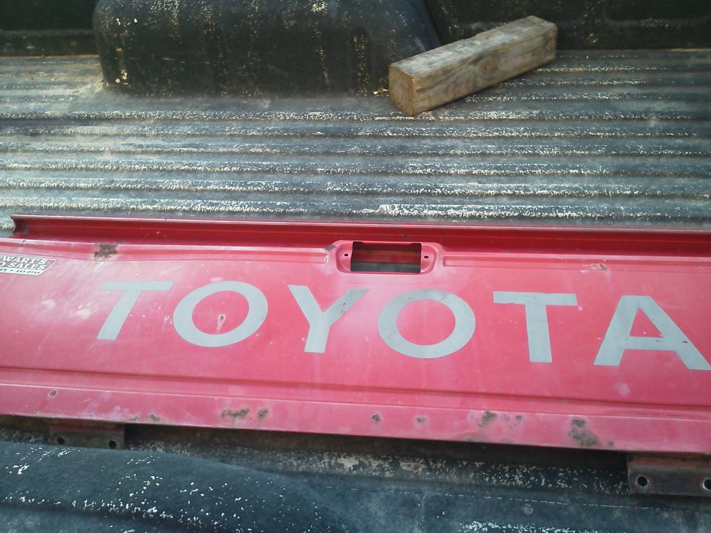

here are some more pics of it with the bed off, and the tailgate i got for it out of the local pick n pull. when i bought it it had a tailgate off a second gen on it. so i had to find a first gen one. its a lil rough but i can make it work.

That is a second gen pickup bed as well - that's why it had a second gen tailgate on it. That first gen tailgate will not fit that bed

I forgot to mention the tailgate came off an 84 2wd so it does fit my bed, its extremely tight tho for some reason. I didn't know the bed was a second gen, thanks for the info. I'm starting to think I might have a bit of a franken-yota lol

Yep, definitely a FrankenYota - 2nd gen bed, hacked front fenders, missing front valance, mystery seats and that's just what I can tell from the pictures so far.

Yeah whoever had this truck before me did not take the time to fix things the right way,I got a feeling alot of my time is going to be spent fixing their messes. But that's part of the fun I guess.
On another note, does anyone think it looks like stock height?

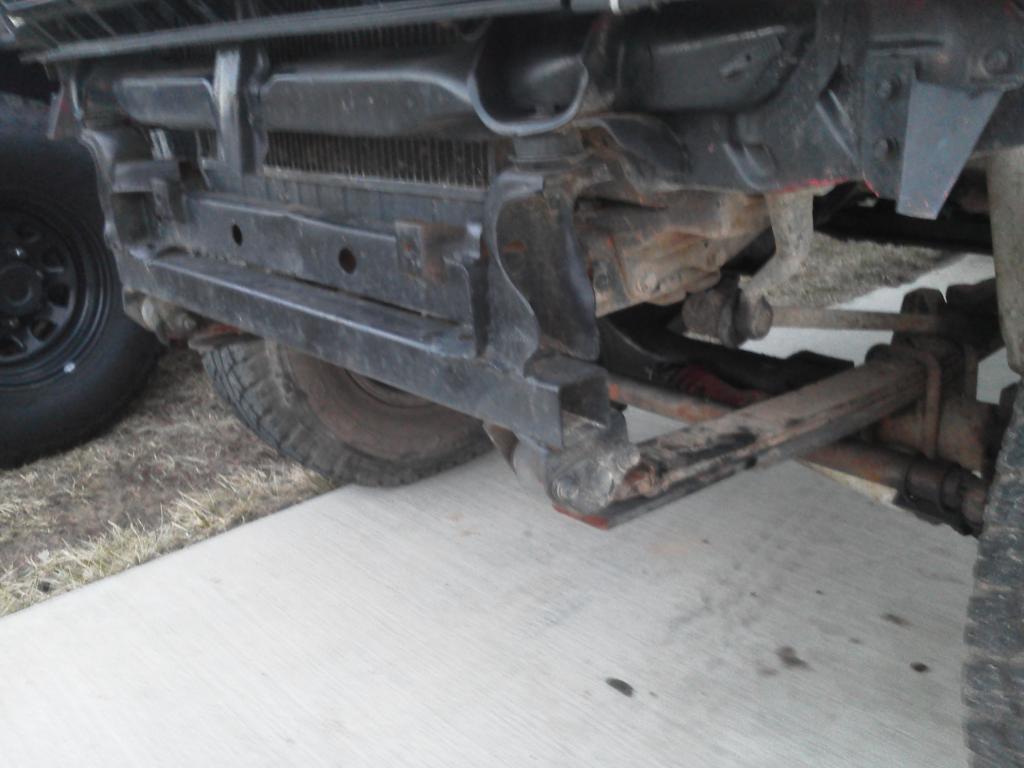

The front leaf springs look pretty flat, no arch to them, I'd guess that they're stock, it looks like to me that someone cut off the factory front spring mounts, then welded a new front spring hanger onto the existing front crossmember. That's were your getting your lift. Looks like a nice truck to start with, the 83' I had before the one I currently have was really bad, someone cut a hole for a sun roof that was too big, then installed the glass anyway, and covered the whole mess with bondo, lol....look forward to seeing more pics and updates!

took some more pictures for y'all last night. the first one is of the front end where after what rustED said I checked it out and sure enough it looks like someone has welded a tube across the front to give it a little lift.

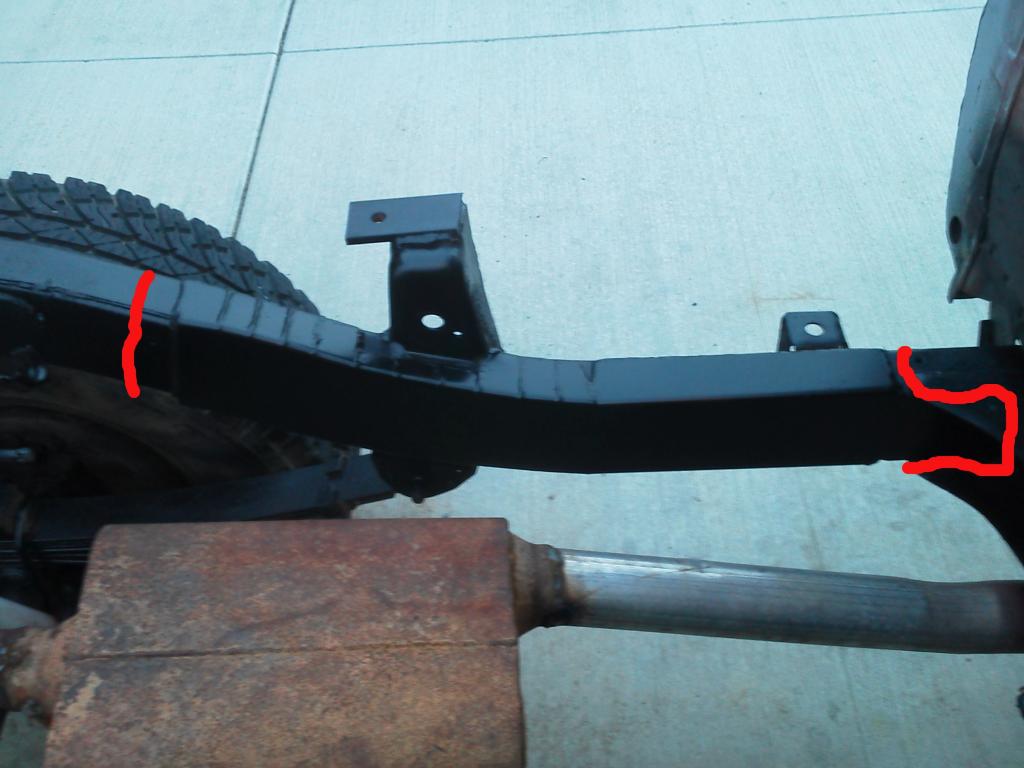

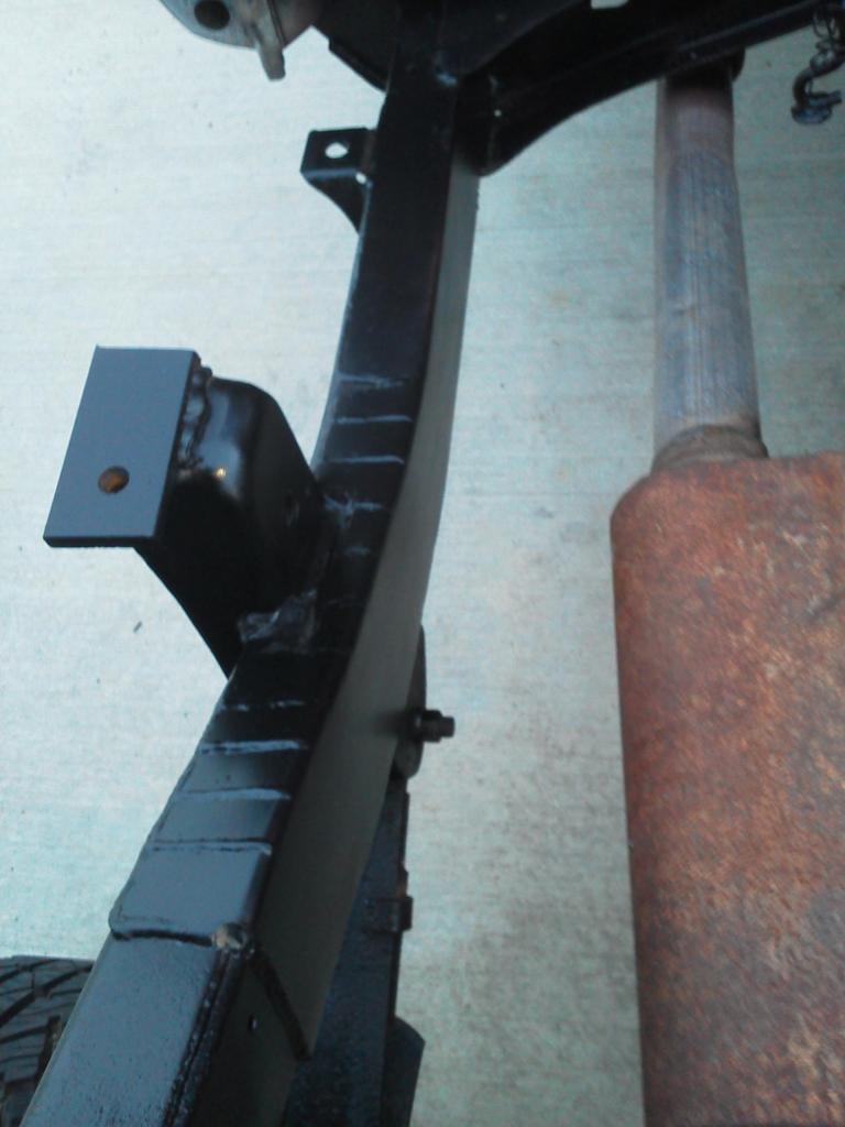

the other 2 pics are of the patch I made at work and welded over my rusted spot on my frame. I made a c channel out of 11ga steel that matched the arc over the rear axle and barely slid over the frame. it was a TIGHT fit. I had to hit it on with a hammer. but it fit good. and it should be twice as strong as it ever was now. I welded all around every edge. the last pic shows how long it is. kinda hard to see with paint over it now. I meant to take more pics of the patch and before I welded the frame. but I forgot and got caught up in the moment lol

Nice work on the patch. Also noticed that those bed mounts have been tampered with.

thanks, it took me a lil while to figure out that arc and make the channel all one piece, but I worked out good.
