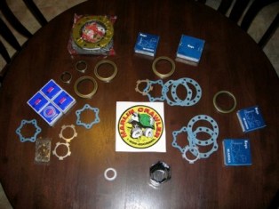

The goodies from Marlin came in today. Probably wont be till the week of thanksgiving when im outta school till i get a chance to really work on the truck.

Alright I finally got some work done on my truck between school and work. I tore down the front knuckels to rebuild them, found out why the wheel was about to fall off. The bearings in the knuckels were shot, and I mean shot; they were completly shredded. I am going to order some new stock replacement birfs tonight, mine had a little slack in them. Is that okay or should I get new ones?

I just did a knuckle rebuild myself. My birfs had a little slack but I decided not to replace them. I think there supposed to have some slack. Not a bad idea to replace them if you have the $$ and then you have the old ones for spares.
