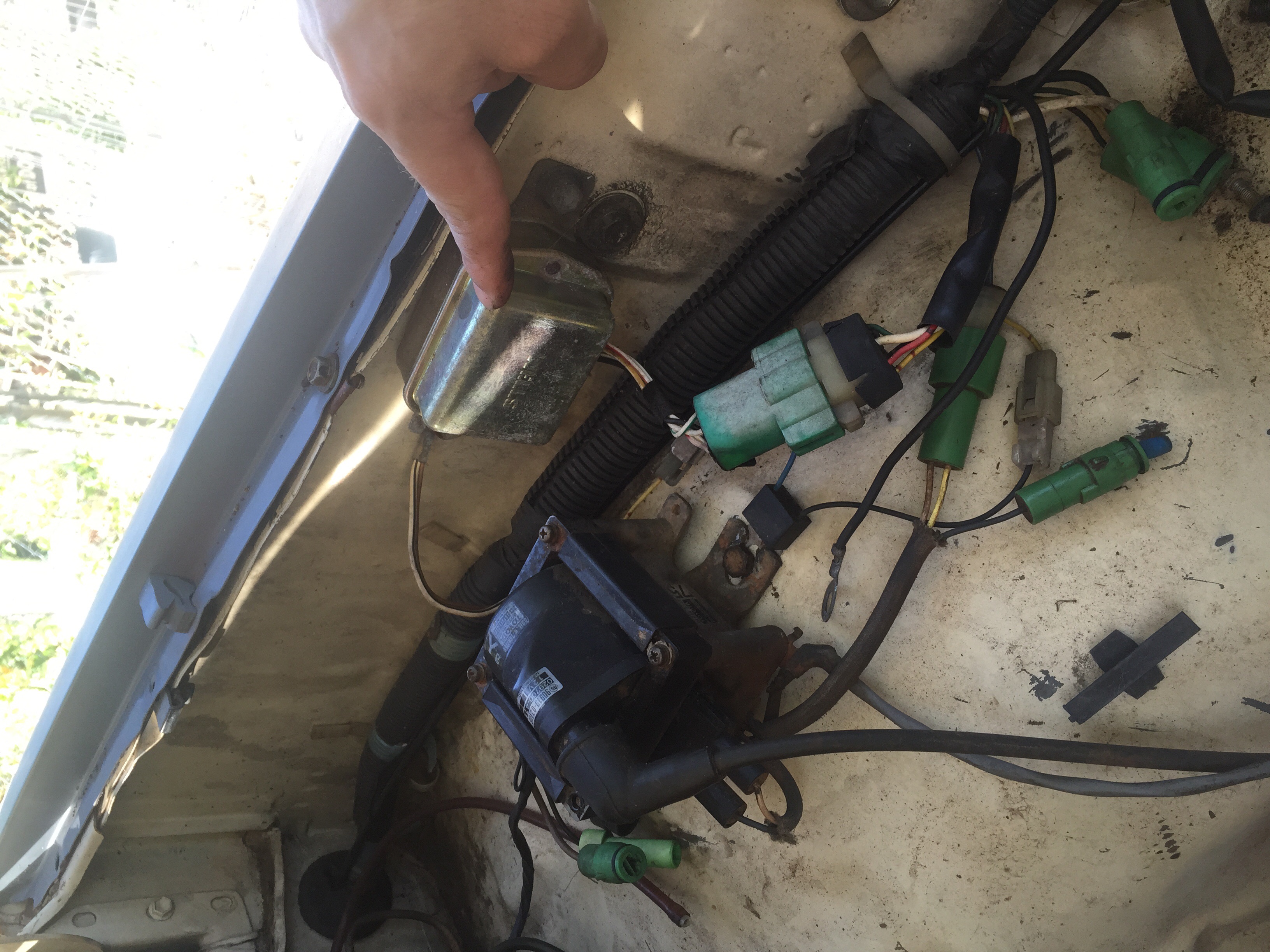

I have a few questions:
What is this on the front driver inner fender:

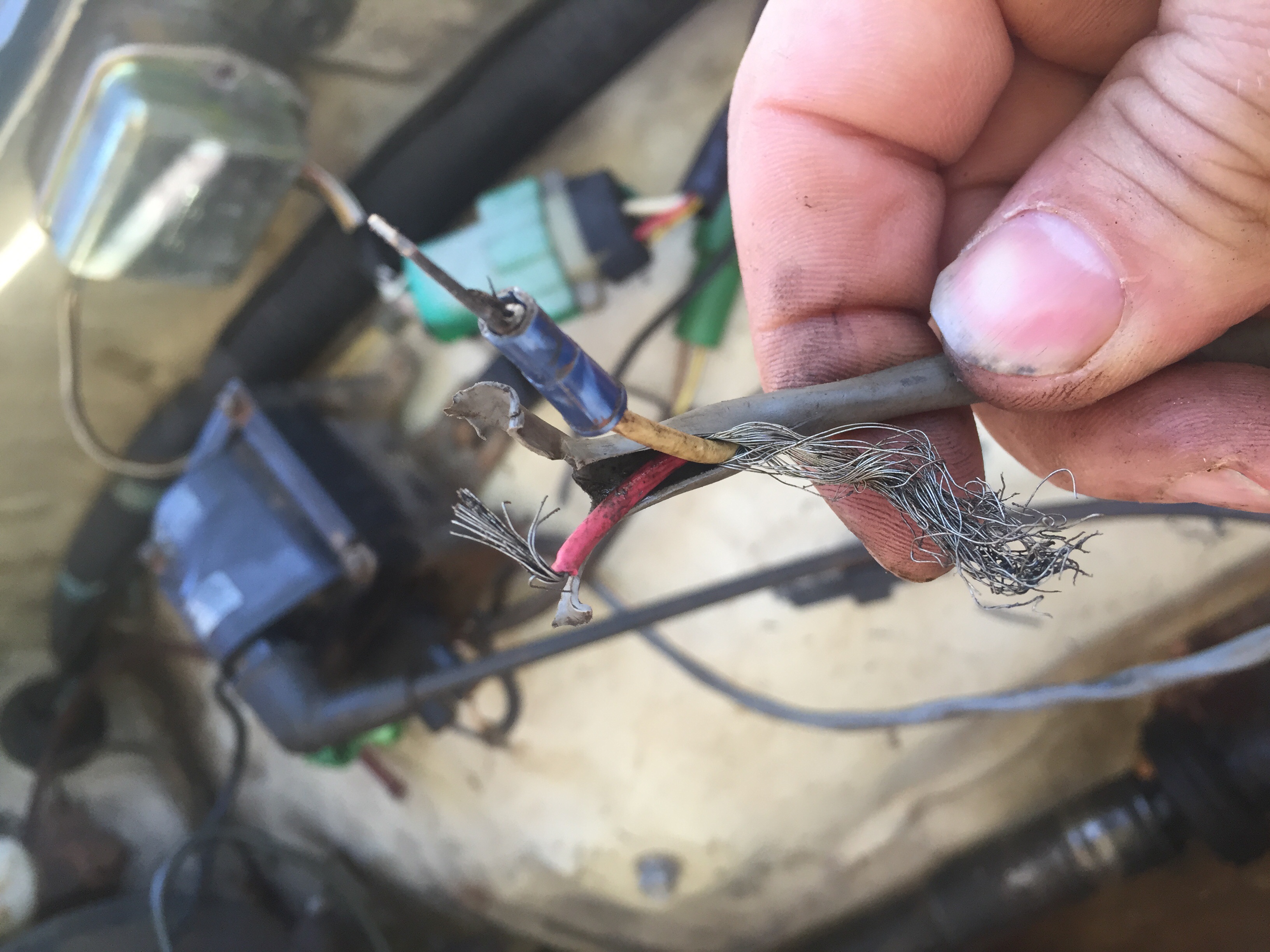

What is the deal with the wires coming from the ignition coil. There are two wires (white and red) and those two are wrapped with another stranded wire:
That is the voltage regulator
Looks like the wires that go to the distributor, the one with no shielding may be a ground

Yes they go to the distributor but why are there two coated wires (white, red) and then those are wrapped with another stranded wire. Is there something I need to do with that stranded wire?
