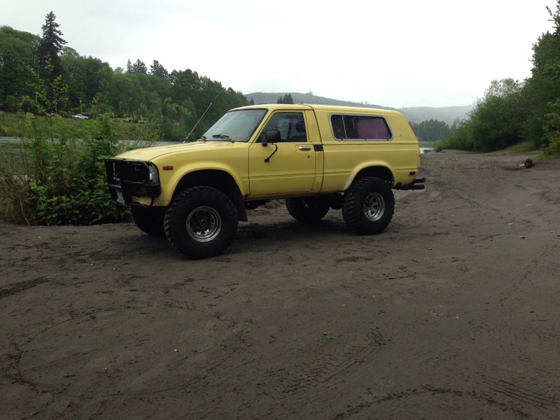

Hope this pic shows up. Went down by the river this weekend in the trekker. I am very happy with it so far. I need to regear it when I save up the cash.

Pic was great....nice to see it rollin around.
