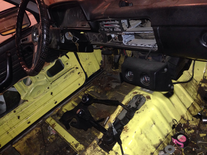

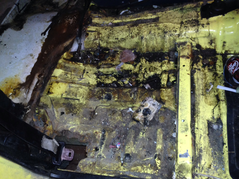

Well I got some stuff done. Life has just been in the way for me to get too busy on the trekker. The pics (that I hope you can see) are old from before last weekend. Got my lift in, stripped the interior, and got most of the passenger side floor pans done. I will take current pics today and try to post them.

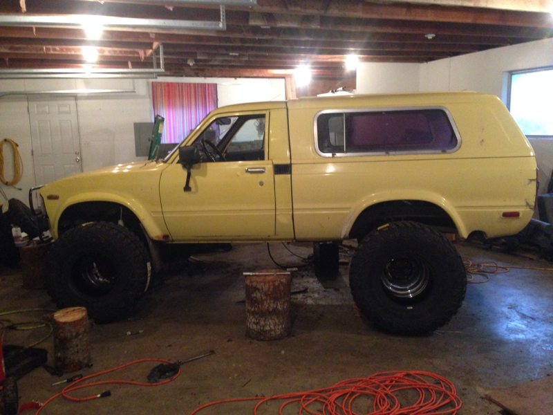

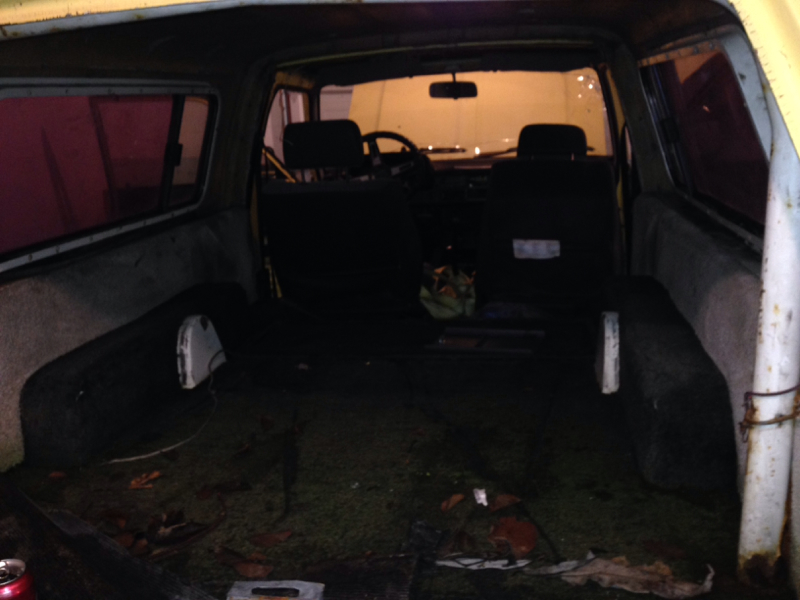

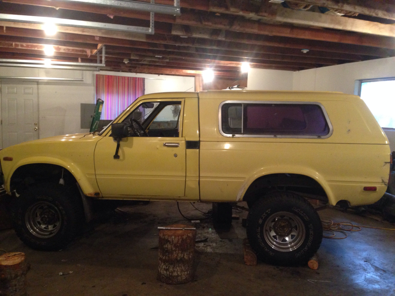

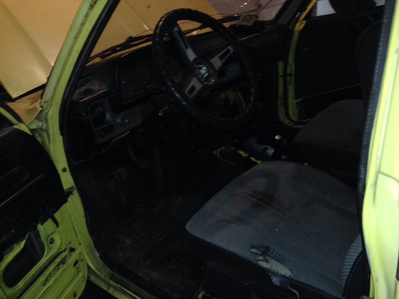

Well these are the updated pics. Lifted 3 in, bought some new Goodyear mts and can't wait to put them on. Right now gotta get the rest of the floor pans fixed and then get the tranny the rest of the put in. It had a messed up 5 speed with missing gears so I took one out of an 83 and put it in the trekker. So as of now got to fix trans xmember and drive lines. The new tranny was longer. Anyway this is some updated pics I will post more as I go and fix and find new projects.

Well I would like to make it a nice dd/weekend trail rig but I don't want to go too extreme. But first I want it to be nice and reliable. Plan to keep the 22r I just gave it a tune up and soon gears and tires.when I finally finish the floor pans I will paint and do some interior. I was thinking indoor/ outdoor carpet? Anyone have ideas. Also question to my fellow Trekkies any ideas for a rear seat. Mine is gone for the most part.
