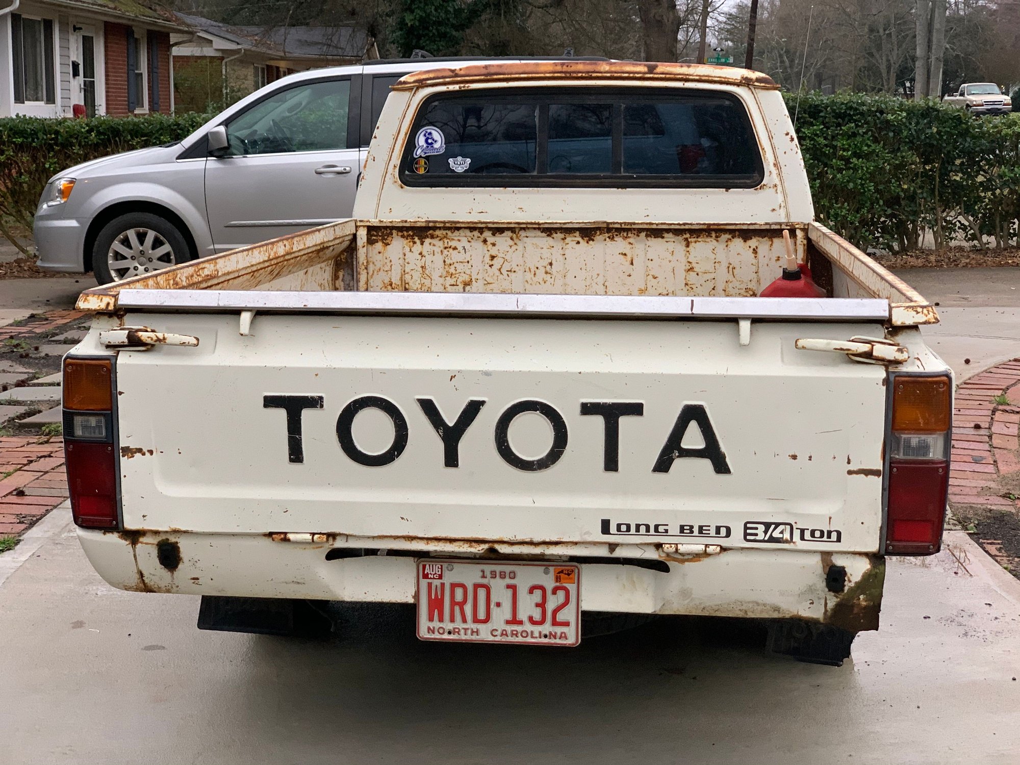

Hi folks, picked up my first Toyota this past weekend. Previous rig was a 1996 ZJ Jeep Grand Cherokee 4.0 with about 5 years in between selling that one and picking this beauty up. I wheeled the Jeep a good bit and really cut my teeth learning a lot with it. This yota will be far more mild, just a fairly stock driver for hauling the occasional lumber and firewood type of deal.
Bought it from a mechanic who in turn got it from the original owner. She's pretty much untouched and that's just the way I like it. 62xxx on the odo but who knows how many times it has made that trip around
I liked the long bed and the fact it's a 4-speed. Would have liked the 5-speed and 4x4 but such is life. I'll have to look into swapping in a 5-speed down the road. I imagine it shouldn't be hard to do, but I don't know if they ever came from the factory with the 20R.
Original paint is in decent enough condition for 40 years old. Roof is the worst of it but I'm probably gonna do some sort of rust treatment and then clear coat it as is.

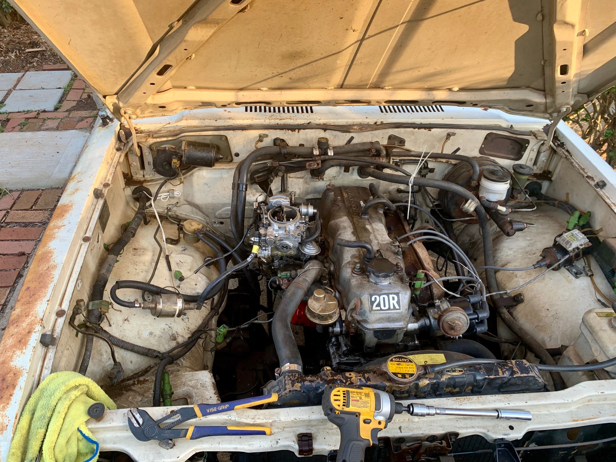

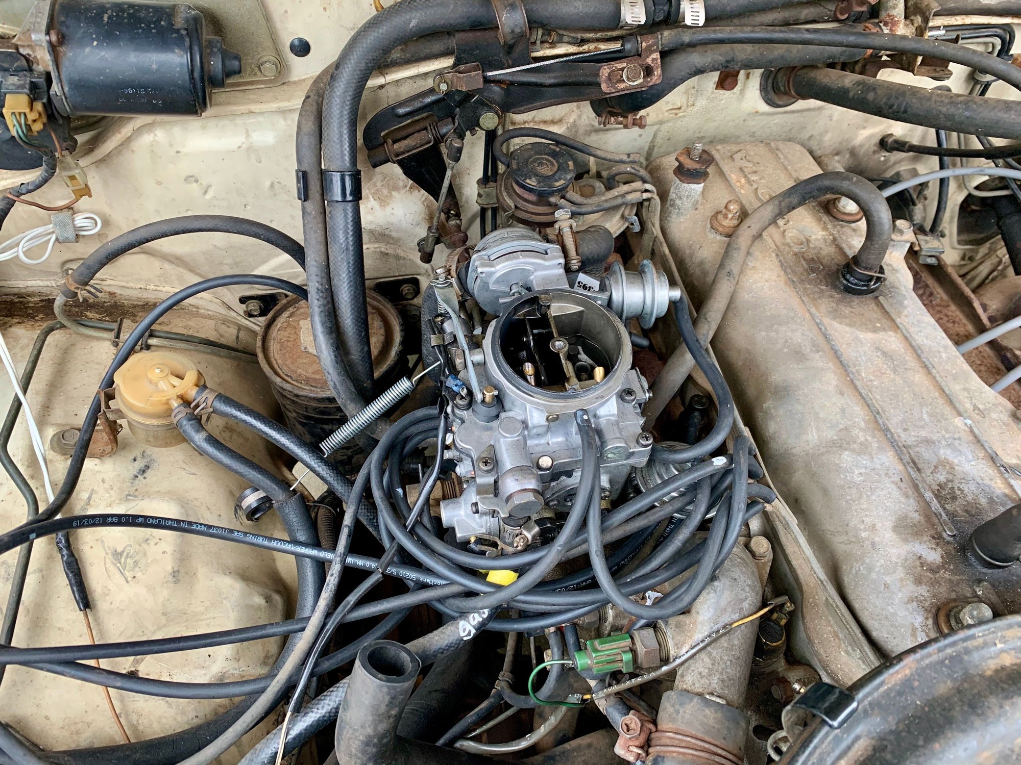

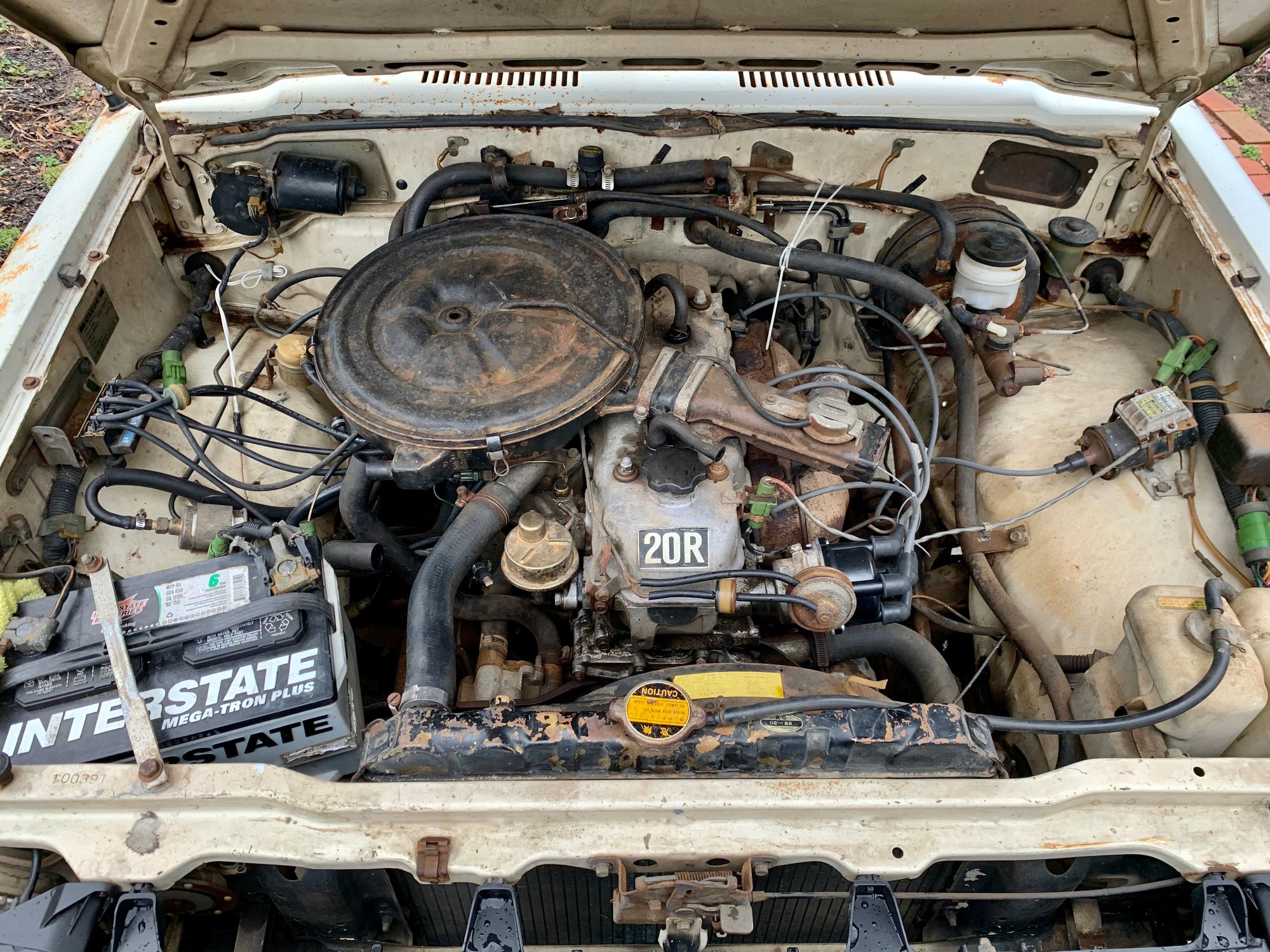

Day One:
Day 1, as it came from the factory.

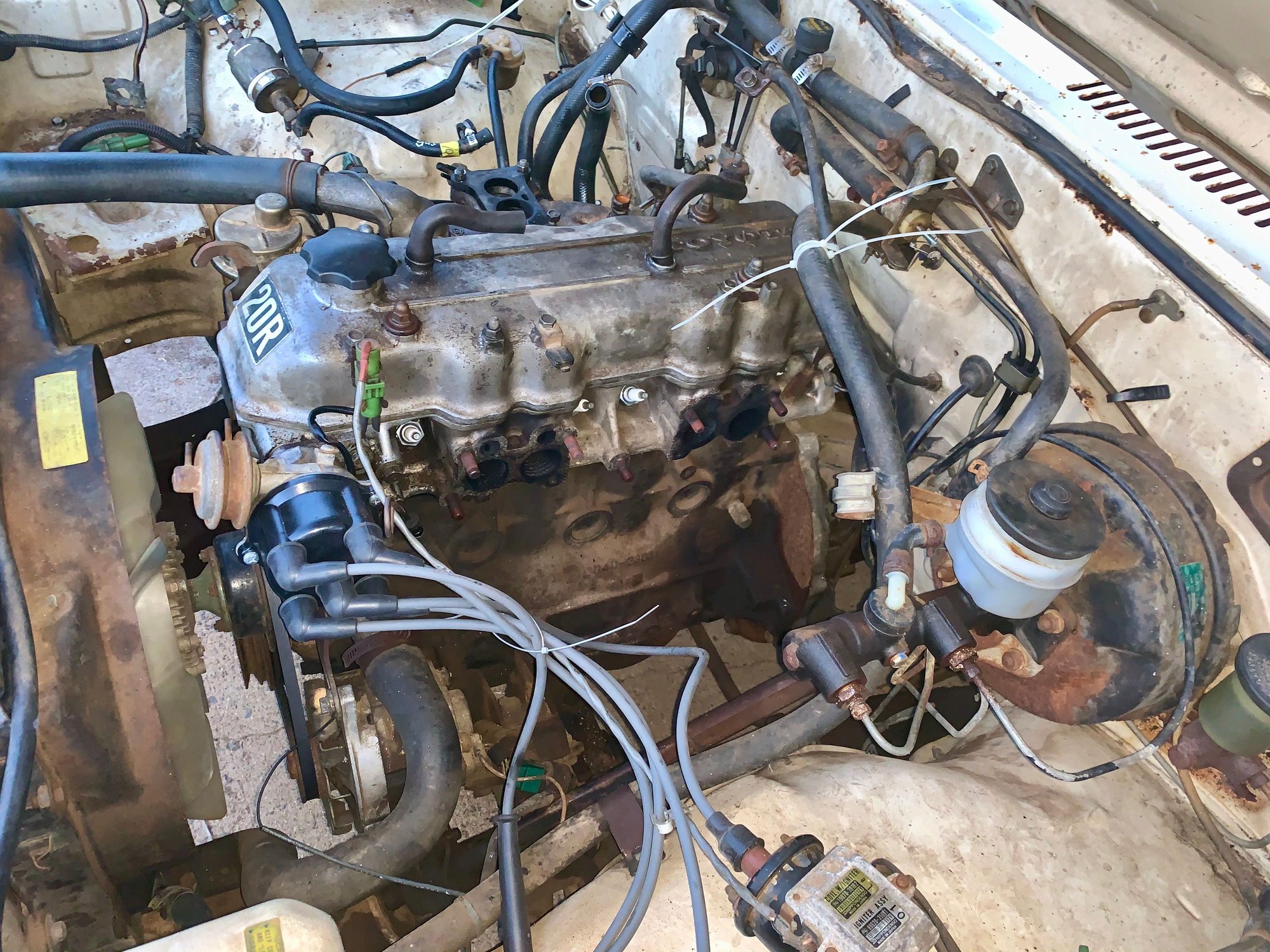

What in tarnation.... I like spaghetti for dinner, not in my engine.
Starting to make room....
Need to decide on Shorty or Longtube headers....
Advice on how to clean this up in place? Won't be pulling the motor out just yet.

Think I'm going to pull the intake manifold as well just so I can get clear sight lines and room to work and clean up the whole thing in one shot. Might as well do it all now from the get go. Might even pull the head. That will be new ground for me.

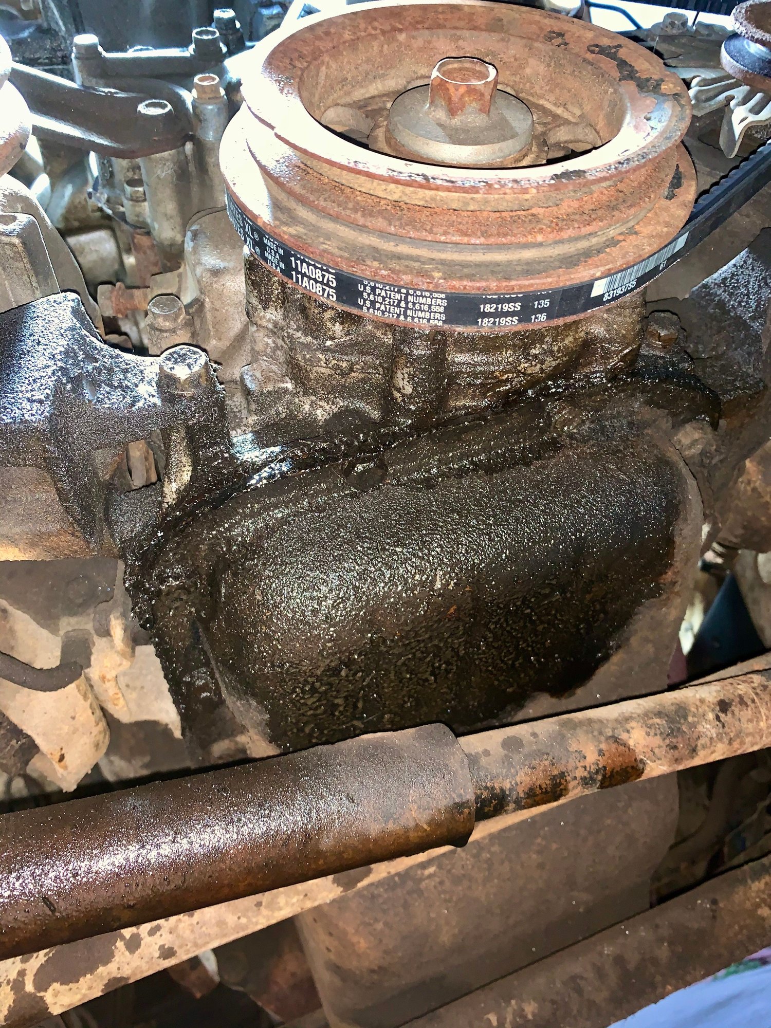

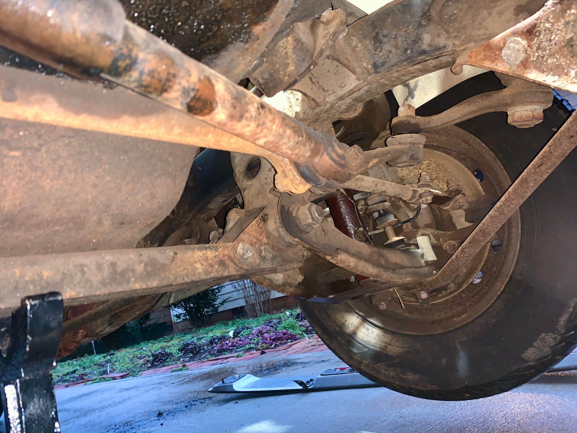

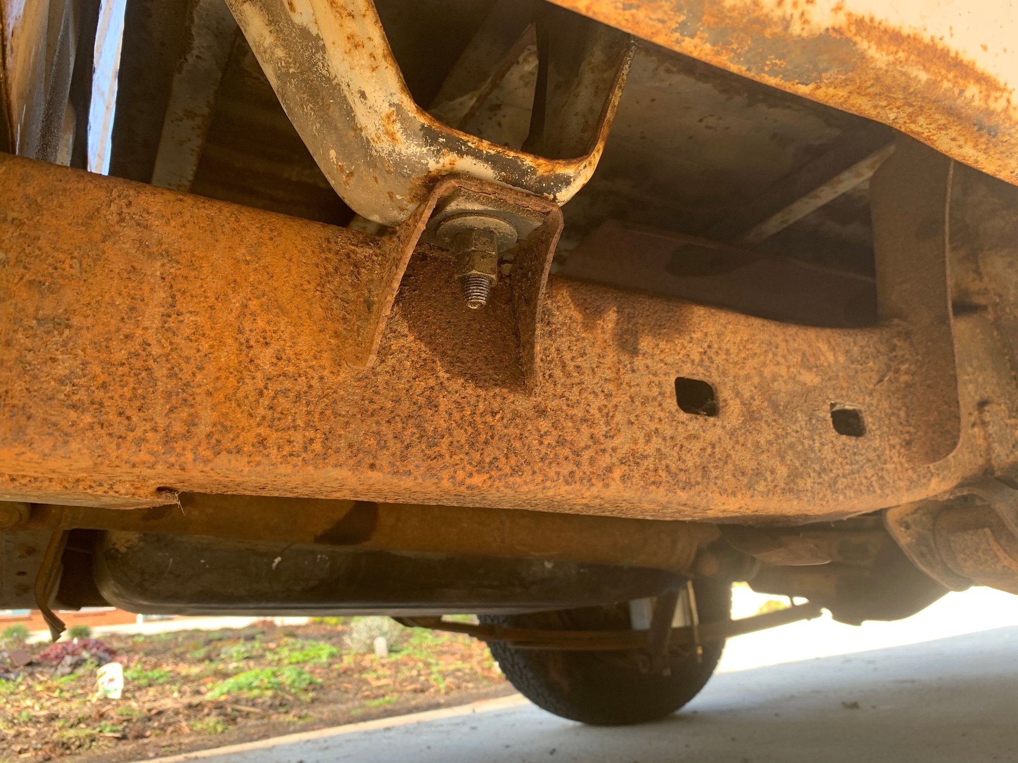

small front end leak
grimey

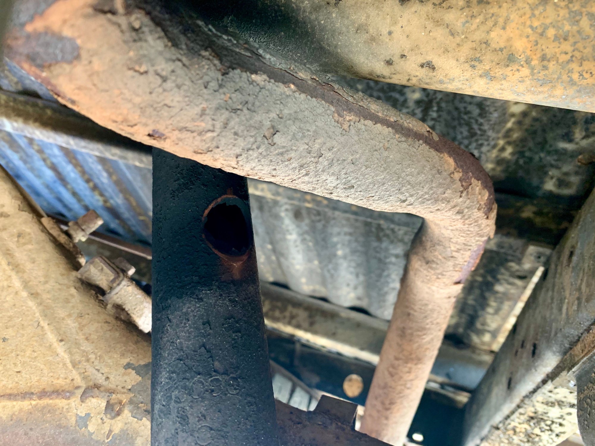

exhaust burned a hole in the shock tube
not too bad really

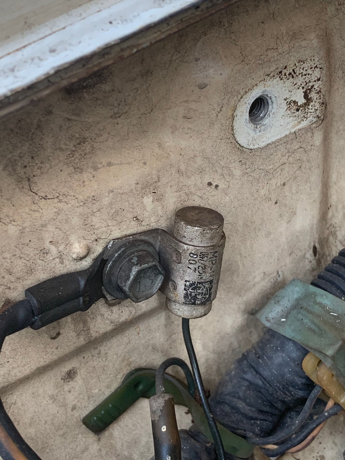

What the heck are these?
Old Feb 10, 2020 | 09:00 AM
81rustBucket's Avatar
Joined: Jul 2019
Posts: 23
The little silver things are what I call fly-back diodes. Think of them as shock absorbers for electrical curcuitry.
Old Feb 10, 2020 | 10:34 AM
melk's Avatar
Joined: Feb 2020
Posts: 71
Likes: 19
Huh, interesting. Thanks. Off to do some reading.

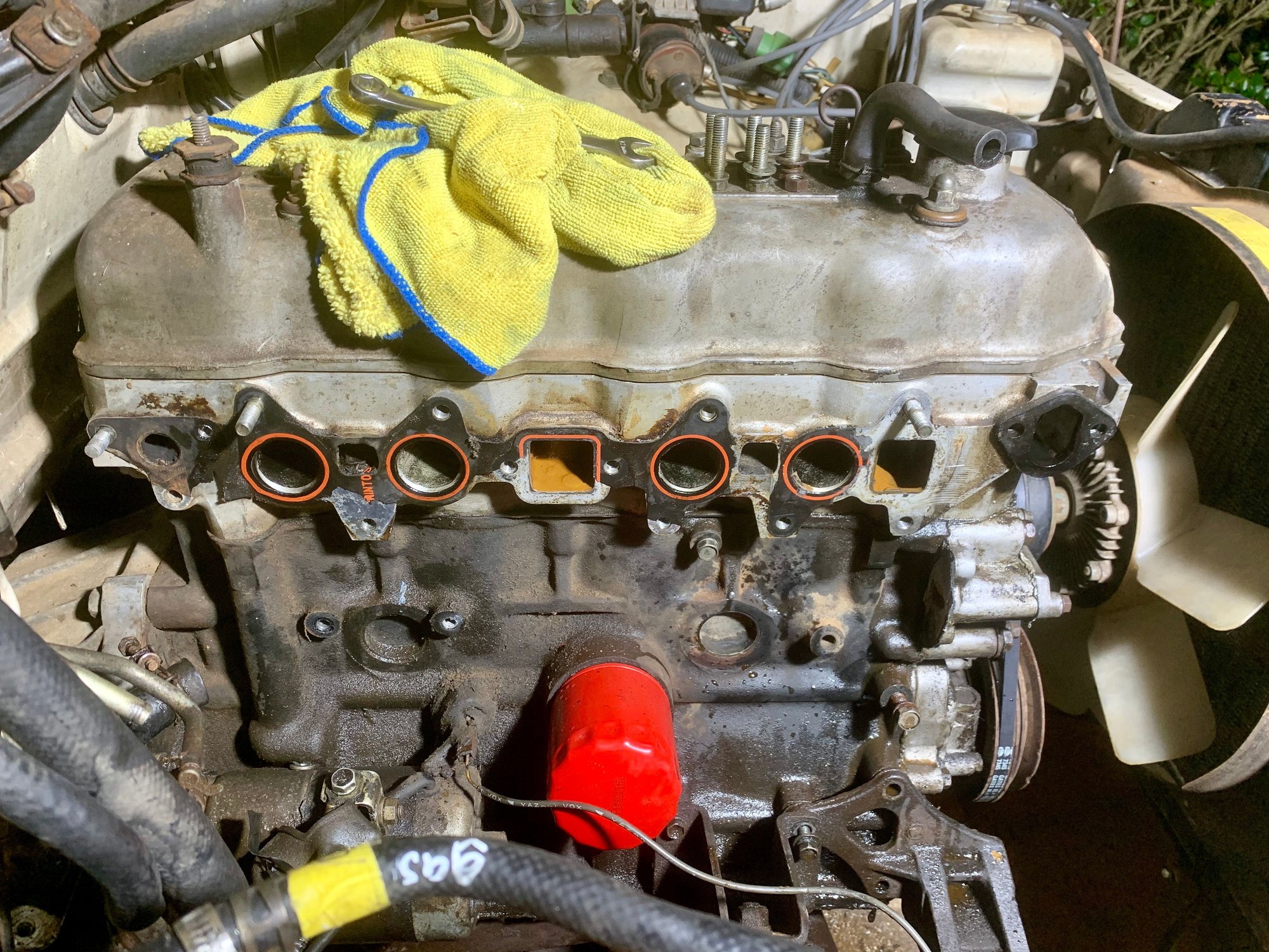

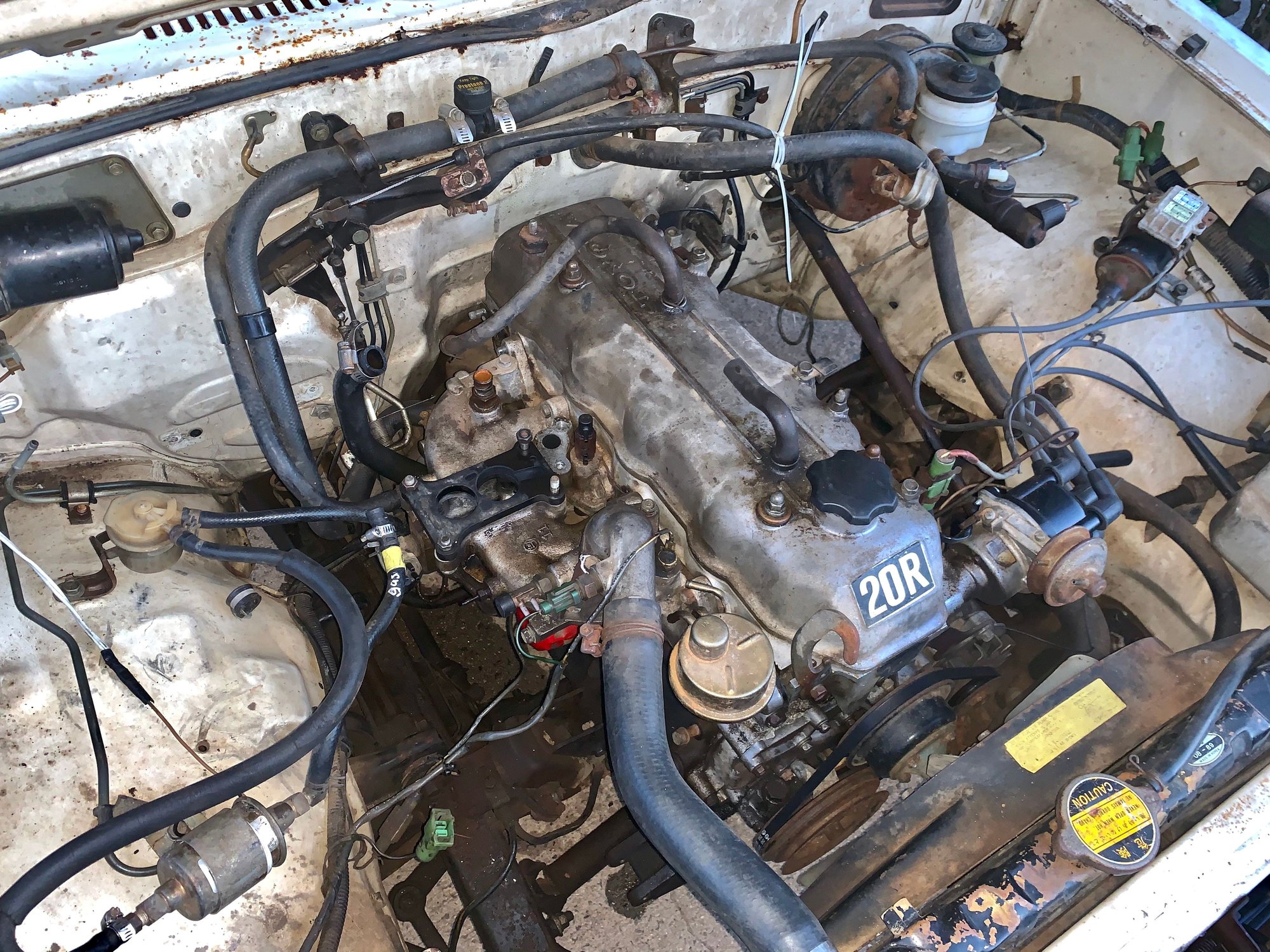

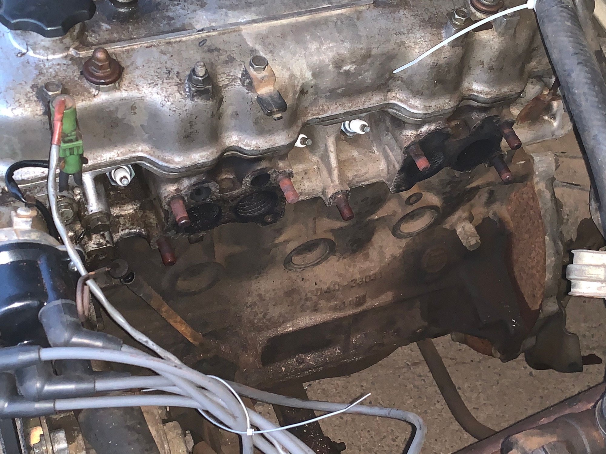

Got the intake manifold and the last of the smog stuff pulled off.

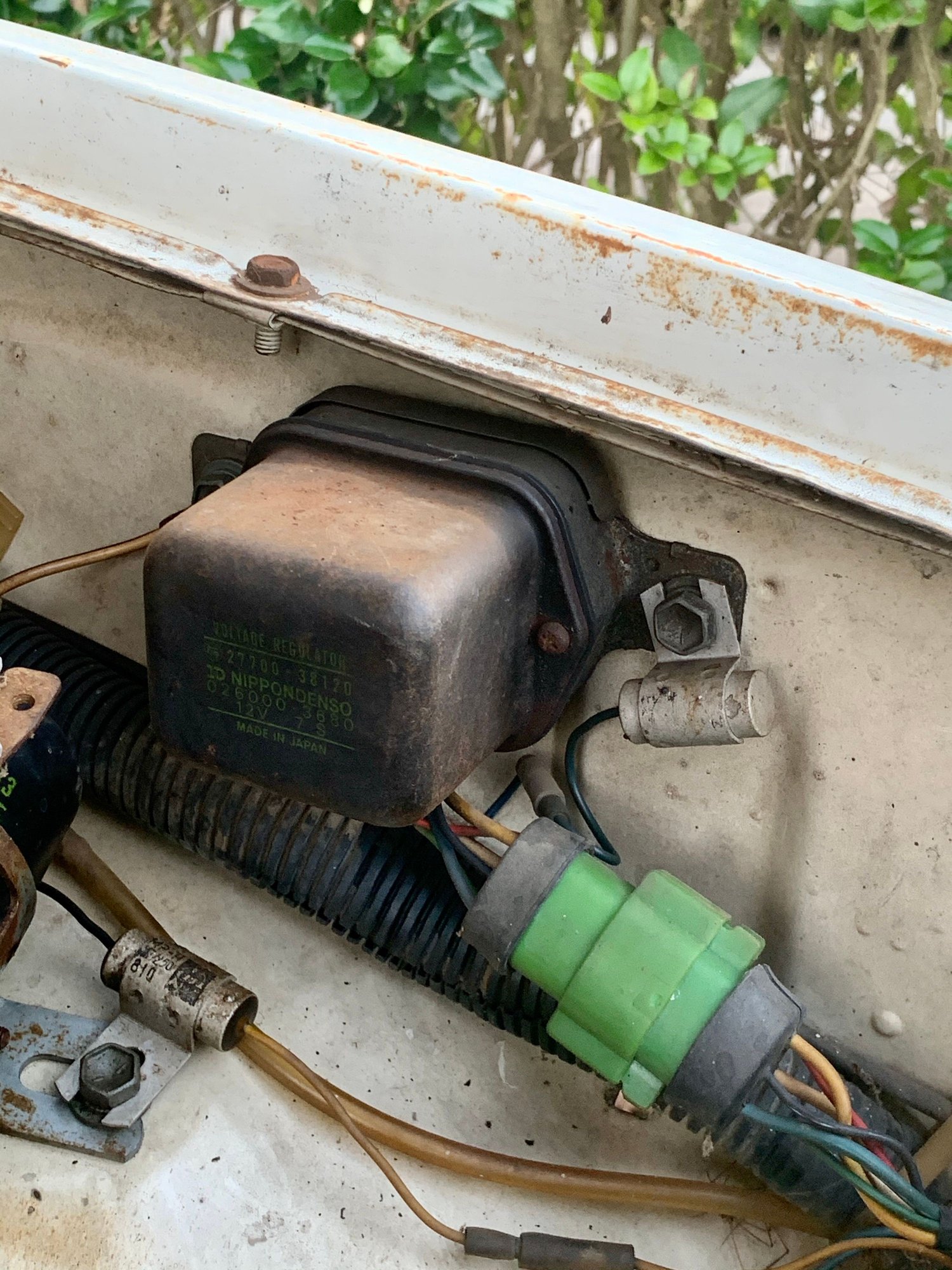

What is the electrical plug in the block to the left of the oil filter?

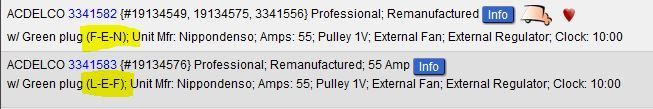

Probably going to install a new Alternator because why not.
What's the difference between these two? F-E-N vs L-E-F ??
Old Feb 13, 2020 | 09:48 PM
2ToyGuy's Avatar
Joined: Jul 2005
Posts: 2,345
Likes: 656
From: Chiloquin, OR
It's the plug to regulator's pin-out.
Take a look at this PDF: http://s7d9.scene7.com/is/content/Ge...any/1704040pdf
Go down to about the 8th page for the pin ID's. I can't read them exactly, but there seem to a large variety of pin-outs for the Nippondenso alternator. IE what pins are where,, and orientation they're in.
What you need to do is identify how the pins are placed where, and what direction the face, on the voltage regulator. Do you have an FSM, or Haynes manual? If so, there should be schematics in the back, so you can identify what pins you have coming out of the alternator, and then look at the old alt to see how they're oriented. Look at the PDF to see what plug matches the pins you have and how they're oriented. Then you know what plug pin-out you need to order.
Is all that about as clear as mud?
As to the little sensor down by the oil filter, I think, although rarely, that it's either the oil pressure sensor, if you have a gauge, or switch fro the idiot lit the comes on when the oil pressure is too low.
Does any of that help?

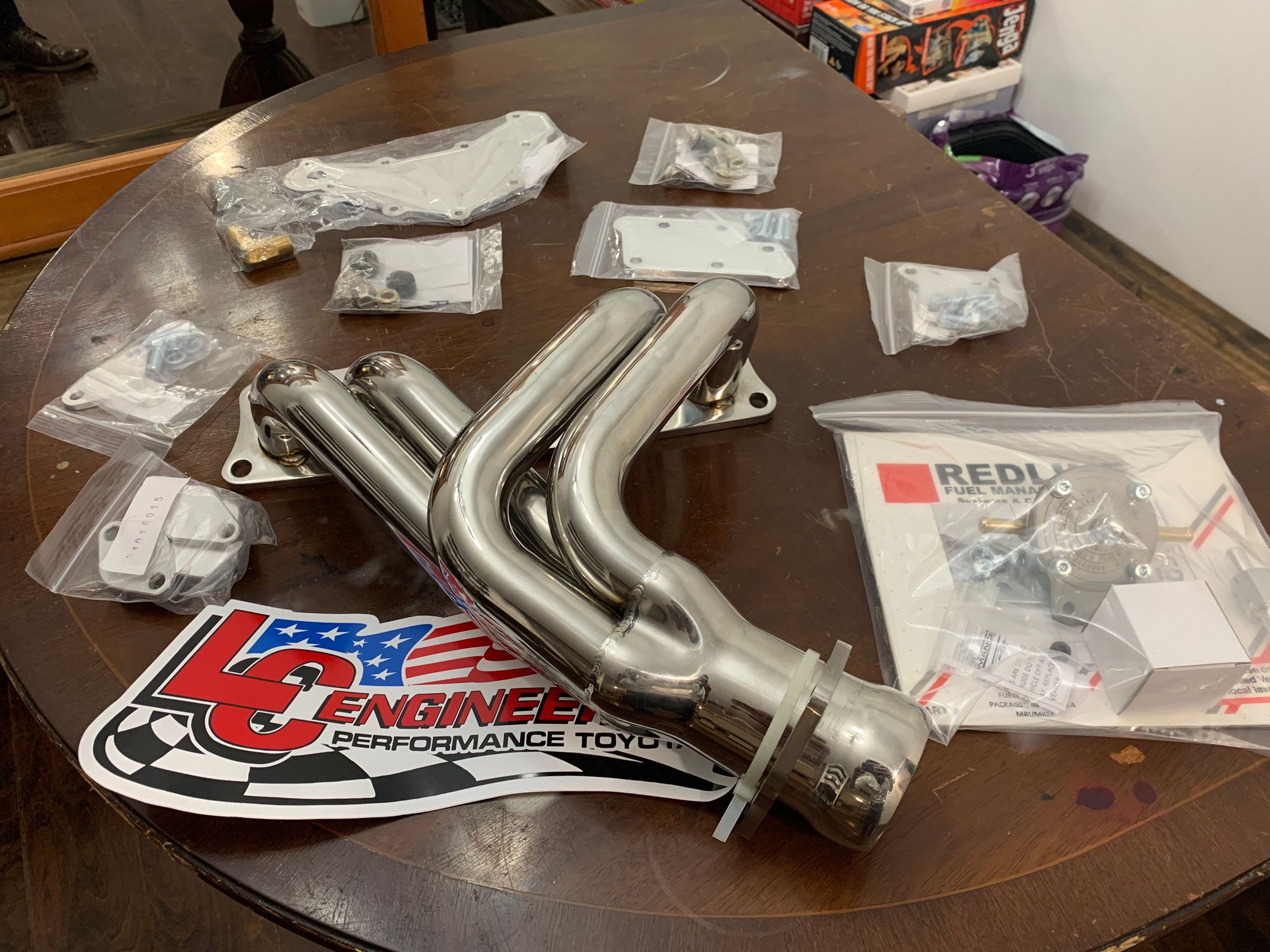

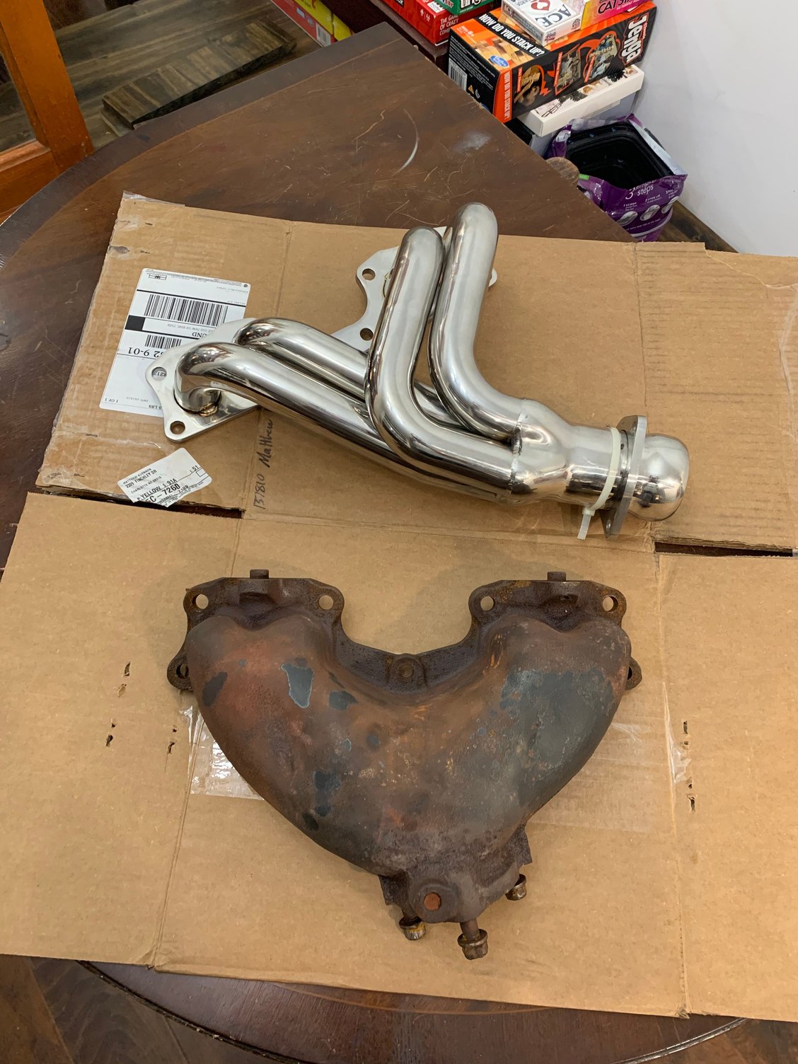

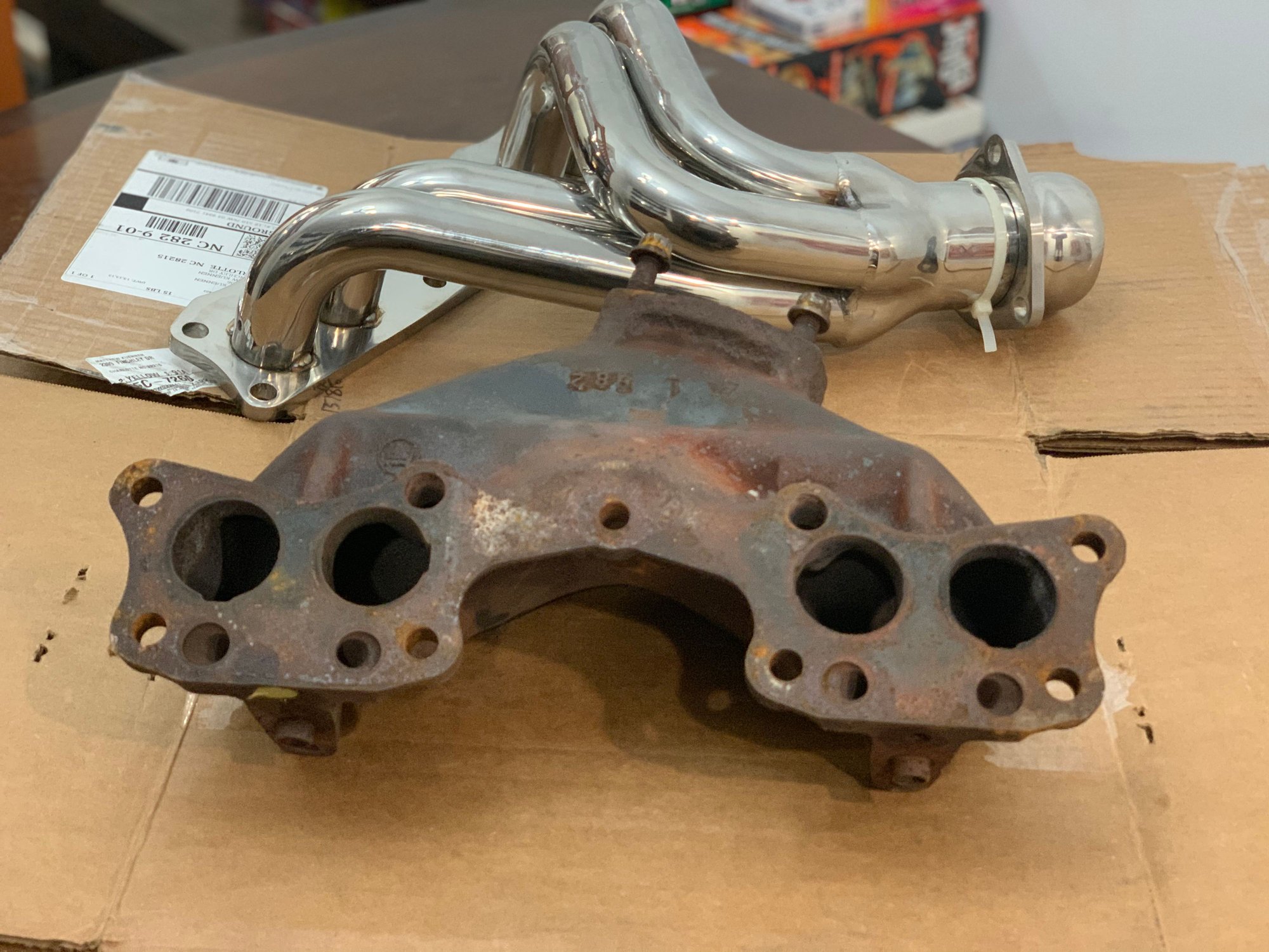

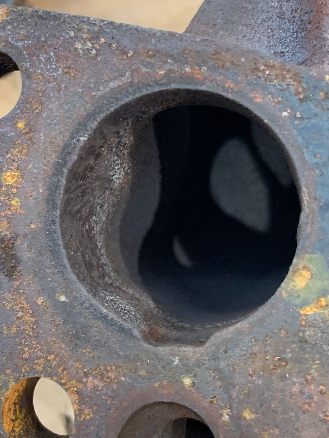

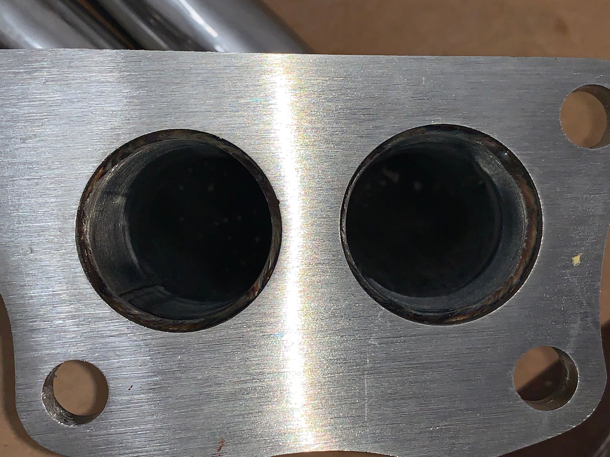

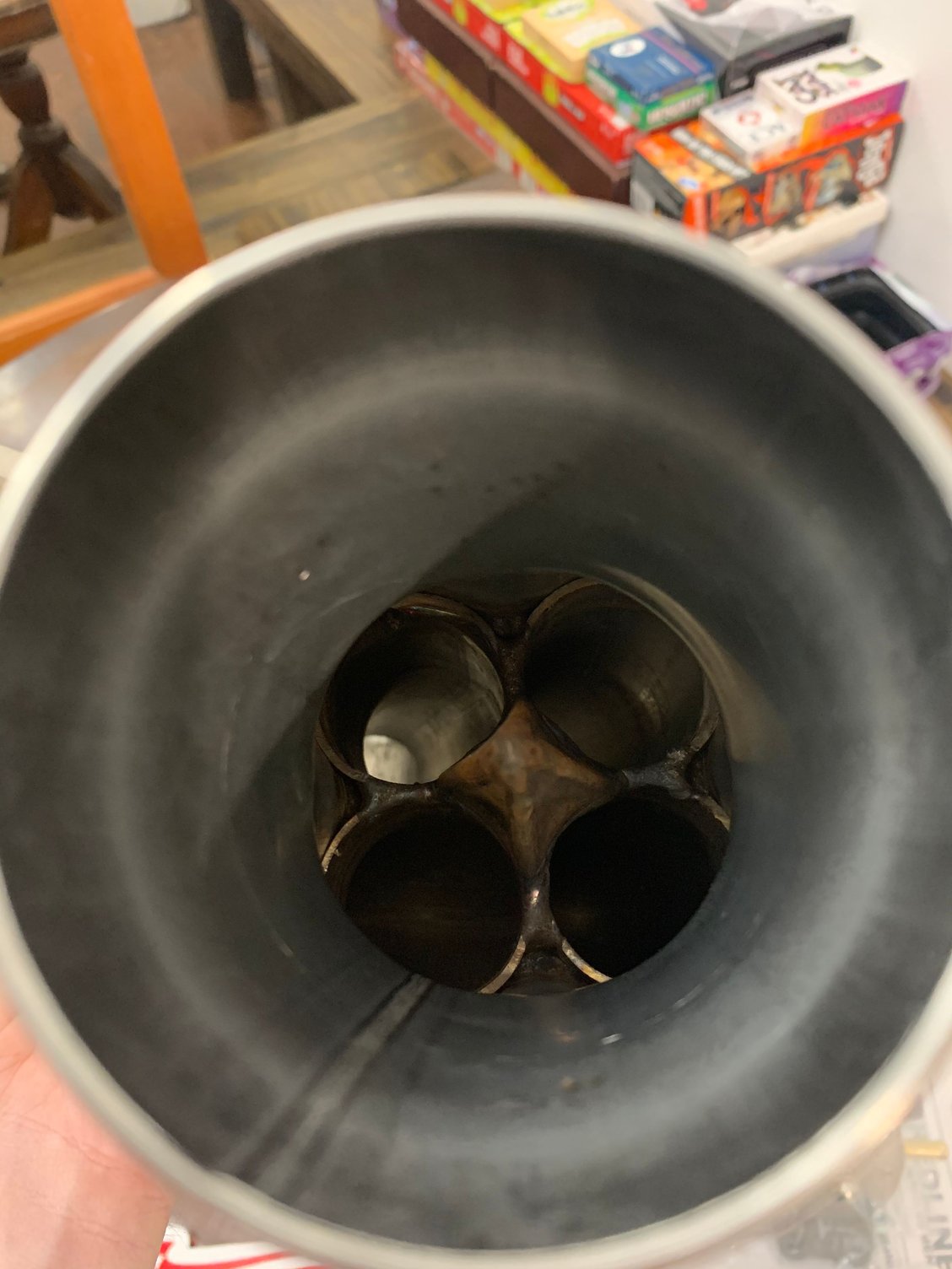

Goodies have arrived! The new SS header must weigh a third of the original cast iron.

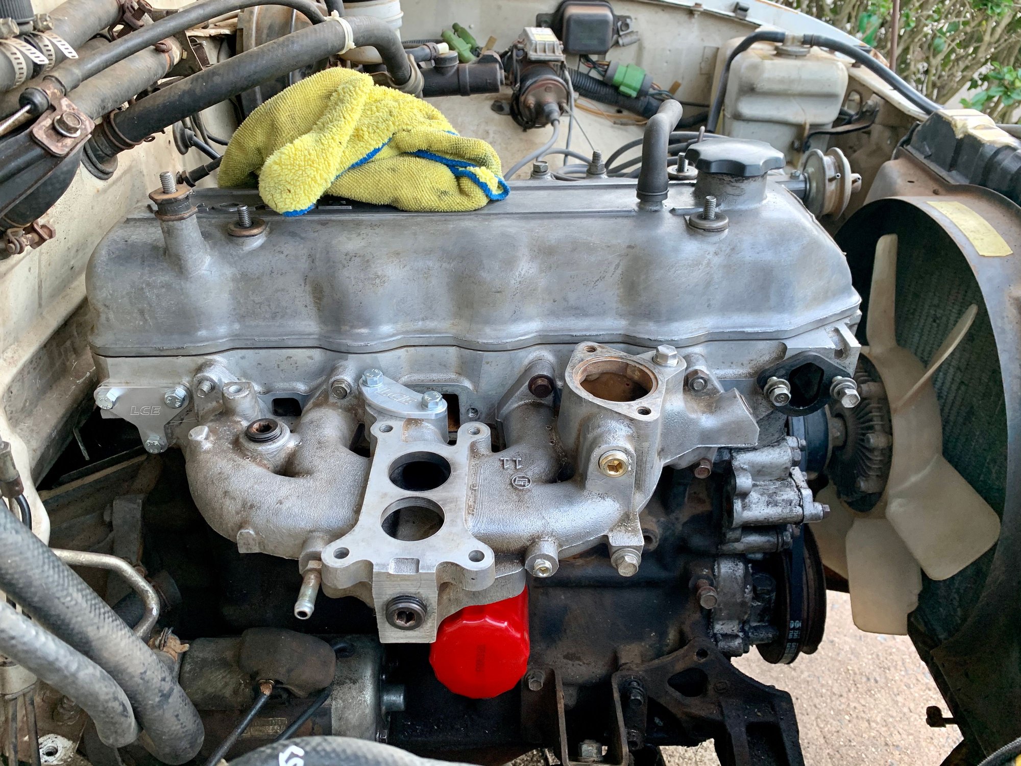

Hey thanks. No real progress yet but hopefully this weekend I can at least get the block and head cleaned up a bit and start to figure out where all the block off plates and plugs go. If I get far enough along I might put the manifolds back on.

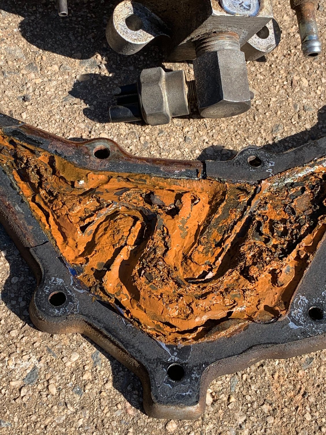

Wow...

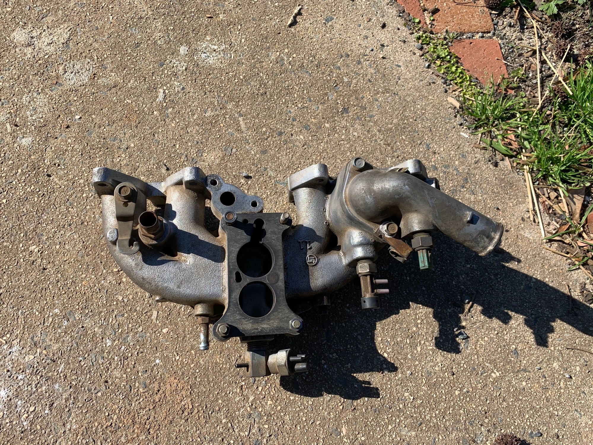

Old Mar 1, 2020 | 05:43 PM
melk's Avatar
Joined: Feb 2020
Posts: 71
Likes: 19

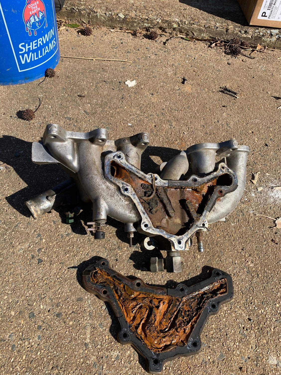

Well I did get the intake cleaned up and all plugs installed. The vacuum on the front left is for the brake booster and then the only other vac line needed will be from the distributor to the Weber. I do need to pull the manifold off to install the water block off plate in the middle of the head along with the gasket.
