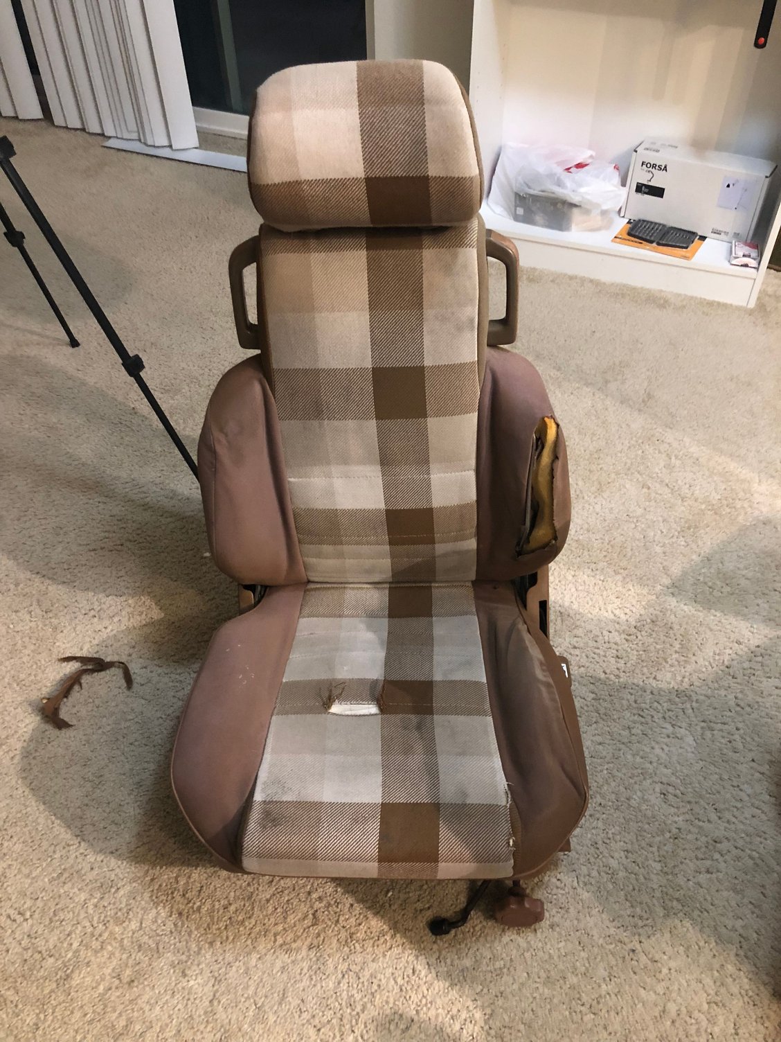

Now that the outside is done, it’s time to focus on the inside. Most of the interior is pretty good with the exception of a few tears in the driver seat and all the dark brown fabric has faded to a dull purple color up front. The rear is still fresh from having tinted windows all the way to the back so the sun couldn’t damage the fabric.
I got a can of SEM color coat fabric dye (15173 camel), masked off the brown parts and sprayed the seats
The passenger seat looks almost brand new if it wasent dirty. The paint is a perfect match and the fabric actually feels new. It’s a little stiff but I’d imagine in a few weeks with normal use it will soften up. I’m going to get some fabric and do a mediocre patch job on the drivers side and then spray that seat in the next few days. I am very impressed with that SEM spray. Even though it felt so wrong using spray paint on a car seat
Old Apr 23, 2019 | 06:16 PM
  #27
cars-guy's Avatar
Joined: Jul 2015
Posts: 95
Likes: 39
From: Los Angeles
Just finished up the driver seat. It’s seen quite a bit more use then the passenger seat because if you drive one of these cars you tend to not have friends
The side bolster is pretty torn up
Cut some to foam to somewhat match the other side.
Used and upholstery adhesive and simaler fabric as a patch
Got everything painted and it looks better then the gaping hole and exposed metal support. Unfortunately the paint ended up metling some of the adhesive forcing me to reglue it after it dried so now you can see some of the dried adhesive 🙃.
Pretty soon I’ll be cleaning my carpets in my apartment so I’ll get one of the hand attachments for the rug doctor thing and shampoo the seats which should help tie everything together better. While it’s not the best looking patch job it did improve the first glance look of the interior and I only spent about 12 bucks on the materials.

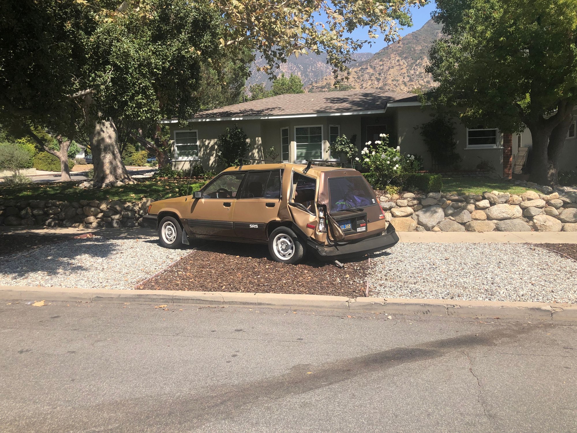

Tragic end
Sadly this will be the end to this build up thread and the end of the tercel. Sunday night while I was at work, a drunk driver slammed into the tercel that was parked in front of my house. The guy immediately fled the scene. The neighbors I bought the car from heard the impact and tracked the trail of coolant from his car back to his house just a block away and called the police. He was arrested for a DUI and hit and run. Thank god for them and thank god no one was injured except Dan (the tercel). Police estimate he was going about 50 MPH in a 25 MPH residential street.

It was by a 2018 Land Rover discovery that hardly had any damage too it. It was a glancing blow that transferred all the energy of the impact into the tercel. His insurance wants to give me 800 bucks to total out that car. I’m taking him to court.

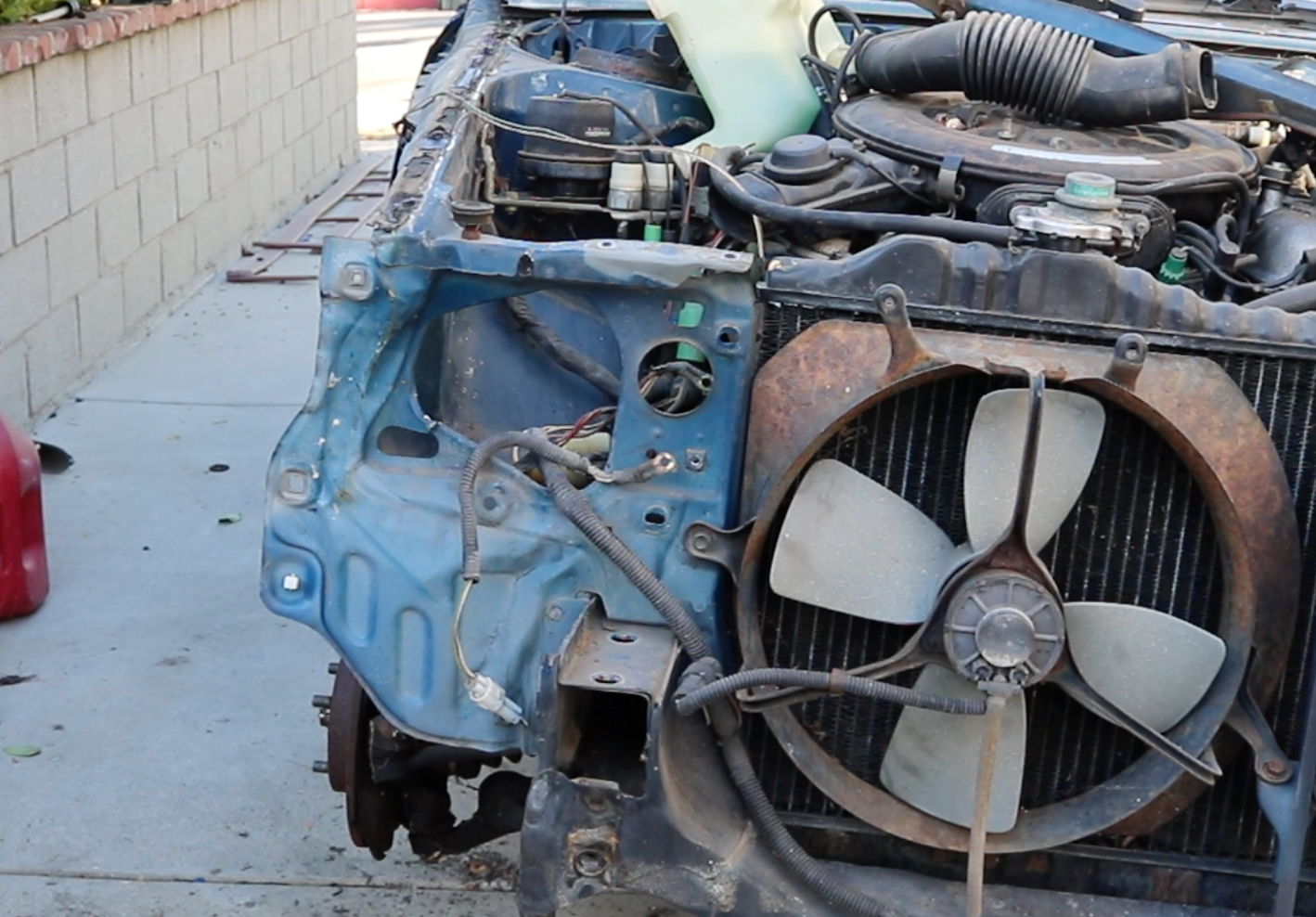

Ok, I just started on swapping the body parts over today and I think I'm done actually. I had to get creative with an engine hoist and a hammer to unbend the sheet metal behind the head light. It doesn't look perfect but all the mounting point are where they need to be and panel gap is acceptable. Next step from here will be paint.
Heres what I'm starting with, underneath is what it should look like.
Its mostly bent out. Doesn't look great but everything lines up and fits like it should.
Done!
Again its not perfect and needs a little more messaging but everything is in the ball park. Next step is body work and paint!
