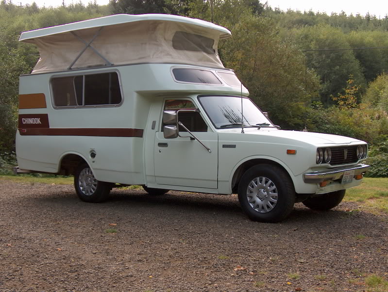

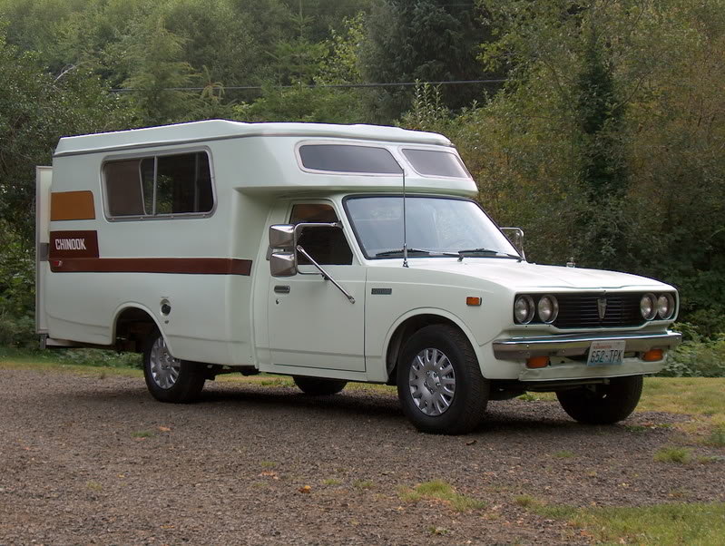

I've always wanted a Chinook, but everything I've seen was either too expensive, or too far gone for what I wanted to tackle. When I picked this up I wasn't actively looking for one, or wanted to take on yet another project, but I couldn't pass it up.
Here she is when I brought her home.

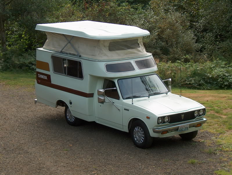

The top works great, and doesn't appear to have any leaks that I can see.

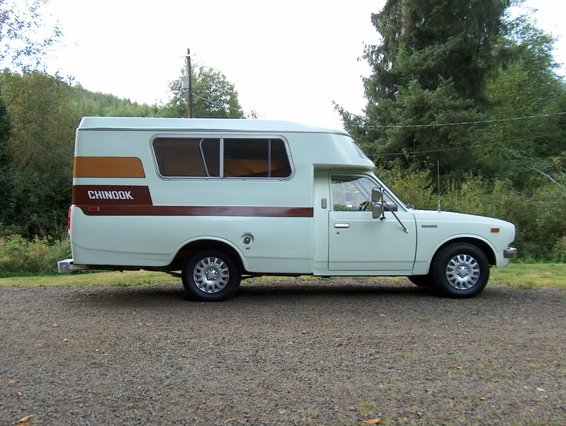

New ties, and hubcaps.
Overall she is pretty clean on the outside. The previous owner has painted over the cab to match the camper. It's a poor paint job, but I won't bother with it until I've got everything sorted out.

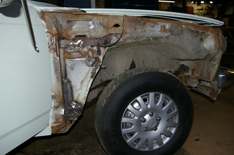

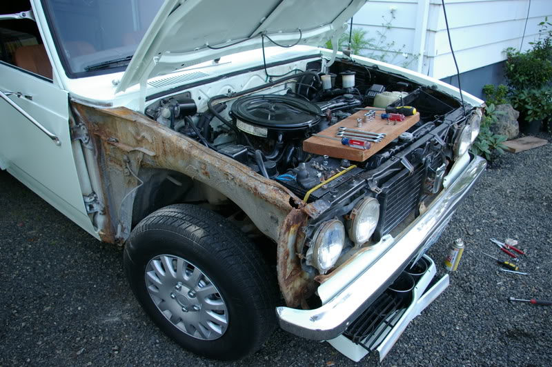

Knowing that the camper had been in the PNW most of it's life, and spent some time in Alaska, I knew there would be some rust I may need to deal with.
I started by removing one of the fenders to get a better look at the overall condition of the cab. Initally all I found were a few managable areas of surface rust. I plan to sand these areas down and apply POR15 for better protection.

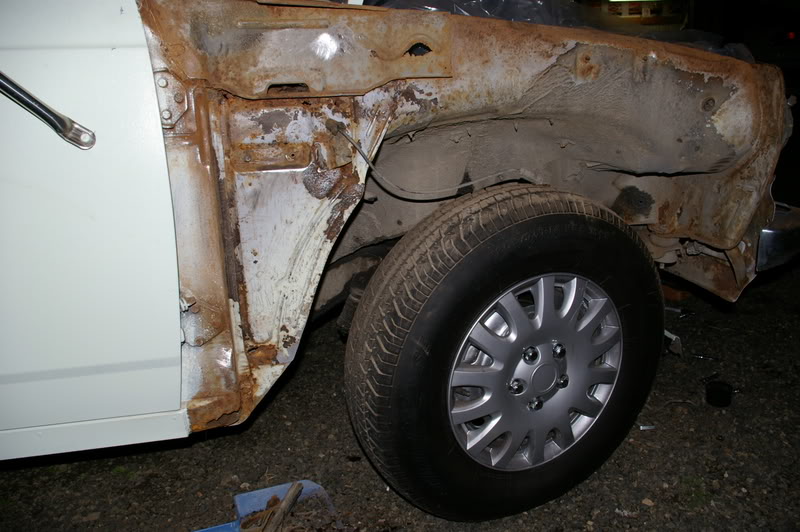

After hitting it with a wire brush, I did find some areas that needed to be repaired.

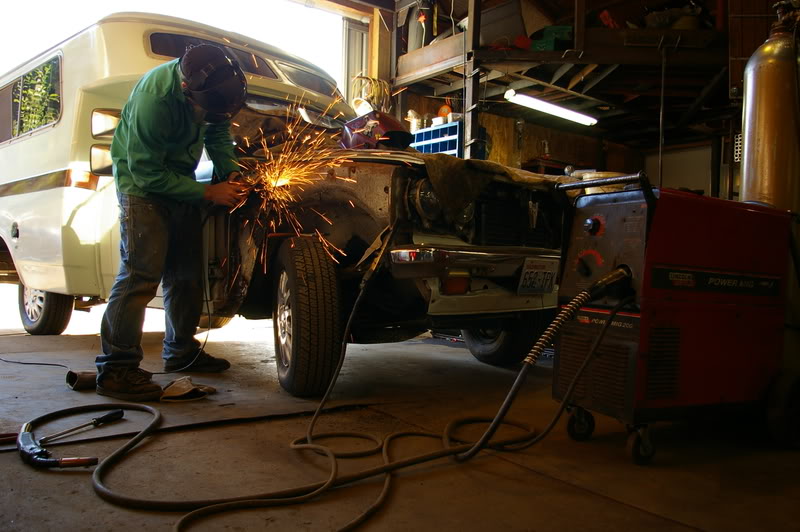

After cleaning the area the best I could with a wire brush, I then cut out the rusted areas and prepped it for repair.
I've never repaired rust, or worked on a vehicle of this age, so this will be a learning experience for me.
A few hours later I had cut out the worst areas, and patched them with new metal. There was still a little more to go when I took this photo, but it all worked out. I wonder what else I will find that needs to be repaired.
I'm debating on applying POR15 on the entire wheel well area. Anyone have any idea how well POR15 will holdup to the constant abuse in this area?

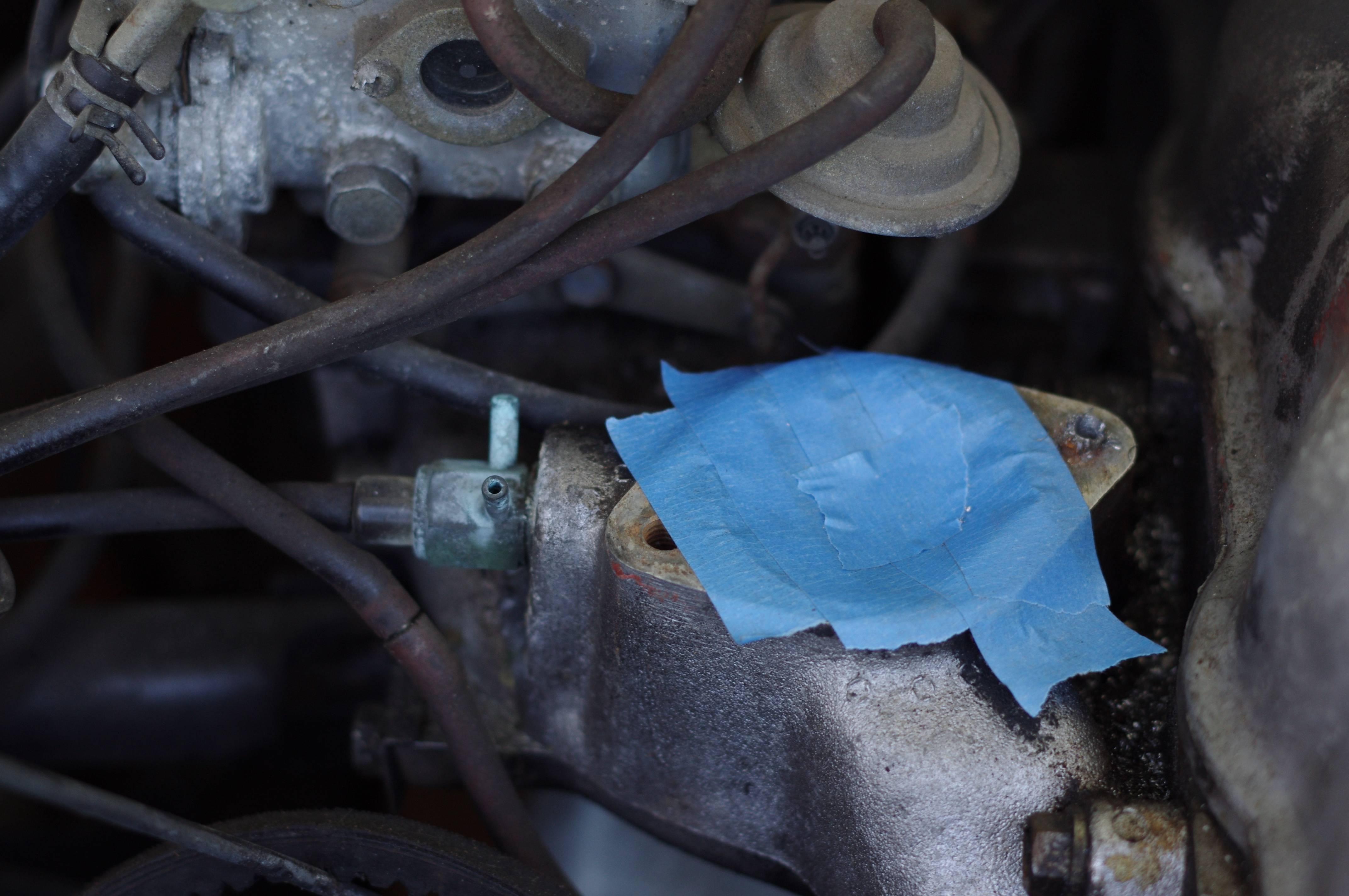

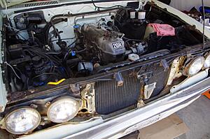

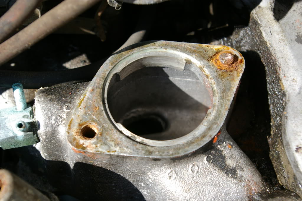

The engine starts and runs great but I was concerned that it might be running a little hot. The engine temp gauge didn't work, so I started looking around to see what I could find. First up was to check the thermostat. In the process I ended up snapping one of the bolts.
The thermostat was missing, and I snapped a bolt trying to get the housing off. I've tried vice grips, heat, PB Blaster. The more I tried, the last material I had to work with.
Unfortunately, at this point I stopped working on this project for over two years. Thankfully with the top down she fits perfectly in the garage. We moved to a new house, and had a larger garage built. I recently moved her from the back of the garage to an area where I can continue working again.
Finally back to working on her again!!
So this past weekend I tired to get that broken bolt out. A few of you recommended I try using as easy-out. I drilled down, and tried to extract it, but it wouldn't budge. Using a more powerful drill didn't seem to help at all.
At this point I'm thinking about removing the intake manifold and trying to remove it while it's off the engine. Otherwise I may need to find a replacement in a junkyard or something.

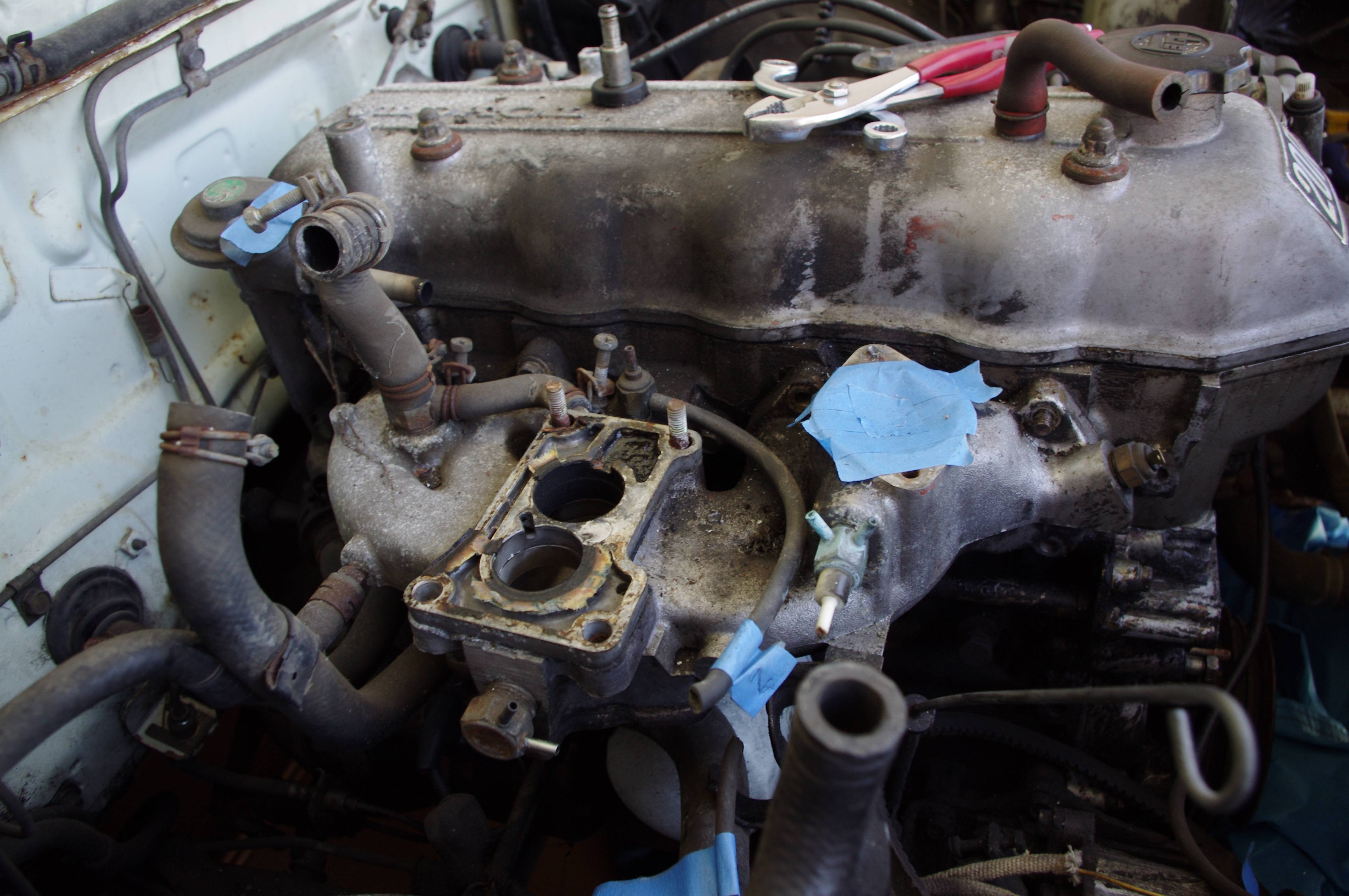

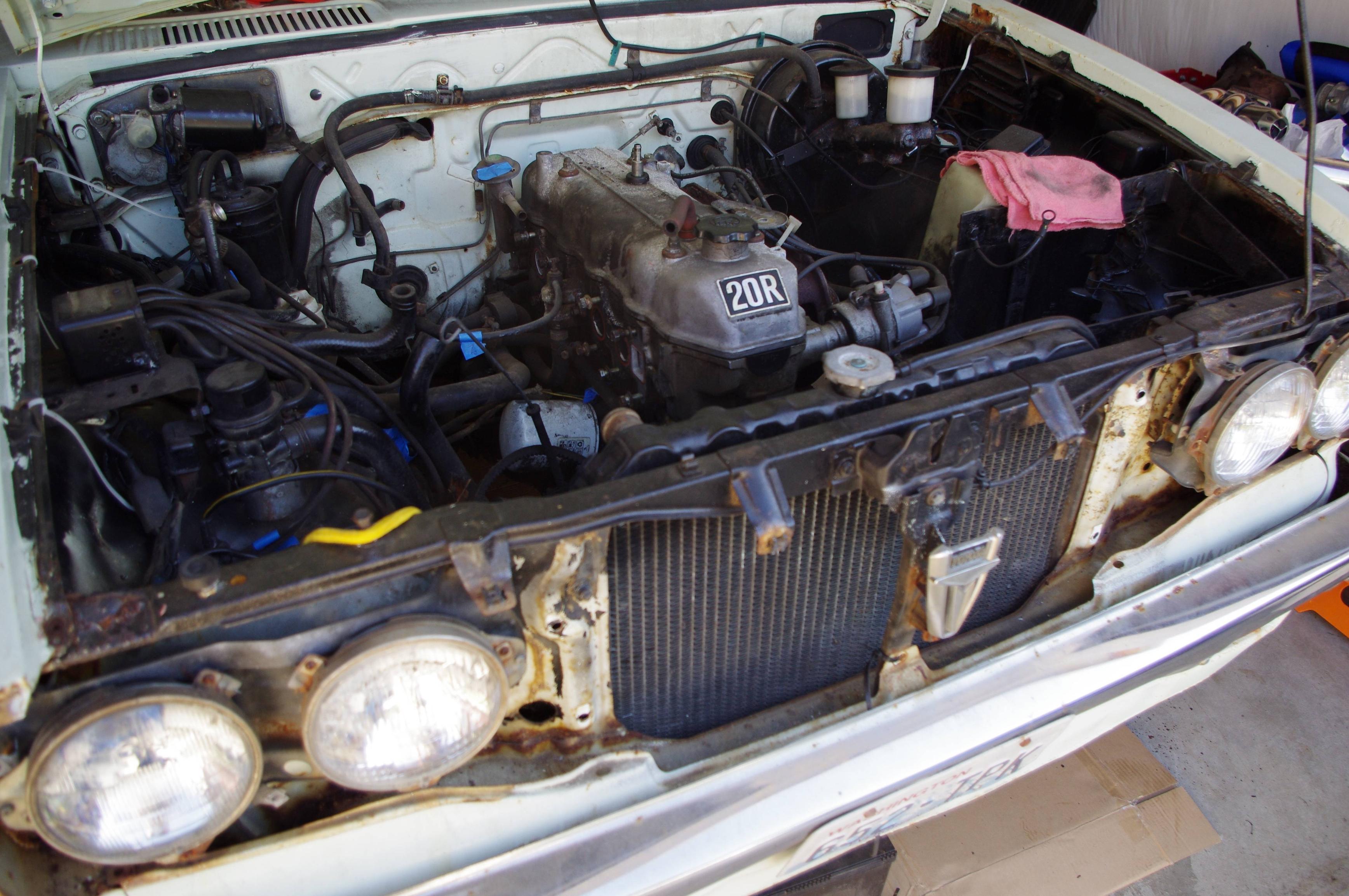

I decided to just remove the intake manifold. This way I'm able to clean up a few things, and remove anything that isn't necessary.
Carb off:
...and she's off. it will definitely be easier to work with now that it is off the engine. I'll also clean it up. Looks like the engine could use a little cleaning as well.

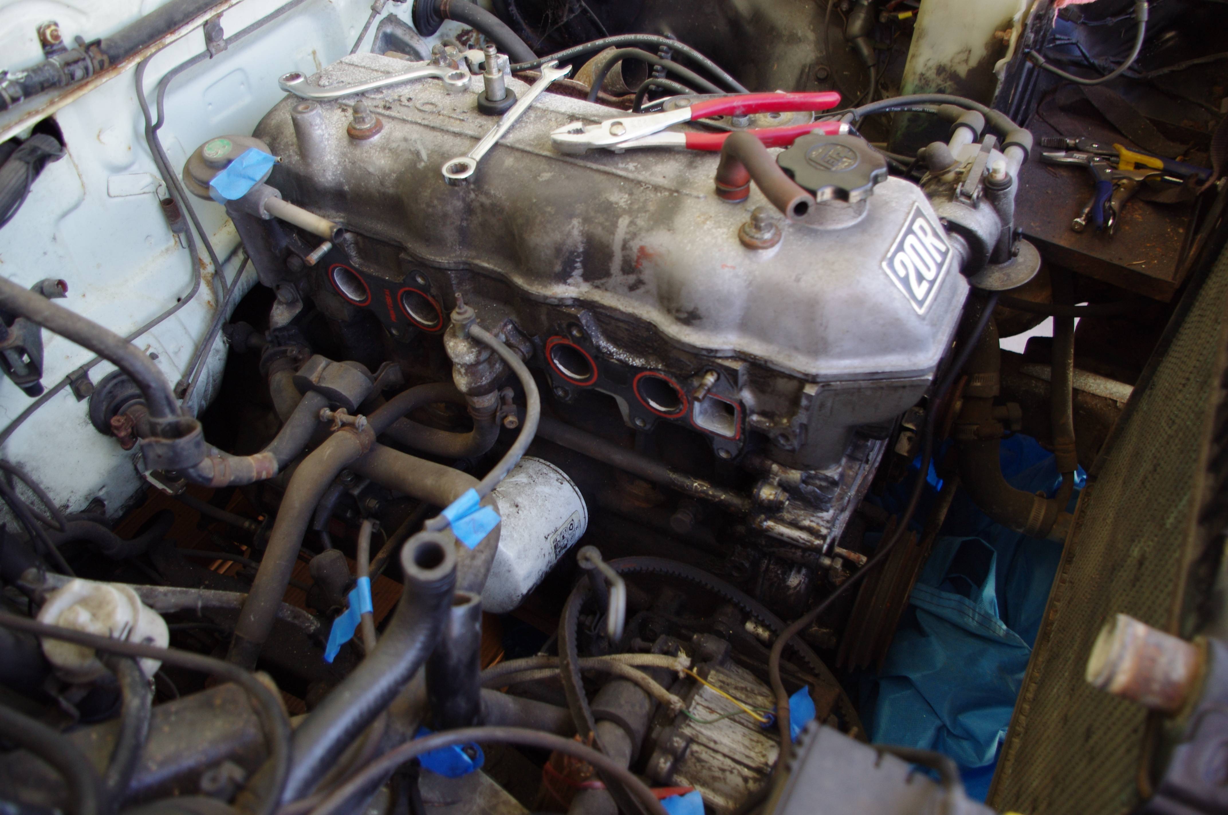

When I bought this the A/C didn't work. Might just need a recharge, but I doubt I will ever use it. I'd rather have the extra space, and a few extra HP, so I've started removing it. What is the best way to cap the lines that run into the firewall? Or should they be removed entirely?
As you can see I've done my best in labeling everything to make it easier to reinstall. Eventually I'd like to remove as much of the emission system as I can. I may even go as far as desmogging the engine. This guide seems very similar to the 20r: De-Smogging an early 22R

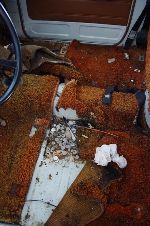

Now that it's starting to warm up I've been working on the Chinook a little more. I had decided that before I spend anymore money on the engine I need to determine how bad the condition of the cab really is. I can tell there will be rust issues but I needed to strip the interior to really see what I'm up against.
To my surprised I started the day making over $10 in spare change that the previous owner had left behind.
