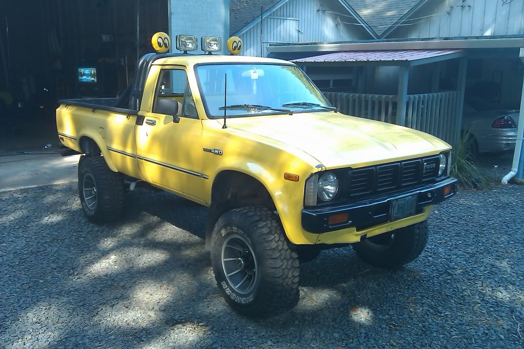

I bought this truck early this month and have been doing quite a bit of work to it so far and haven't taken very many pictures along the way but i'll try to get better at that. Anyway it's a 1980 Toyota pickup that a kid from my high school had and graduated a few years ago, and i've seen it around before when I had my 79, it wasn't running good at all, was running on 3 cylinders and didn't know that the right front wheel hadn't been tightened until I went through a round about and the truck felt like it was going to roll haha luckily the tire iron in my dad's sidekick worked at managed to tighten it up to get it home. I'll post some more recent pictures and some of the stuff i've done to it soon but for now here is some pics from when I first got it out of the field.

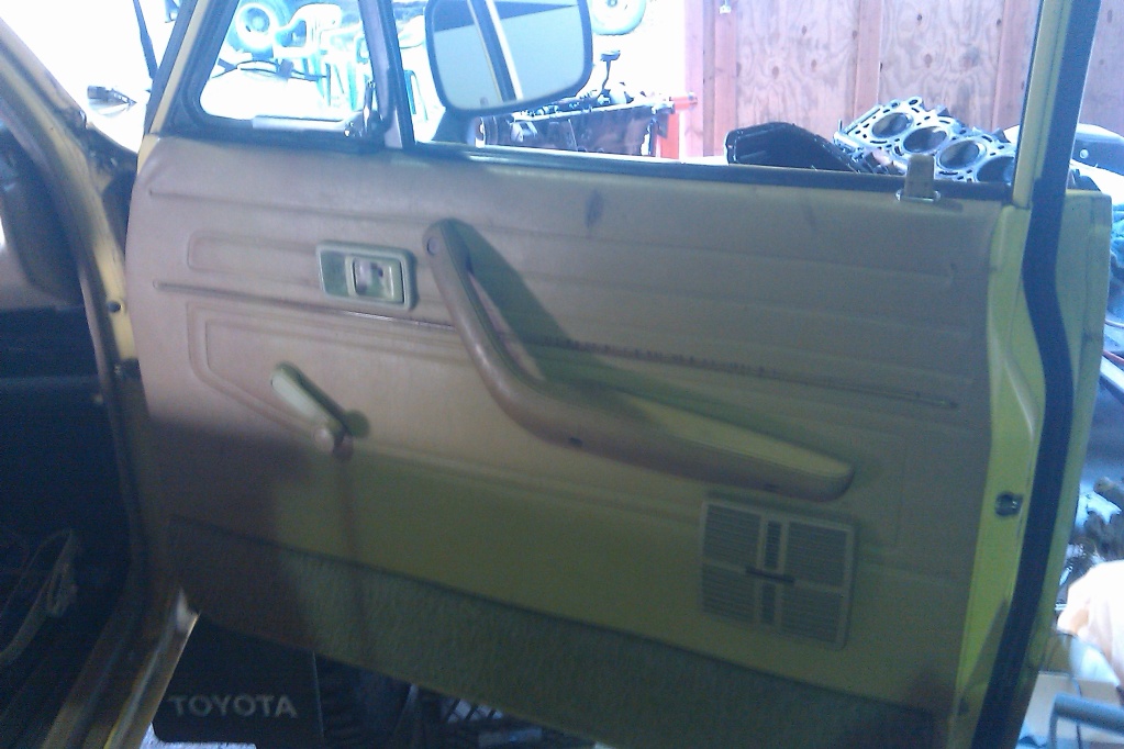

Hey thanks guys! I took some more pics today, sorry about the crappy quality its in our shop and not well lit for pics, the interior is just about the best that i've ever seen in a first gen, the previous owner has obviously re-upholstered the seat, the carpet was kinda nasty so I pulled it out I WAS AMAZED there was no rust at all!!! Not even surface rust! My old 79 had a giant hole under the driver side carpet but these floor boards were immaculate! So I bought some Duplicolor bed line paint and painted the floors for future protection. I also put on my old school wheels that were on my 79 and the 31/10.5/15 Maxxis Bighorns that were on them. Here are the pics.

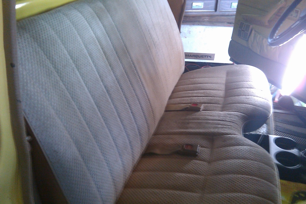

Here is my near perfect seat

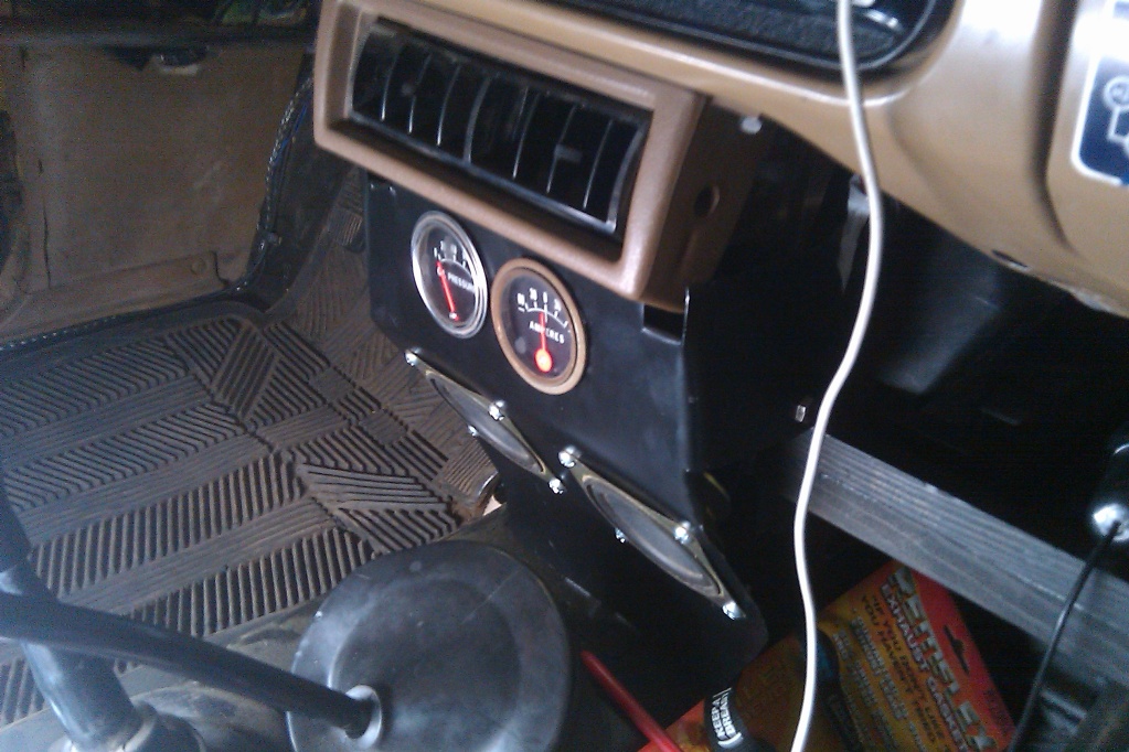

My truck was missing the sr5 gauges so I made my own console to hold a couple gauges and some speakers.

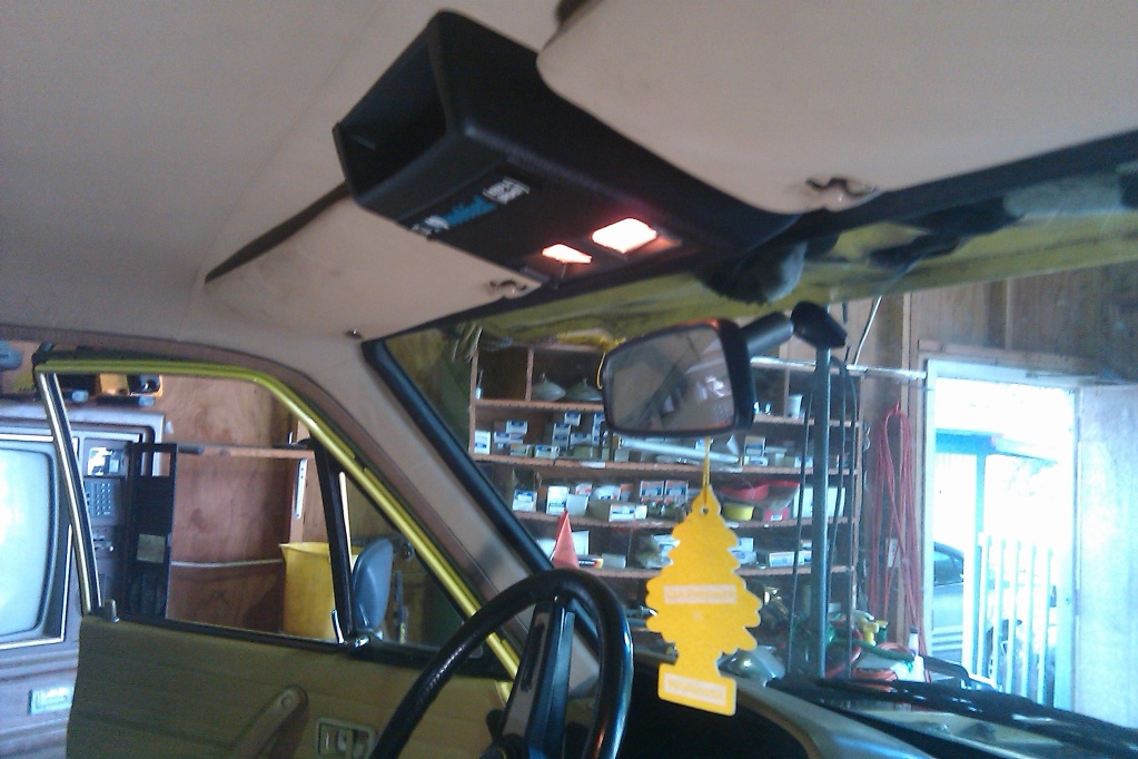

Also my dome light and rear view mirror were toast so I got a over head console from a 90's Pontiac mini van (don't know what model) but one of the really ugly ones, my first idea was to get one out of a mid to late 90's explorer with the temp and direction of travel but the ohc in the explorers at the local yard were all gone

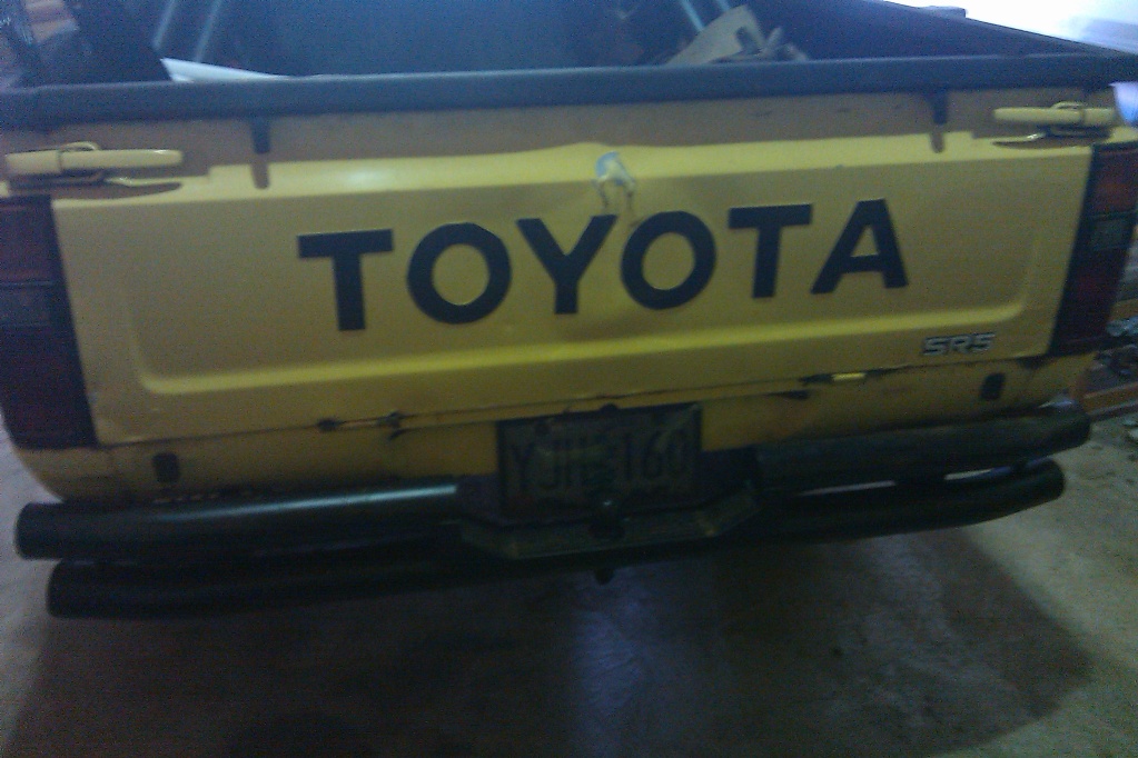

I put the rear bumper off of my 87 because the old one was toast

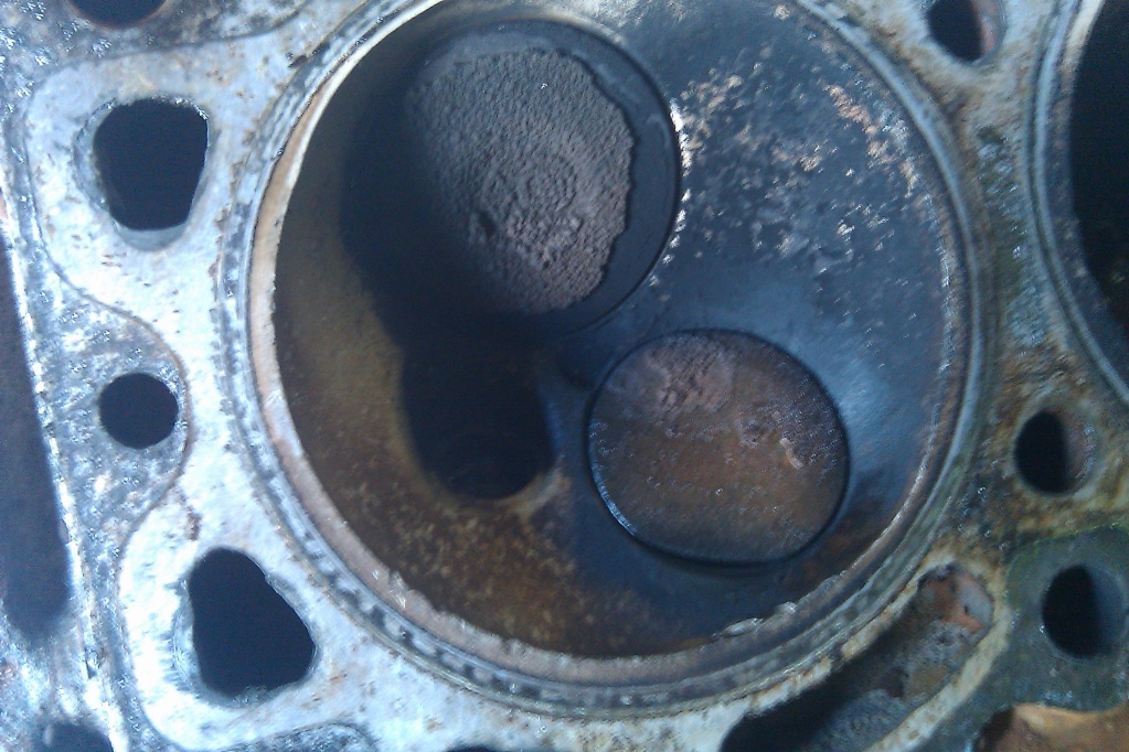

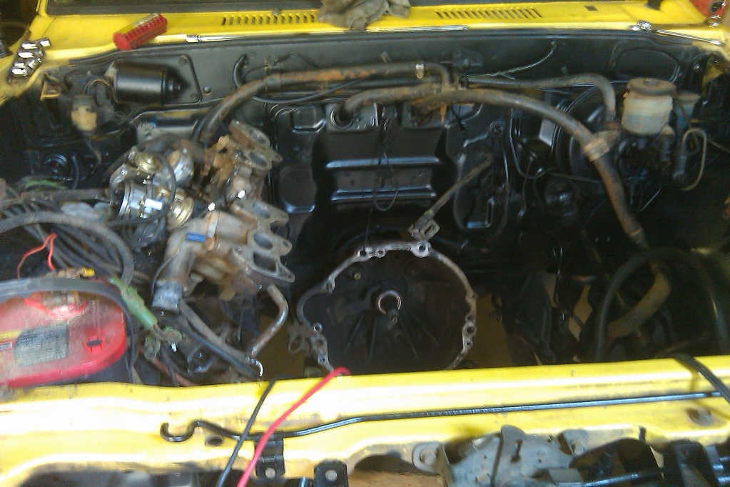

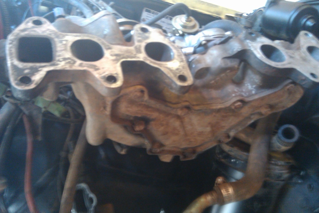

So moving on with the truck I pulled the engine because it was only running on 3 cyl I knew it had a pace setter header on it, but when I was taking the intake manifold of I saw some raised lettering on it that wasn't Toyota brand stuff, so I got the drop lite closer and turns out it has an Edelbrock intake on it. The previous owner(s) have put some good money in this thing. Has warn premium hubs on it, pro comp lift, etc. So all in all the money I payed for the trucks I have already found in just aftermarket stuff alone. Not to bad if I say so my self Anyway got the motor on the engine stand and took the head off, turns out it has a burnt valve. So I have found a local place with completely re done heads for $200 with a $100 core fee. So when I get some money, or if my parents pay for the re build for my graduation (like I asked) I think this is the route i'll go. The bottom end seems just fine, no smoke or anything when I drove it home. So here is the engine and head as they lay.
My burnt valve Cyl #4 had only 50 psi of compression

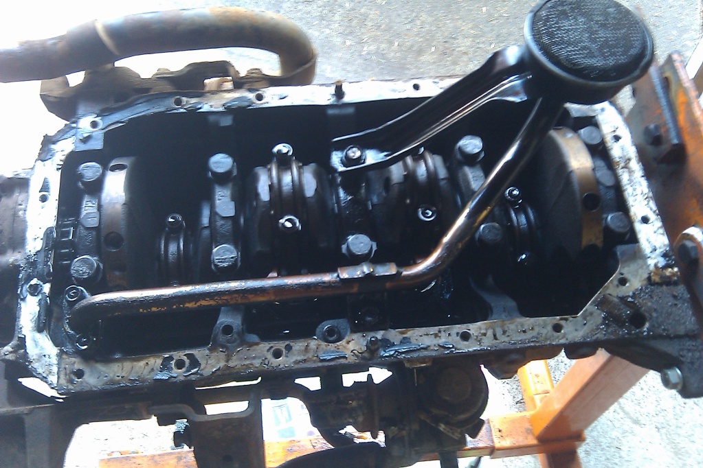

Bottom of the block with the oil pan off. I'll get pics of the top soon
All of the other cyls had 155-165 Psi Whoever had the oil pan off last didn't even get an oil pan gasket.... just globed a bunch of gasket maker on it and called it good (needless to say it leaked...)

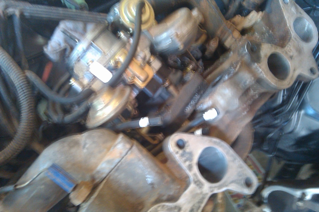

pics of the Edelbrock intake
Old May 25, 2012 | 10:16 PM
17toyotaman's Avatar
Joined: Dec 2011
Posts: 150
From: NW Oregon

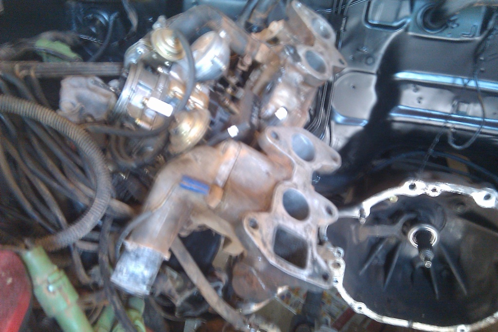

Well as requested I got some more pics of the intake, sorry they're not the best, the carb. is still on it and not out of the engine bay all connected.

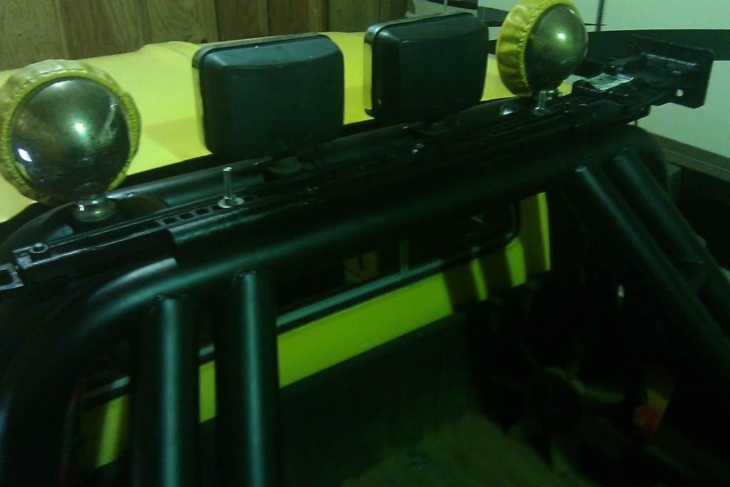

If you want pics of something particular just let me know. Also got the Hi-Lift jack thats been sitting in the shop for as long as I can remember, the last rig it was on was my dads old scout back in the 80's

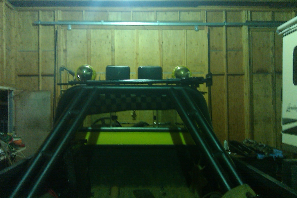

I love the roll bar to, but with 3 bars and 2 down tubes per side I can tell it'll be a pain to see out of, beauty before practicality I guess.

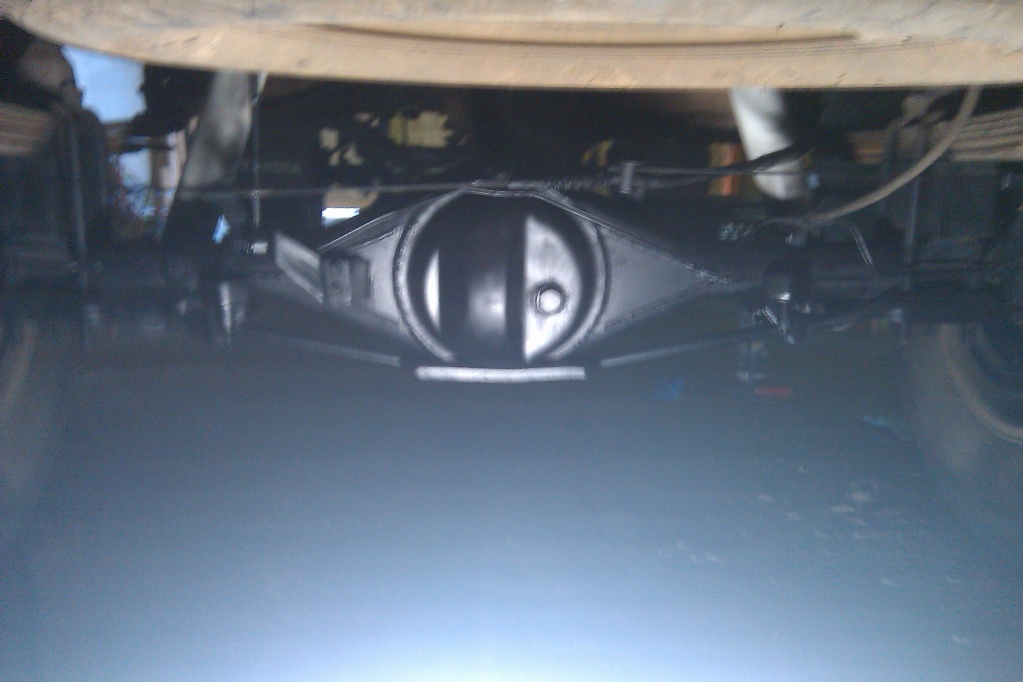

Hey thanks for all the compliments, didn't take any pics today but got some new poly bushings in the rear, and also extended the vent for the rear differential done and will put up some pics tomorrow, when I was putting in the bushings I had the rear end at full drop and the stock break line was stretching a lot, the PO didn't put in extended break lines when they put the lift kit in, so I will be addressing this before I take this thing wheeling.
