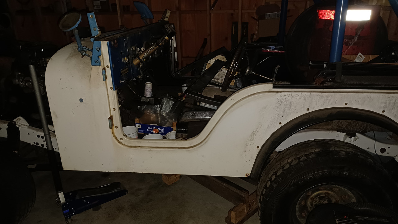

more progress
resting in place
sits a bit high
will need to adjust the mounting holes - the old frame was more bent/twisted, so the mounting locations on this excellent frame do not match the holes in the body. fortunately, fiberglass is easy to drill, and repair/fill.

got back to working on the cj5. raised the transfer case crossmember about an inch - needed to do it so that the engine wasn't tilting back and hitting the firewall. i then decided that i didn't like how high it was (the new springs had a 4" lift), so i took out two leaves per pack, and got it sitting almost the way it was 9 years ago. now it has about a 2.5" lift from the springs, and the shackle angles are better.
moved the body around on the frame to line up with the mounting points, and was able to get all the old holes to align enough with the frame that i can use them. the body is now attached firmly to the frame.
pulled the steering column. needed to replace the lower bushing at the end of the column. pulled the steering wheel/shaft to do that. should have that reinstalled next time i work on it.
