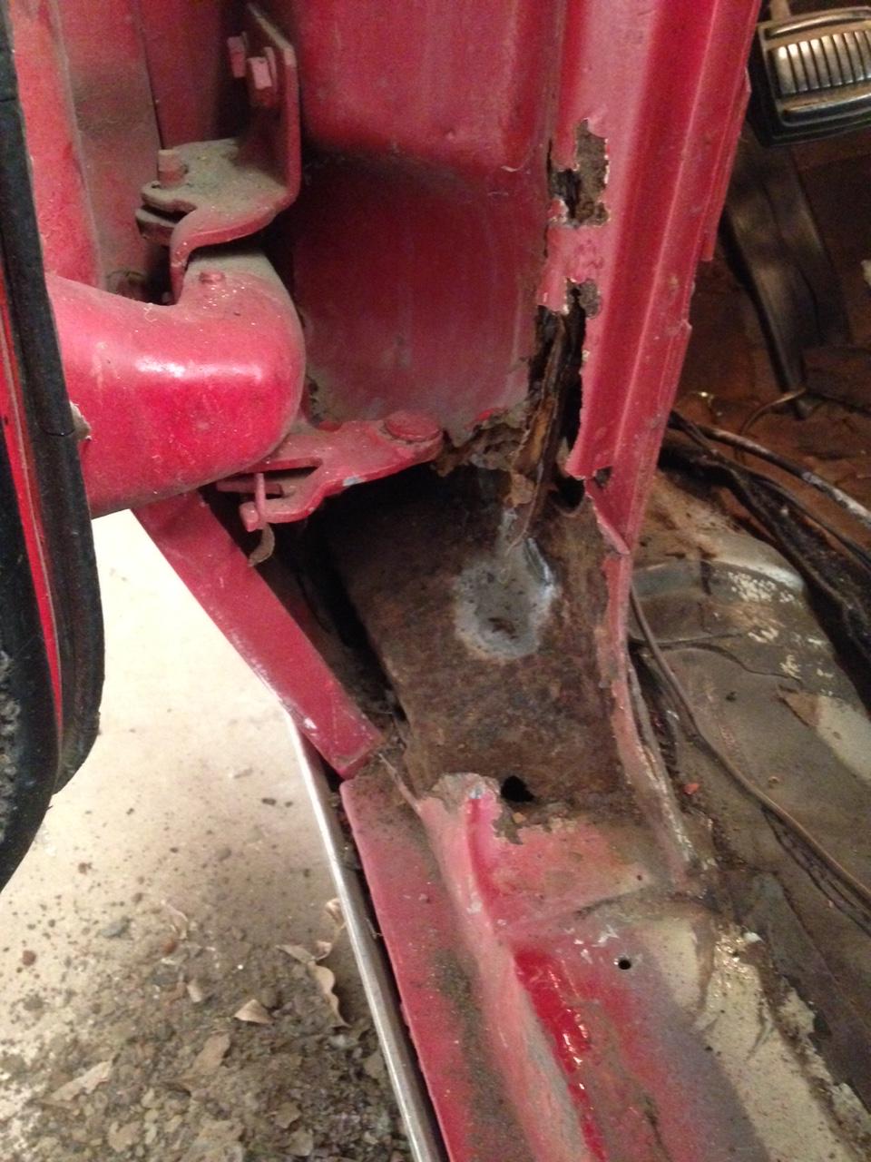

Yes thanks for the tip! I was definitely planning to tack in some bracing before even considering taking off the body. First I have to tackle the bottom of the A-pillars, they're pretty much gone, I can stick my hand inside. I called the few salvage yards in the US with a 67/68, 88 or 98 Olds in their lot, that have enough taken off it to even consider robbing the pillars too -- the cheapest was $700 for just the cut-out parts and they're in another state! For that much I could buy another parts car, the bigger air compressor I'll eventually need, fab tools and/or lots of materials to complete the project I'm planning to mock up a cardstock template based on the parts car and hand fabricate it, it will also get sleeved inside the top of the pillar and into the rocker with a few rosette welds for strength - think that will work?
Sounds like a plan. I know right where your talking about the issue. This 73 has it near the dash on the passenger side.

Good to hear you think it might work. Thery're pretty bad, I can stick my hand in there!

You've got your work cut out for you. Did you try Desert Valley Auto Parts? And have you pulled the front fenders off to see how far the rust goes into the firewall. You may be able to get the firewall and what you need at a reasonable price from them. Send me the link for your build. I'd like to check it out.
I was only at my shop a few hours today. I'm working on getting the body bushings out to order a new set. Hope to make a lot of progress this weekend.

Yes DVAP is one of the few yards with one in their inventory. They're the ones who wanted $700 for those two pillars cut out. I never asked about the entire firewall. I have not yet pulled any parts from this car, crossing my fingers it hasn't spread very far
