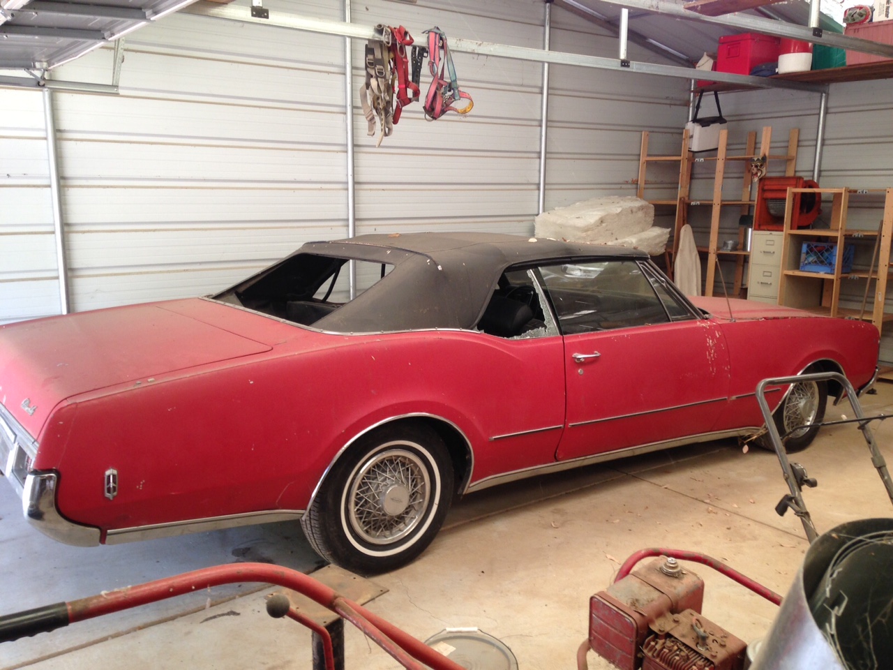

One owner all original equipment but was restored back in the 90's
Car looks fairly straight and the body work held up descent but you'll see, there is over a half inch of Bondo on the entire body.
designed and built quite a few boats from ski to skiffs and always found auto body and fabrication alot more fun. So here I am. Here's a few pics of the start of the 73 Pontiac resto. This is a giant car. Just over 18'
