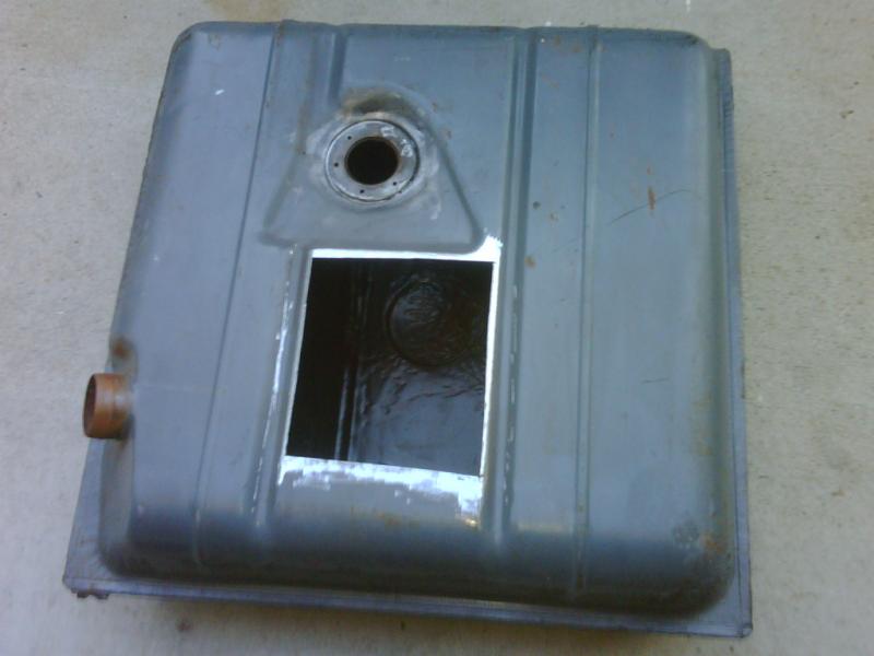

Well a friend of mine who is a excellent old school mechanic came by for a visit and insisted not to install the fuel cell. Said that if I did then I would need to build a fire wall.
A lot more work that I just don't want to do.
So I still have OE fuel tank, I'm going to put it back in.
I will have to re-route exhaust to another location, but I know what i'm going to do and it will be awesome.

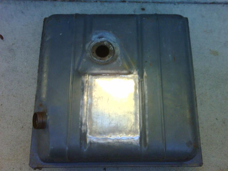

I had to patch the OE tank and it came out great.
Will fab in a fuel spout/neck as I will still have to fill from trunk as car has been shaved, including fuel door. That's okay as I just need to vent fuel spout and will vent under the trunk rather then in it.
PO cut out a piece of tank, probably for a patch piece.

I had my radiator buddy fix it. Thank god.

The tank is neat and clean inside... good to have that kind of useful advice before it's too late regarding the fuel cell/firewall...
Just to dangerous, a fire waiting to happen, especially a rear ender.
And the tank in the pic's was cleaned and probably relined inside with Kreem tank liner before PO decided to take a chunk out of it.

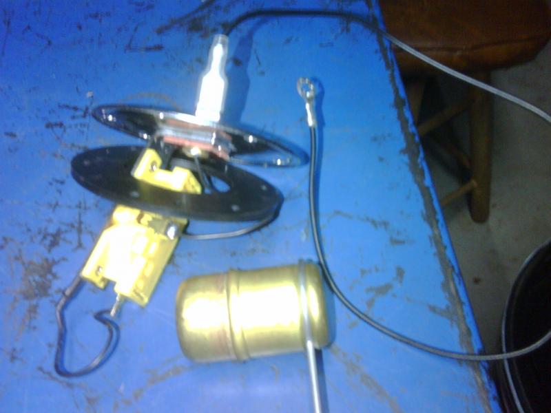

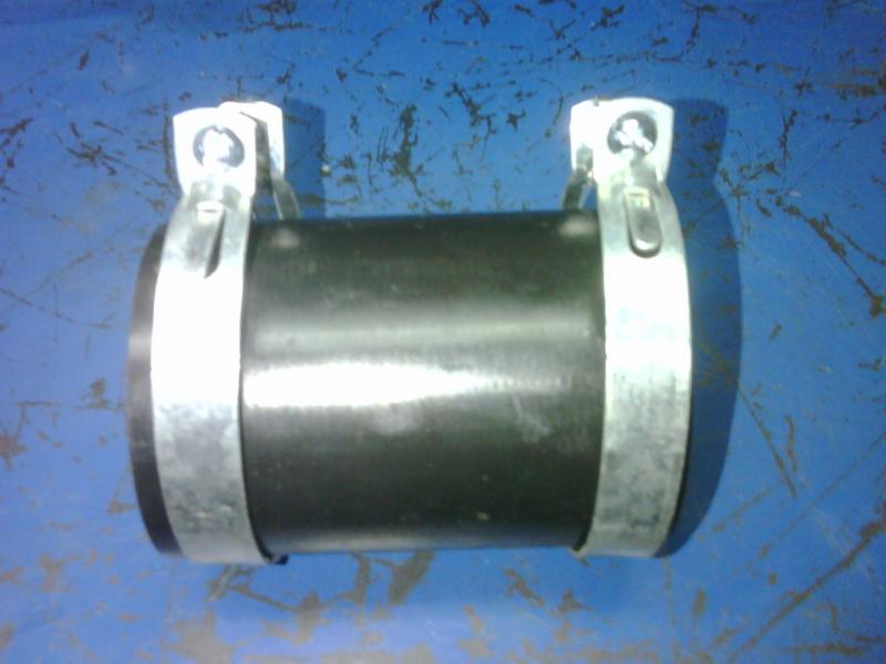

I recieved parts for fuel tank, sending unit, filler neck hose.
I also got better type screw to fasten fuel sending unit. Sorry about blurry pic
The one on the right is what the factory used.
The one on the left is just a china cheaply made, going in TRASH.

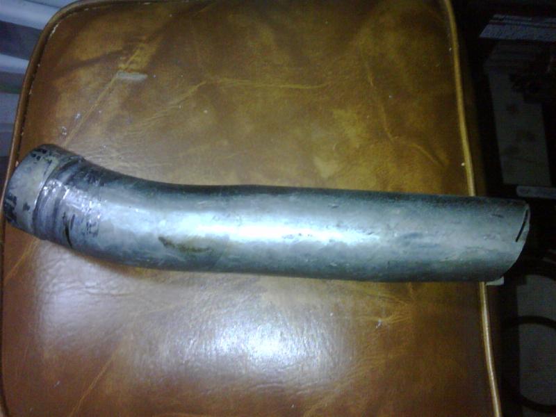

I'm going to have to do some bending to fab in fuel filler neck
I talked to my local muffler shop guy and he said he could put it on his bender.
It's still coming slow, but starting to make some progress.

Looks good... don't forget to lock wire those bolts that's what the hole in the head is for.
Good eye, but unfortunately I'm going to scrap OE tank.
I hadn't noticed that there was two broken easy outs on tank for sending unit. There pretty small.
I thought it was just broken screws, but when I couldn't drill them out I knew I was in trouble.
That's probably why PO cut hole in tank for patch piece, because it wasn't worth fixing.
Machine shop with an EDM could remove easy outs, but for the cost its not worth it.
Just have to pony up and go the route I should have from day one.
Alot of ------ right now.
I will post up with the fix (with pics) when I take care of some returns and get new parts.

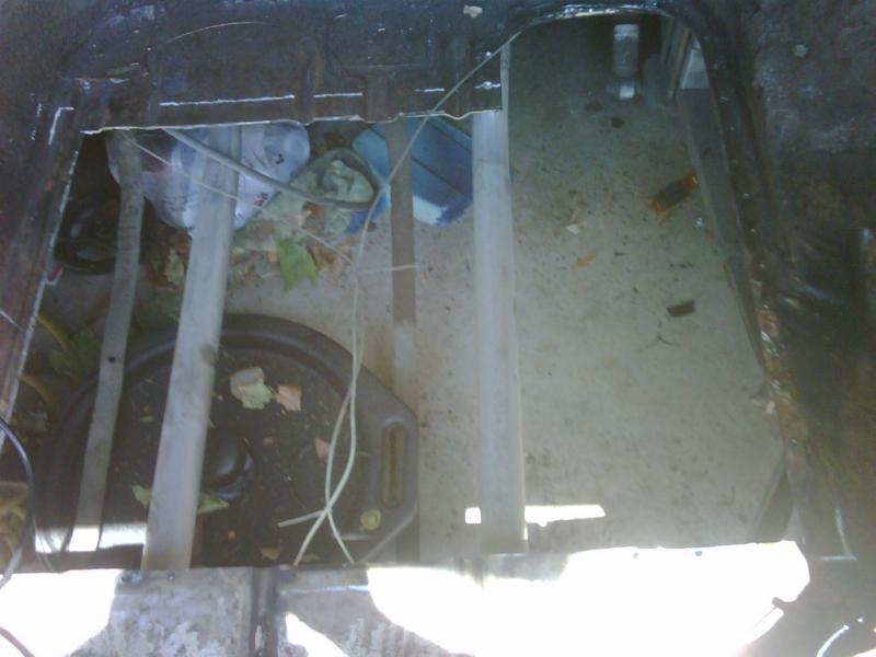

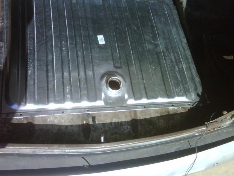

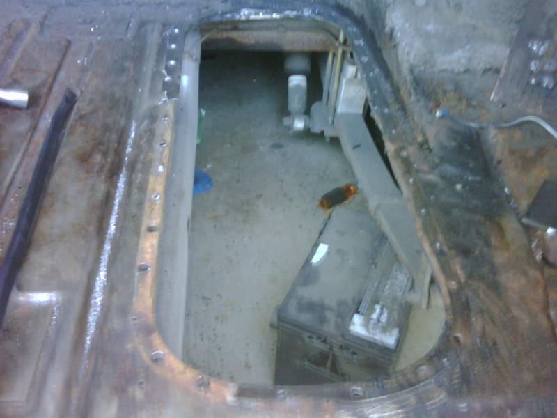

Finally got this frickin fuel tank swap started
Made a template cut it out and tanks fits real nice.
Looks like a big mess
Came out real nice
Just the easy stuff now, clean, por 15, undercoat, paint and bolt in tank and hook up wiring

What was the original rectangle panel hole for? a spare tire well?
drop in tank looks good...
Old May 11, 2013 | 09:12 PM
  #57
ksti's Avatar
Joined: Dec 2011
Posts: 1,388
Likes: 8
From: CA, Until TSHTF!
Yea, that thing was big and deep, reminded me of a doughboy swimming pool lol.
