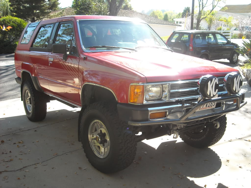

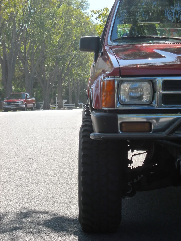

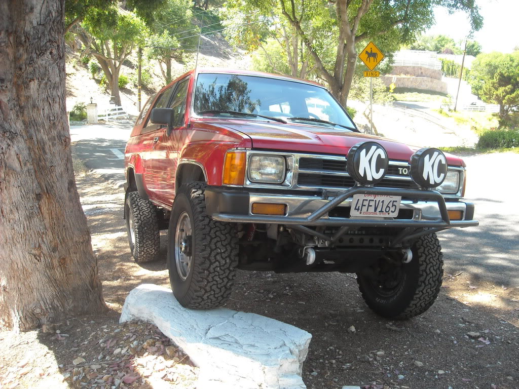

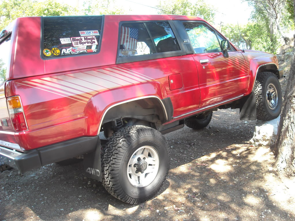

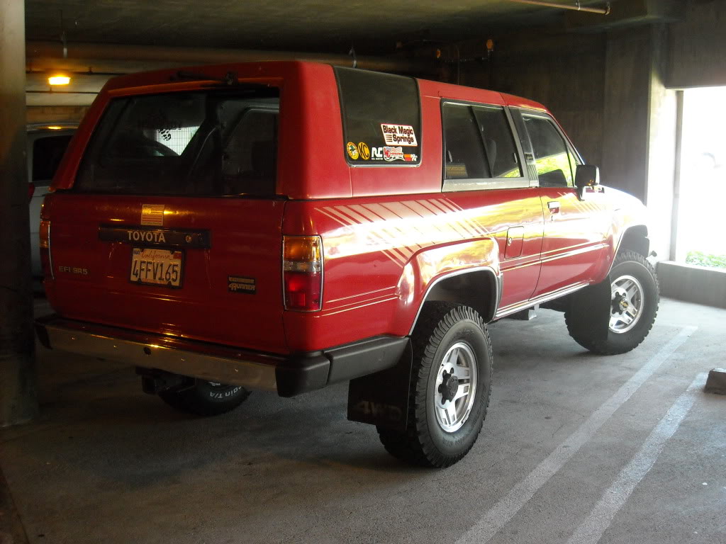

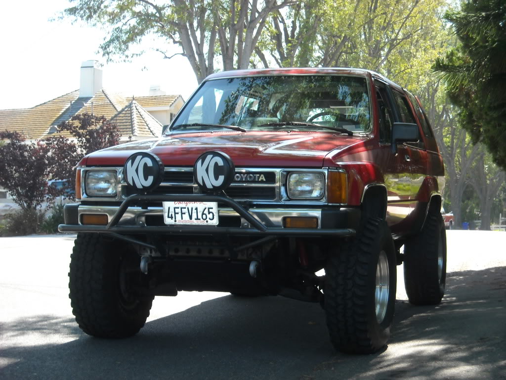

87 4Runner on stock 15x7 Toyota Aluminum Rims with 31x10.50x15 BFG/AT-KO's....

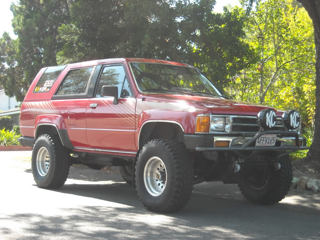

Same truck; With second/spare set of --- 32x11.50x15 BFG Mud Kings on 15x8 Outlaw 2's

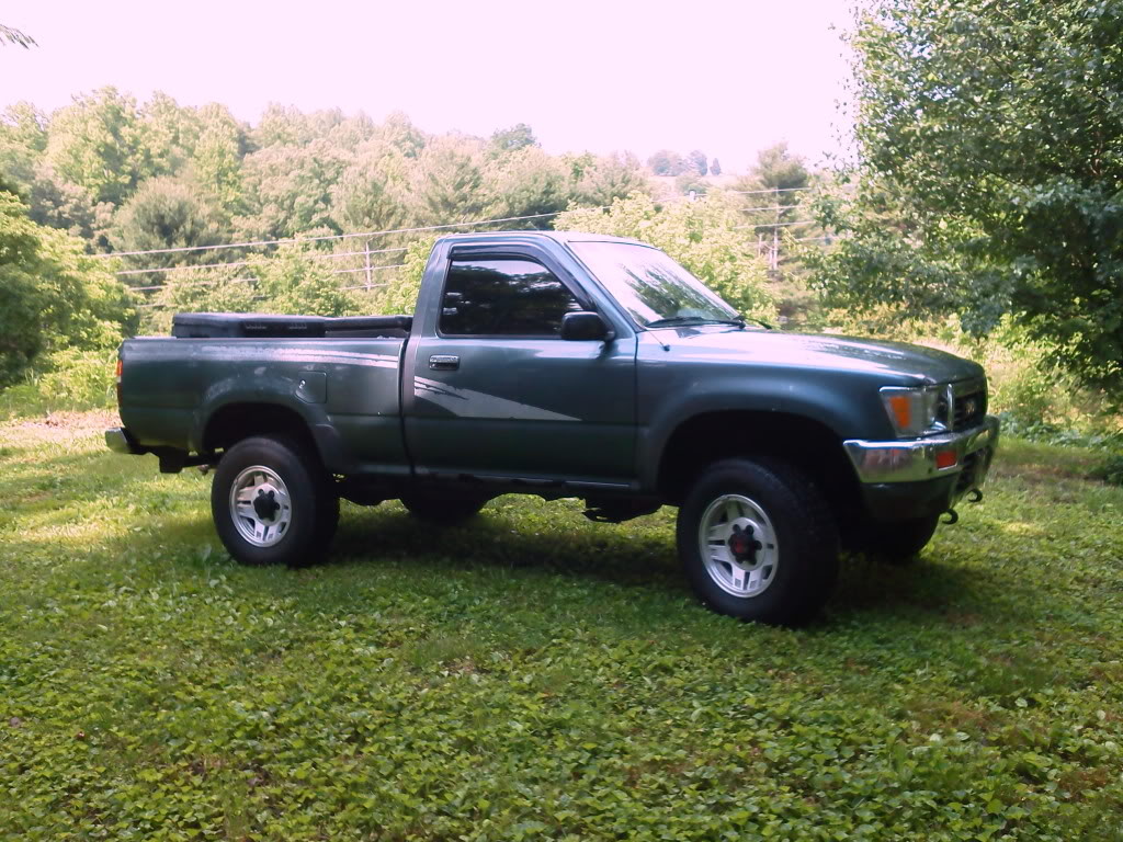

I'll give ya 500 internet points just for replying!
I looked through the picture threads, but there isn't really much wheel/tire specific information.
What wheel do yota geniuses think would look best? I am very open to suggestions.

Chef, that 4-runner is SEXY..... I've always had a soft spot for factory rims wrapped in meaty tires..... and those tires look great too. Very nice!
2500 internet points to you sir. Do with them what you will.

The pics with the factory rims, which I REALLY like, big time(like you have) are 31's... I mean, I can't speak for anyone else, ...and I know many don't agree... But these BFG AT/KO's have been VERY good tires to me, 3 different sets now on different vehicles. The last set I just replaced? 109K miles on them, ...and I still had enough tread to sell them for 150$ for 4!
They fit right on, no rubbing at all... And they'll give you a lil UP and more cushion when off roading.. Plus, they have a tri-ply side wall... Some don't like them in the rain, but I've not had that problem.. not sure why. They ARE NOT great for snow... So keep that in mind... But I've used and got out of plenty with mine in the snow as well.. So I just think they've been the best higher dollar investment for me over 3 different rigs(and 2 times on this one )

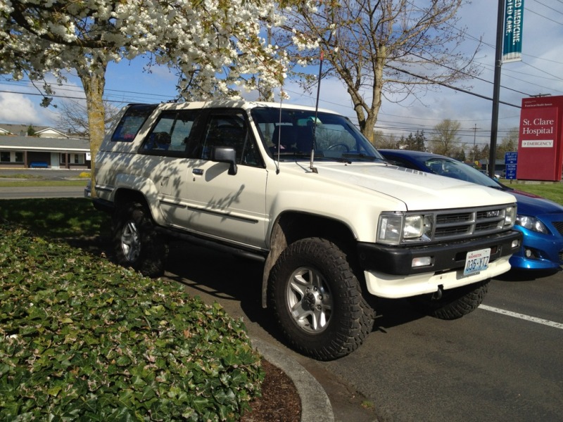

Don't really have any decent pics of the tires and wheels. But I have 16x7 3rd gen 4runner rims with T100 center caps on 265/75-16 Goodyear wrangler duratracs.

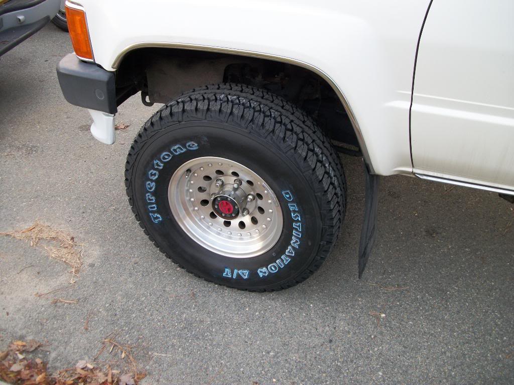

I ran some 31/10.5 KM2s for a while on an American Racing aluminum rim. I really liked this setup. Not too loud on the road and great traction off the road.
If MPGs are a concerns, I would run an aluminum wheel (like your factory wheels). Less weight is less rolling resistance. Throw some 31s on em and go.
Im now running a sporttrack A/T 31/10.5 on a steel wheel..there ok, but I wont get them again...

Stock alloys will look the best IMO

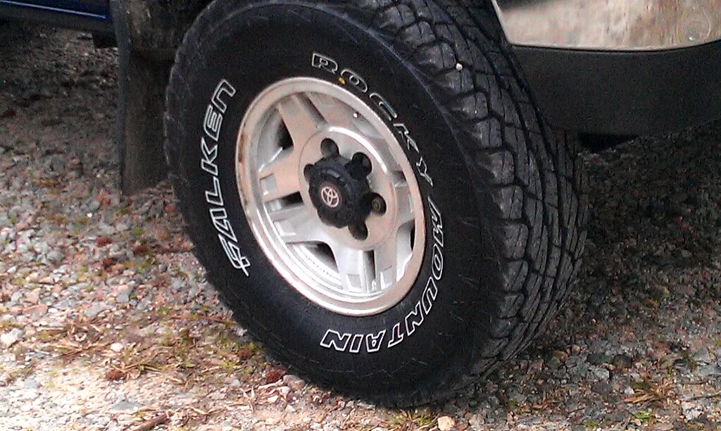

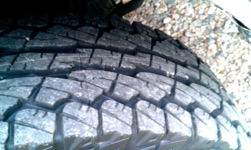

31-10.5-15 on stocks....
All grip, no roar, gentle on the tank.

Toyota has some very nice factory rims, I'll give them credit on that for sure. Obviously staying with a stock rim, and just upgrading the tire will be the cheapest option. Decisions Decisions.
Kiyo, Those 3rd gen wheels look sharp on that 4runner, digging that look.
Lycan, I sure wish my rims were that clean.... the clear coat is coming off, so they have a constant dirty spotted look.

You can buff those down, slap a coat of "alumicote" on them and call it a day, OP! You already have a set of 5 rims that are worth a couple hundred bucks, minimum(that would save you, more importantly, at least a couple hundred toward some nice tires).

I replaced the factory steel wheels with those rims, I see them more on 4runners then trucks around here...they had sit for awhile, and that crud just wont come off. I think I can find a nice set of the same rims for cheap on the local Craigslist. I really like the look of those tires on these rims.

Btw. Brake dust and crud on rims, use gojo hand cleaner to scrub it down. I've also used a magic eraser with good results.

I get what looks like a calcium build up on mine. Could be equated to a 'clear cote peel'???? Ive used a plastic scraper and got it off... but after thinking it was like a clear cote, .....it came back! lol. Could just be a coastal thing? NO clue, but now I just work em with hand cleaner, like you said, each washing, and cleans right up. They're not bad enough unless you look RIGHT CLOSE.... so meh, whatever.
OP, you could maybe sell the ones you got when you find your new set? But I'd honestly try to use every method you can to try to clean em up... I've never seen them NOT clean up, to be honest. they make these reaaaaaaaally coarse scotch pads, they're purple... I've seen those work really well for ppl too.

I will try that, I had never thought of the hand cleaner....I have used SOS pads, and multiple cleaners like Simple green. I will take a close of picture of the wheel and upload it.

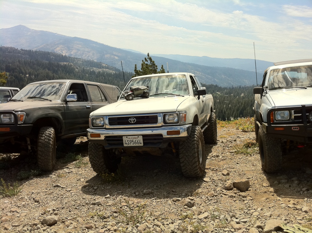

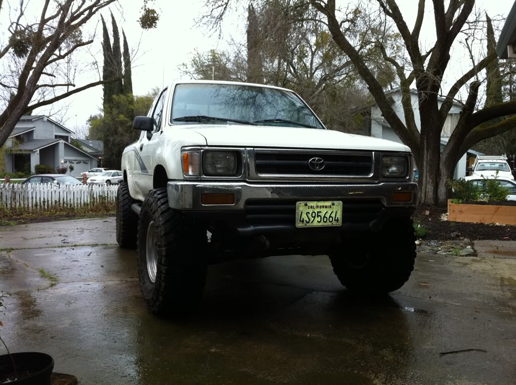

I really liked the look of stock alloys on my truck, but unfortunately they wouldn't work with a 33x12.5 tire, or a 35"+ if I decide to go bigger in the future. If you want to clean them up, try using a sanding sponge and some elbow grease to get the peeling away. Hand cleaner and simple green are great cleaners - never heard of using them on wheels, but I don't doubt it since they work great on grease. I've seen some really nice pics of stock alloys that were partially painted - the recesses of the wheels were painted black, and all the flat + perimeter were left aluminum silver, then I think everything was clear coated. It just kinda accents the original look.
A 31 is already technically oversized for stock gears - but still not underpowered and gives good MPGs. I would stick with 31 or 32" tire unless you're ready for gears too. You have lots of options for a 31" tire and they're much cheaper than larger tires.
Here's my truck below. I went from 31" Michelins on stock alloys to 33x12.5 Toyo's on 15x8 (3.5 BS) Pacer wheels (which are almost identical to Outlaw IIs). I have 4.88s and a rear locker. My truck doesn't run the best, but I get around 18-19mpg hwy and usually drive around 75mph/3000rpms.

I believe both 4runners flanking me have 33x10.5s on 15x8 black steelies, but backspacing closer to stock.
