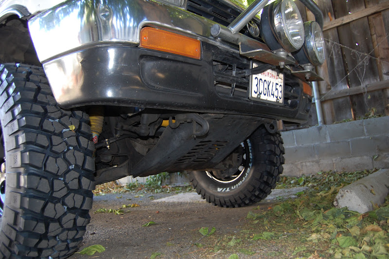

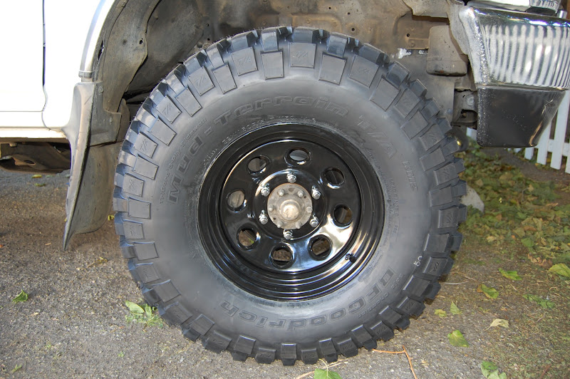

New kicks!
Very uncreative I know - I know why everyone uses these wheels and tires, they just look purposeful...
15 x 7 cragar soft 8
32 x 11.5 x 15 bfg mt km2
Before

Great combination. Looks good.

Mind if I ask what you paid for the black steel wheels?? I want some! Looks slick man.

41 ea. I believe from summitracing.com - $10 shipping for all 4, you can't beat it.

Nice kicks bro
Lol. Seriously though it looks good, very tastefully done

It's amazing what new shoes will do for a toyotas appearance. Looks very clean man!

Do u get any tire rub running those size tires?

Looking at the same combo. What backspacing did you get? Thanks for the pics!

Haven't gone off roading or even tried to flex much yet. Daily driving - the only rub I've found and I know that it will only be worse under compression and full turn off road is the front rubber mud flap connection to the wheel well. Not too worried about it though. I don't think the rear will have a problem.
I have 2" ome springs in the rear and 1.5" bj spacers up front.

4" bs - there's really no option with the cragars in the sizes I was looking at.

would 1" wheel spacers be needed with the 4" bs?

I don't see any weights, are they on the inside? or did you not need any?

I don't have any spacers...

The weights are on the inside. You usually have to request them to be put on the inside - otherwise they don't care.
