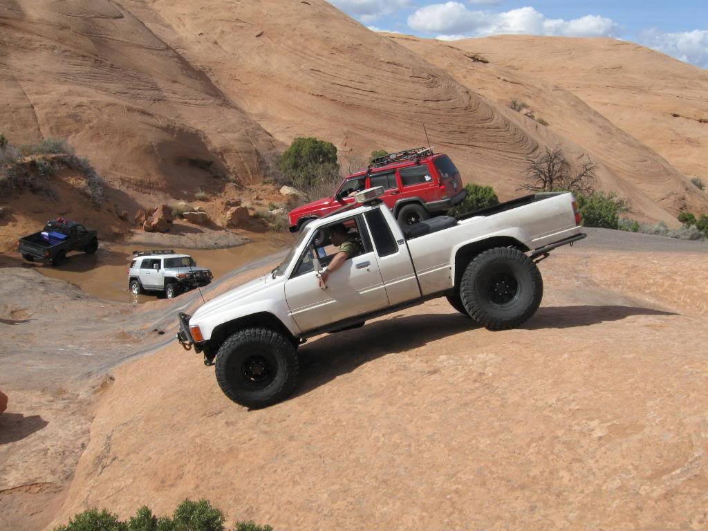

I like seeing "no lift" builds. There is a guy on Pirate who has a 2nd gen truck on 37's with no lift! He did A LOT of trimming though. Also found this first gen 4Runner on there 37's no lift either.
Truck
