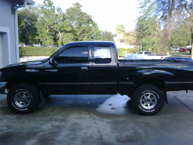

And I was looking at the BFG All Terrains - my 1996 T100 had them. Problem is, they seem to cost $75-$100 more than the other two choices I listed. Not really looking to spend any more than $150 per tire, if possible.

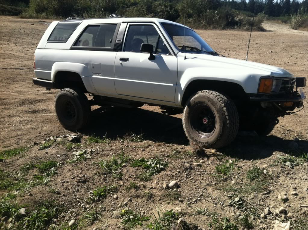

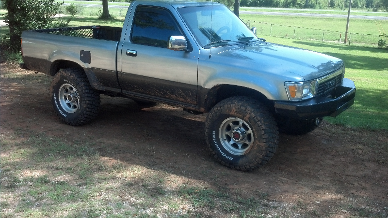

my truck had the toyota alloys (2nd wheel pictured above), whereas you have the steel wheel from that generation truck. i liked that wheel a lot and would have kept it if they'd fit 33x12.5s - but they don't have the back spacing/width. another nice wheel i've seen on 3rd gen trucks is the 3-spoke Tacoma alloys and they will fit 31s and 33x10.5s if you go bigger later:
right now, i've got a set of alloys that are pretty much identical to the Outlaw IIs (i think mine are older model pacer wheels) - but what I actually see on pretty much every toyota with aftermarket wheels are your typical black rock crawler steel wheels -- which pretty much look just like the ones you were seeking (just not chrome - but paint works!). they're relatively inexpensive and get the job done. you also won't need new lugs.
as for tires, that's really subjective to you. personally, i would avoid BFG AT's because they are an ancient design and IMO the modern design ATs from other manufacturers these days are superior for on-road driving -- but the BFGs are proven tough and hi-mileage, with the downfall that you pay for the name and everybody and their brother have them. i hear the Falken Wild Peaks are great tires, so are the AT3s, Nitto Terra Grapplers, GY DuraTracs, Cooper ST Maxx, etc etc. They are ALL great tires these days when consumer feedback on the internet can plague a manufacturer!
Good luck!
