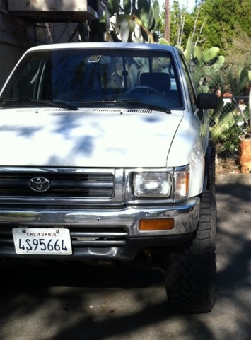

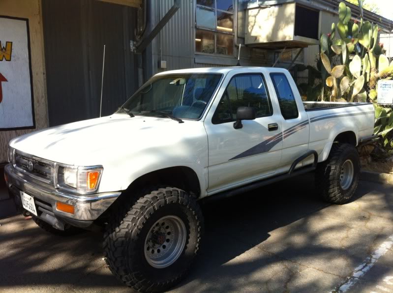

Originally Posted by wolf28
so im looking a some black steelies rims and i want the tire to stick out maybe .5 -1.50inches out from the fender wat back spacing would i need
I can't comment if you swap your tires for a different size, but if you decide to keep the 33x12.5x15s, then get some 15x8-3.75 or 3.5" backspace wheels. that's what size I run on my truck (the 3.75") with 33x12.5 Toyo's. Wheels stick out right around where you're asking. I have about 3/8" between sidewall and UCA.
Why do you want to get rid of the 33/12.5s? Personally I love mine
