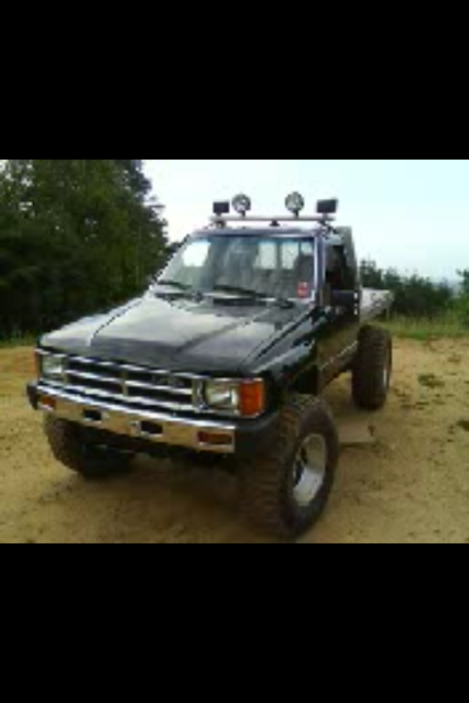

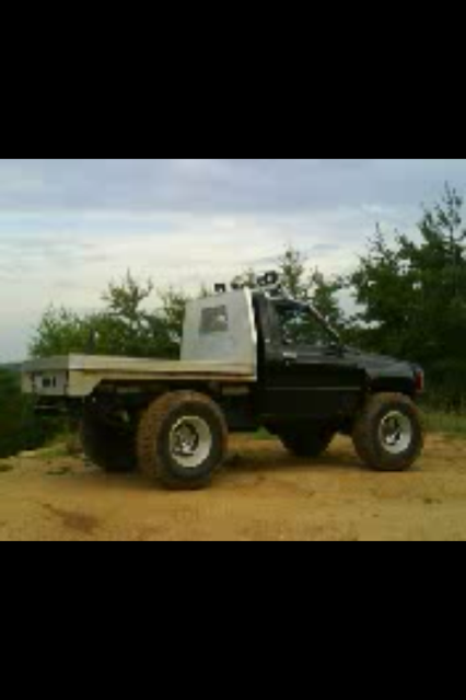

Size:  169.9 KB Name:  null-19.png
Size:  154.7 KB Name:  null-18.png
33-12.50r15
12" wide rims
No lift no rub...

Originally Posted by Toyota~Boy
33-12.50r15 12" wide rims No lift no rub...
How lol. If you hit a bump, doesn't it rub, what about full lock? 4 inch suspension my 33's didn't rub at all. 35's did at full lock on a hump. Couple more inches of lift. Golden. Idk. Magic to me.
If I turned completely and cross a ditch or hard bump then I rub... But other then that no run at all.
Thanks for comment to.. She's currently under the knife waiting a SAS

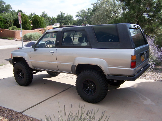

33x10.5"s may not rub on your truck with no lift but they would have rubbed on both of mine...
My 86 4runner with 3" springs in the rear and BJ spacers in the front. 15x7 rims with 4" backspace
My 88 excab with 2" rear springs and BJ spacers in the front and a 1" bodylift. Stock SR5 alloys.
