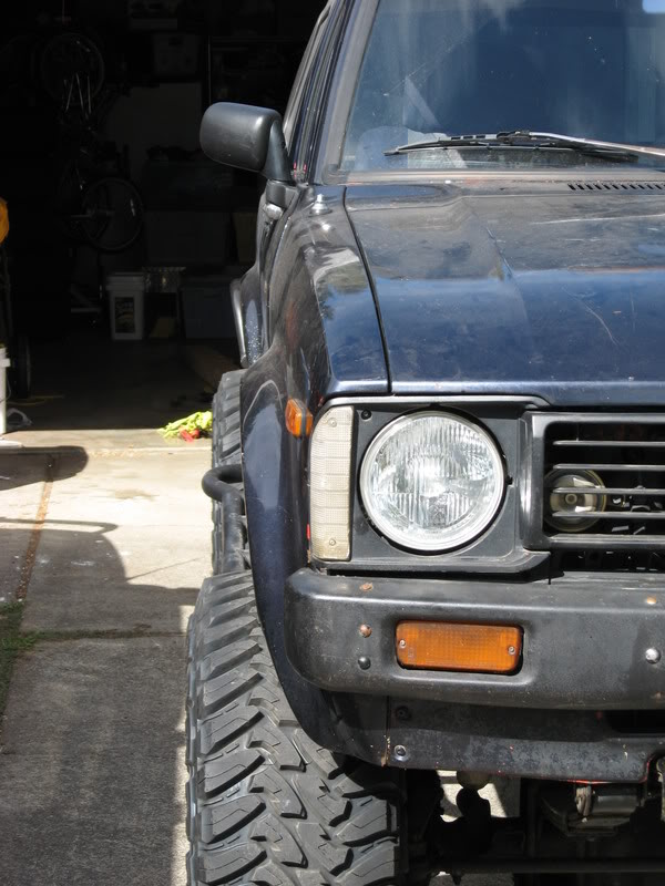

the 8 and 10" rim dilemma faces a few people. If you are talking about the '95 Runner in your avatar, I would go with the 8" wide rims. Not sure what lift you are running.
I have run both sizes on various trucks over the years.
Granted these pictures are of my '81, 8" wide rims with 3" BS, The lower pictures are with 1.5" spacers but I think it might give you an idea of how far the tire might stick out on your truck with a 10" Rim.
Before spacers:
After 1.5" spacers:
In some areas having your tire stick out that far is illegal and some cops like to get guys for it.
It all comes down to backspacing in my opinion...10" wide rims give you more stability but also increase wear on wheel bearings due to the increased unsprung weight....
