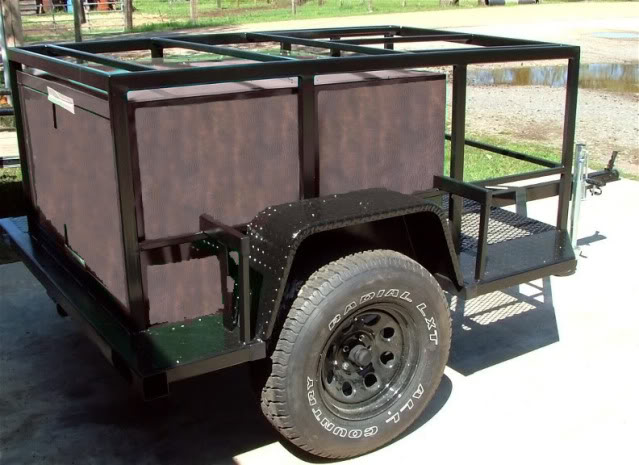

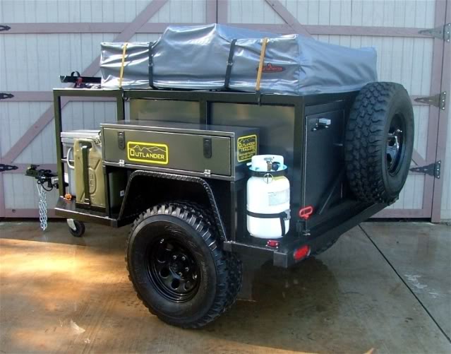

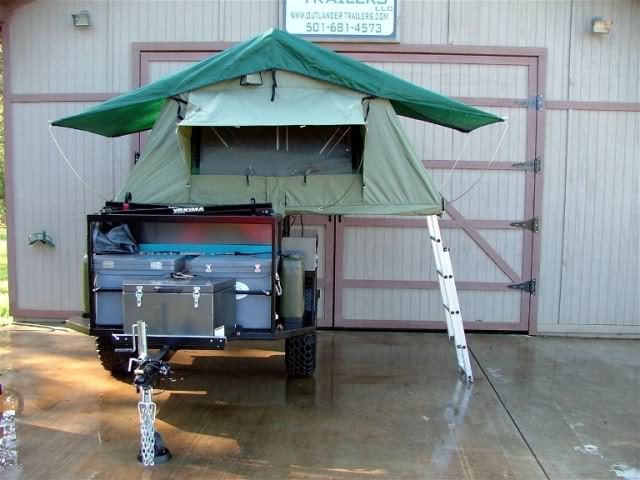

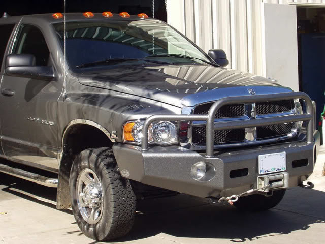

All,

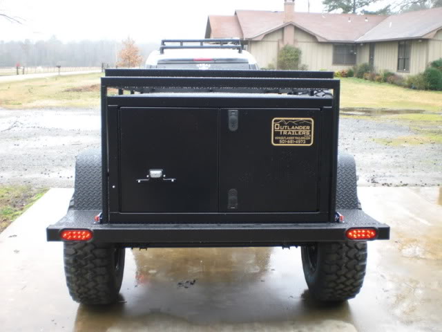

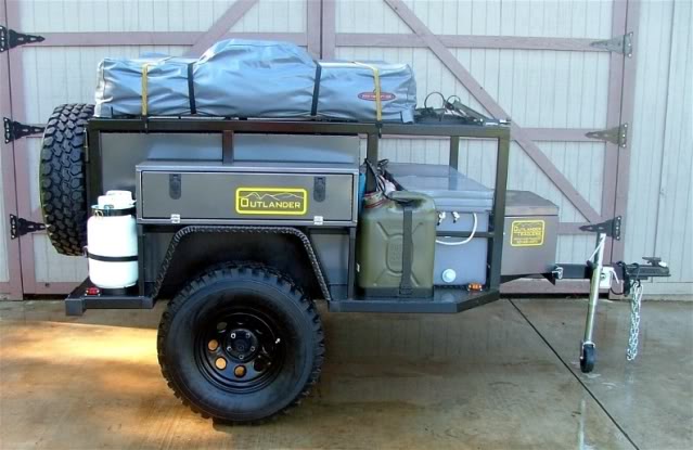

I am now able to proceed with my trailer project. I have been 'chomping at the bit' to start and now my wife has given me the green light (following paying off her '04 Sequioa). Mind you, she has always given me a green light to proceed with the various projects that I have had in the past...I dare not venture into the 'do-it-yourself' realm as some of you have admirably done, rather, my skill set lies in the realm of dentistry, and I realized early on that it's easier for me to deal with millimeters in the mouth rather than inches and square feet in the garage.
Anyway, I had a chance to look at the many offerings on various forums, and I want to congratulate and thank all of you for your contributions. There is a wide variety of trailers here that range from the elegant to utilitarian. Nonetheless, all have their strengths and weaknesses. My needs required a more 'modular' approach to a trailer. I felt that an RV or a dedicated camping trailer would only be a 'one dimensional' solution for my needs and wants. I intend to use this trailer throughout the year depending upon the season. It will be used for the following: 1) going into the woods and haul split logs for the winter. 2) have the ability to drag various big game from the field to my freezer (following processing of course). 3) have the ability to load up my ZTR or future ATV. 4) take the family camping in the great outdoors. 5) serve as a part of the TEOTWAWKI solution and help get my family out of the suburban jungle to the sticks...So, given all of these factors, I have decided to go with a custom built trailer by Outlander trailers. I have been in touch with Robert Shepard for over a year now, and we have bounced around various design ideas. My trailer will be a form of this type of trailer called the Sherpa II. The width will be a little wider since the modern ATVs require about 50" across.

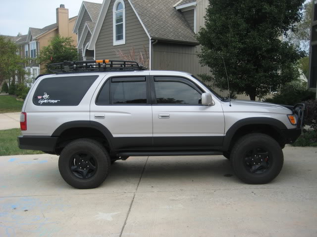

I just returned from Sheridan, Arkansas to see firsthand the Outlander trailer operation. I got a chance to spend about 2.5 hours discussing the trailer options available. Let me say that his knowledge, attention to detail, and insight are all exceptional. It was well worth the trip!
I purchased 3 Bridgestone Dueler A/T Revo in size LT265/75/r16 and mounted them onto my split spoke wheels that I had in the garage. Tire shop had a first generation Revo laying around and let me have it for $100 if I bought two of the second generation ones...turned out to cost $150 per tire...

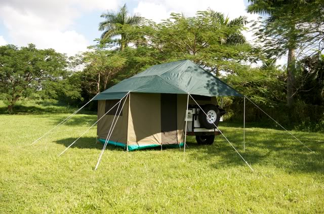

The issue currently that I am wrestling with is what kind of tent system to purchase. I need to have a changing / privacy room off of the tent for my wife to approve...So, I was wondering if there are any other options available besides the Serengeti...

I have also seen the Eezi-awn Globetrotter system but I think that the room would be too small for this to work. The room 'below' would need to be able to fit a cot as well as a porta potty system.

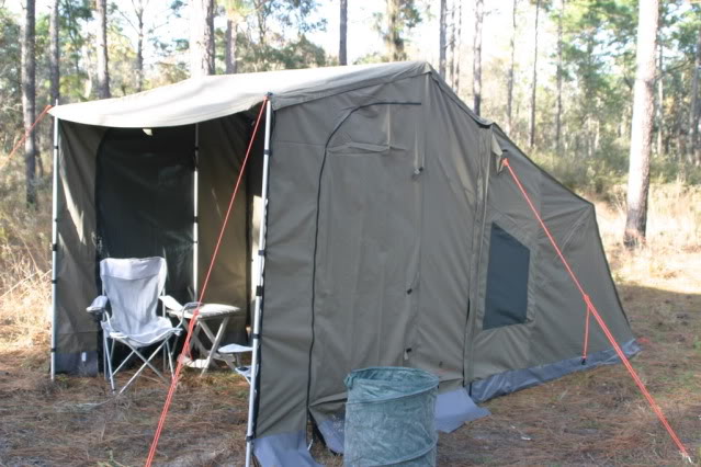

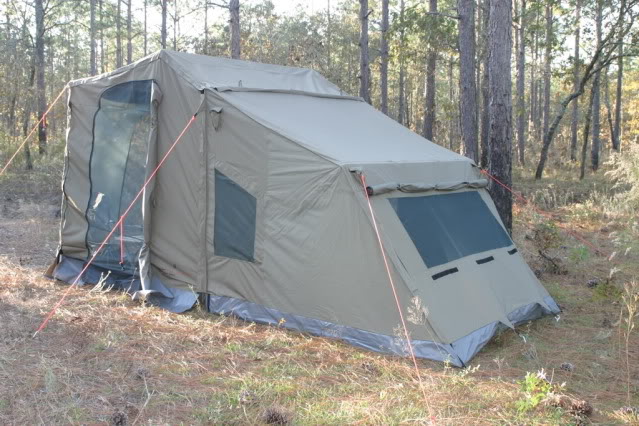

I have been pondering this issue...What if I went with a Mombasa tent (Adventure II) and in lieu of an additional room, go with an Oztent RV-1 or an RV-2 with Deluxe peaked side panels? The ideal would be to snug the tent right up 'into' the awning portion and then fabricate an custom wall that would drape over the trailer tent opening. The outer rain fly of the tent would drape over the the entire awning of the RV-2...Hmmmmmmmmmmmmm
I will call Oztent usa and get more information on this option...

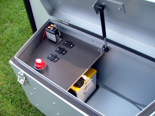

Got off the phone with Robert yesterday and decided on the electrical system as well as the LED light system...**Disclaimer - I am NOT an electrical guy by any stretch of the imagination so my knowledge regarding these specific systems are limited in scope.** If you have any questions, I will kindly deflect any and all questions to the professional (Robert Shepherd / Outlander Trailers / 501-681-4573).
Electrical system:
1) Battery: Deka AGM 9A34 ~ This is a sealed absorbed glass mat battery.
2) Charger: Guest 2608A ~ This is a fully automatic marine charger for a single battery bank. It has a maintenance function that will keep the batteries charged and desulfated during storage.
3) Battery Seperator: Sure Power 1314 ~ This separator disconnects the trailer battery bank from the vehicle when the vehicle is not running. It also controls the charge from the alternator to the trailer battery bank.
4) Battery master switch: Guest or Perko ~ This will shut down the entire system while in storage to prevent accidental discharge.
5) Shore receptacle: Marinco ~ This all weather marine receptacle utilizes a standard 110VAC extension cord to power the battery charger.
6) 12VDC receptacles: SeaDog ~ Three receptacles protected by inline fuses.
* Electrical system will not be located in a tongue box but rather in the front cargo box *

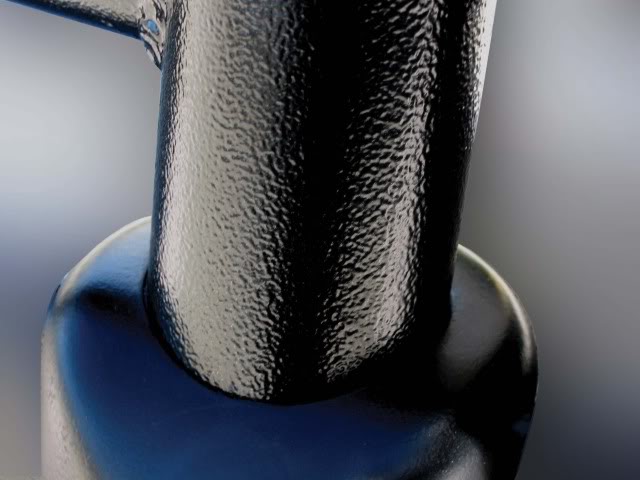

Now is the time for powder coating...The price for the Sherpa includes powder coating of the trailer as well as the cargo / fender boxes. The frame of the trailer will be PC'd with a black hammertone finish with some gloss...

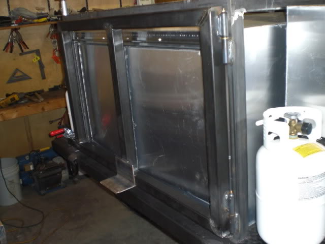

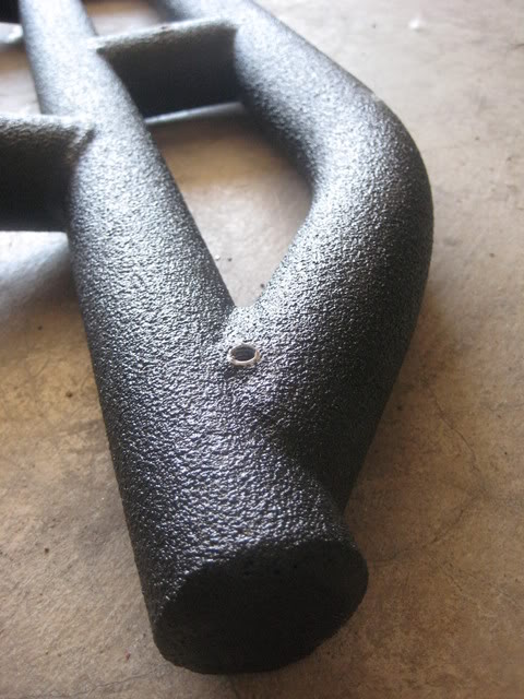

The cargo / fender boxes are presenting a different conundrum. I am looking at options regarding what color scheme to go with. The powder coating company that Robert uses has access to all the 'Tiger Drylac' colors. Several options are currently posted. I really did like aggie's 'old' trailer color scheme:
However, one of the drawbacks to the black color is that they get hotter during the day (Robert says approximately 20-25 degrees hotter) as compared to other color offerings...Therefore making the fridge work harder througout the day ~ Not good...
Thus, I am contemplating other colors schemes. Initially I was thinking of a clear coat on raw metal:

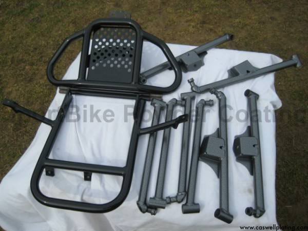

Another option would be a straight silver 'ish' PC color to hide the 'dings' from fabrication...

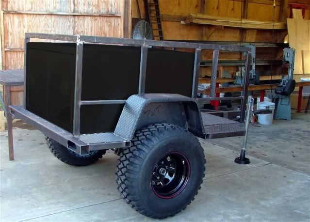

Thus transforming this:
to this:

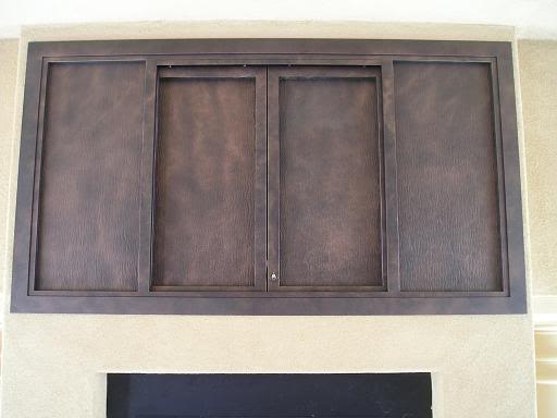

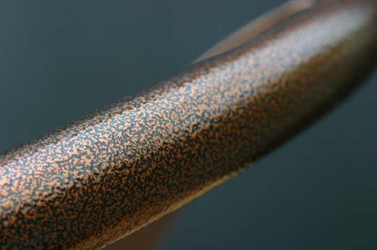

I have always been a guy that doesn't like to be be apart of the masses. Yeah, I have a quirky side to me. That's always the way that I have been ~ somewhat of a 'gadget guy' ...Anyways, the quirky side of me wants to consider a more unique PC vein / hammered / antique color for the boxes...

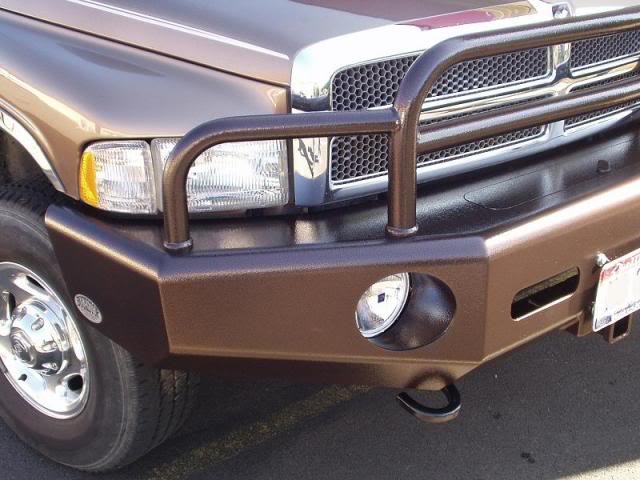

I must admit that the copper vein is growing on me. The awning as well as the tent cover will be earth tones...I figure one option is to go with the copper vein and use a tan type of lettering similar to Aggie's old trailer...
Here is a sample of the copper vein finish on a truck...Closest pic I could find.

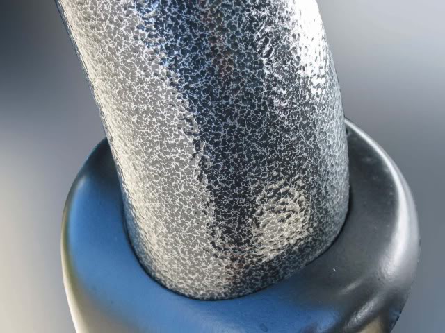

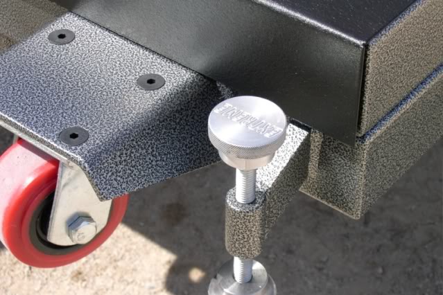

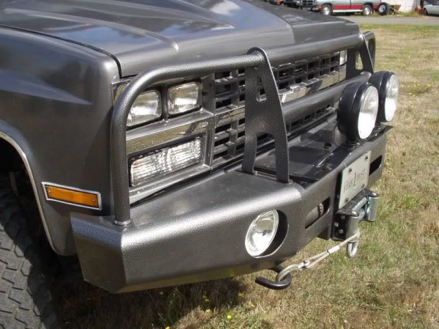

Back to the vein finishes. I am leaning toward getting the silver vein powder coating done. By the way, the frame will have a two layer coat of powder over a POR primer ~ that should keep the rust away for some time, and free us up to use this trailer as much as possible. Here are some samples of the silver vein finish from various distances...
As you continue to step away from the pattern, it seems to lighten up a bit. I think that this color will make the boxes 'pop'.

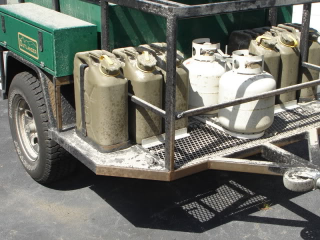

Again, my vision is to coat the 'fore' surfaces with an Ameraguard coating that will protect those sides from road debris... Ameraguard is similar to that of Rhino and Line-X, but it is more UV resistant. Both Rhino and Line-X are Aromatic Urethanes and will eventually crack, peel and fade despite the addition of UV stabilizers, it is chemically impossible to prevent this from happening. However, the Ameraguard product is an Aliphatic Urethane and is said to be more chemically stable and will not crack, peel and fade under UV conditions as fast. I am not a chemist by any means, however, I can tell you that this stuff coated on my rockers and sliders look as good as the day it was first applied...
The journey continues...

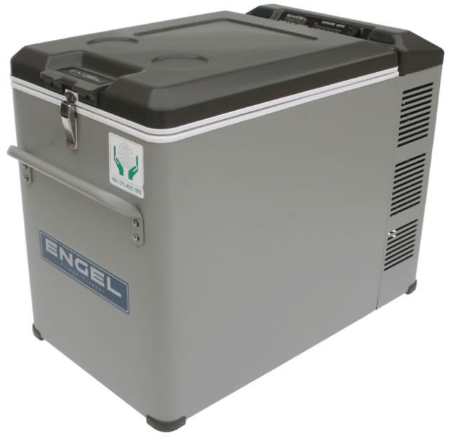

Pulled the trigger on a freezer/ fridge today. It is the Engel 45 purchased at Cabelas. I had earned a pretty nice chunk of Cabelas cash from my business credit card (Doing my part to stimulate the economy as well as stamping out dental disease) so 'cost' was minimal to say the least I chose the Engel 45 over a Yamaha generator for now. Based on what I have read on the forums, Engel's reputation for quality, efficiency, and durability is exceptional. Easy choice in my book. Pretty good deal for working hard...Now gettin' ready to play hard as well...

This will be housed in the front cargo area of the trailer box. Fridge will be mounted on a custom slide system.

The Engel is just like my old school ARB fridge.
Very reliable, and great to have camping.
Once you fridge, you will never want to go back to ice coolers.
