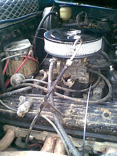

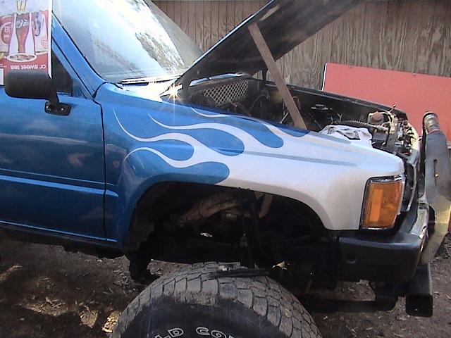

Im running the Vortec 350 in my 87 yota and running the stock radiator with 1 tauras fan pushing and my truck never over heats. Runs about 180 all day long in the trails... I think its the Factory radiator. i got the truck with no motor and that radiator was in there.
