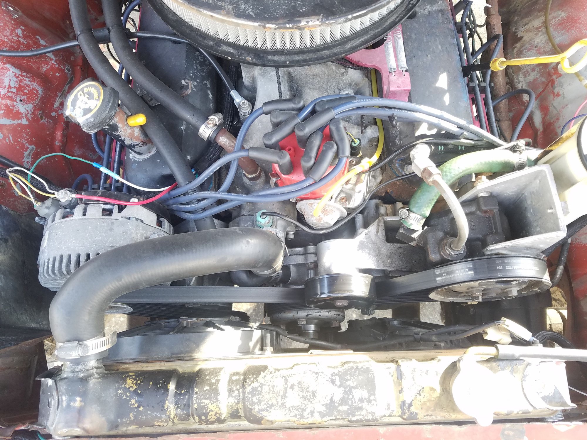

Hey guys, I took this truck out wheeling this weekend, and had a great time, but had some little gremlins pop up here and there.
My main concern is my cooling fan setup. The truck currently has two almost worn out "puller" fans that had to be mutilated a bit to fit between my engine and radiator. I think I want to change to a single 16" fan, but I don't have room currently. Should I mutilate my core support a lot, and move the radiator forward, or should I mutilate it a little and use a "pusher" style fan in front of the radiator?
My reason for changing the setup is that when crawling off-road, the truck wanted to run at 230° F, and it ultimately blew my fan fuse trying to keep up, with 2 fans pulling too much current. The truck has been completely re-wired in the the last 6 months, including a new fuse box.
Here are a couple of photos of the clearance in front of and behind the radiator.
