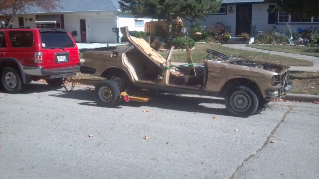

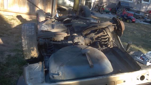

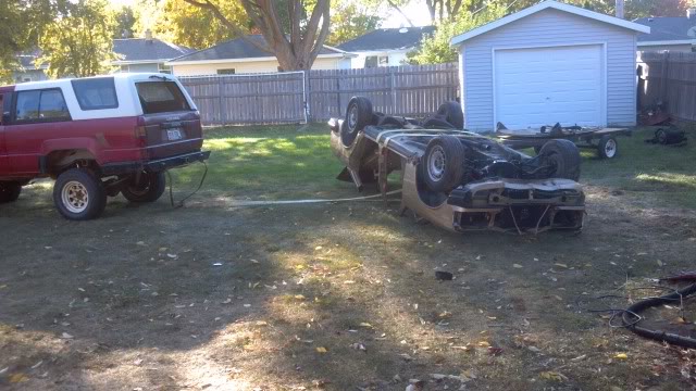

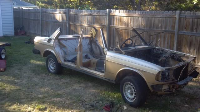

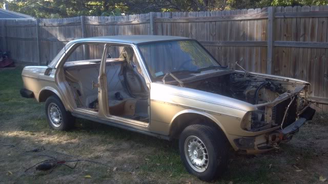

My Toyota diesel pulled a 300D with no problems LOL.

The red neck way to strip the under belly of a car. HE HE
