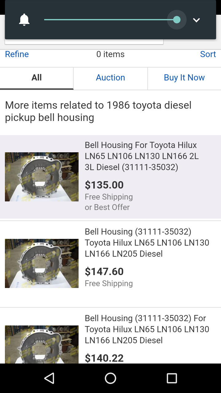

I'm still on this Diesel quest, I've got a 3L coming, I just need a bell housing. I don't know anything about determining which tranny my truck has, so I can't find the correct bell housing. Here are the ones I found on eBay, don't know if they'll work or not.
Not a very good screenshot but it provides needed information.

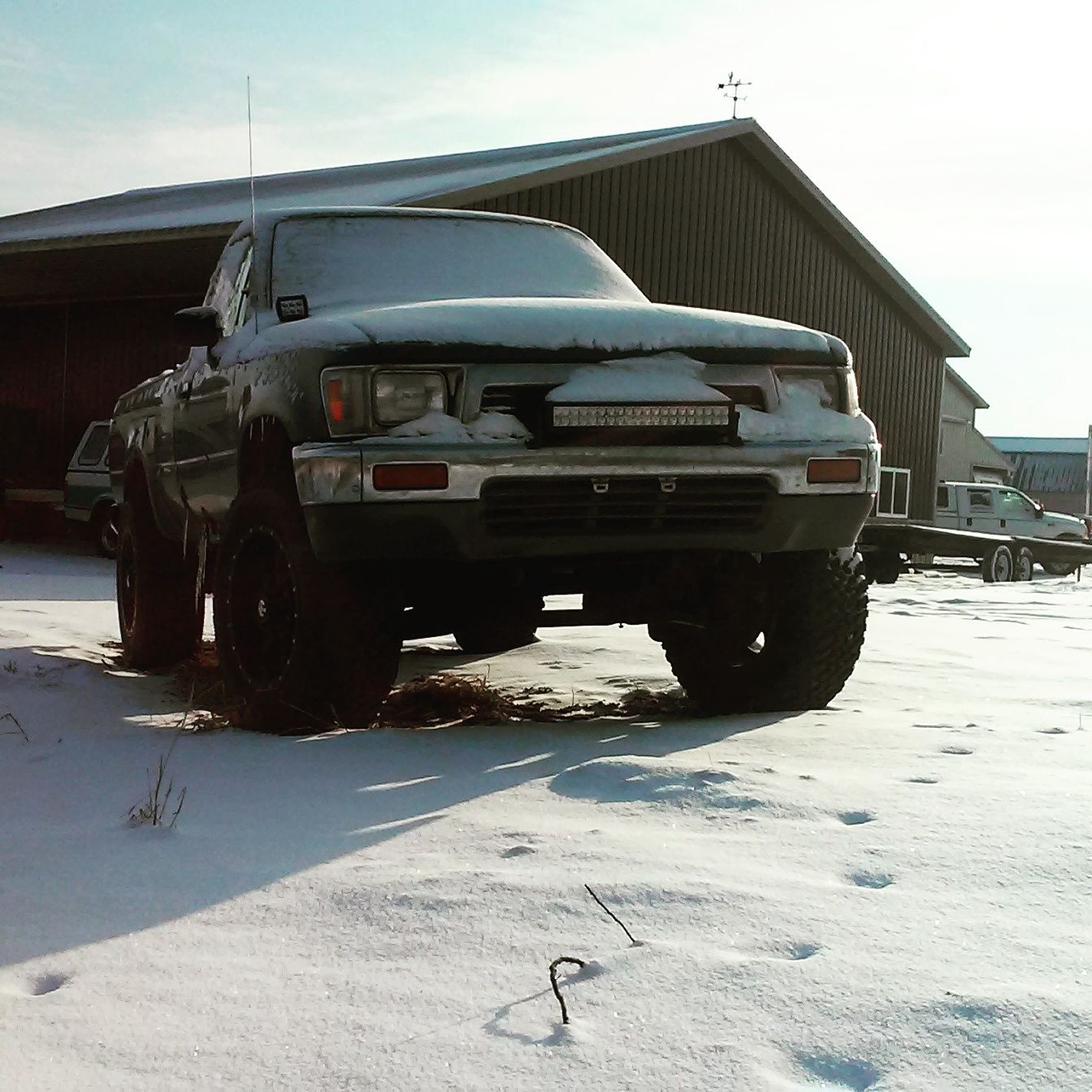

I now am the proud owner of a salvaged 3L Diesel engine. The above mentioned bell housing has also been purchased. My project truck has changed from the single cab pictured above, to an X-Cab, because of my commuting needs.
So, I hereby transform this thread from a dedicated inquiry thread to a build/ swap thread.
1st, pix! New rust bucket
Bed off, and other work as I awaited the arrival of the new powerplant

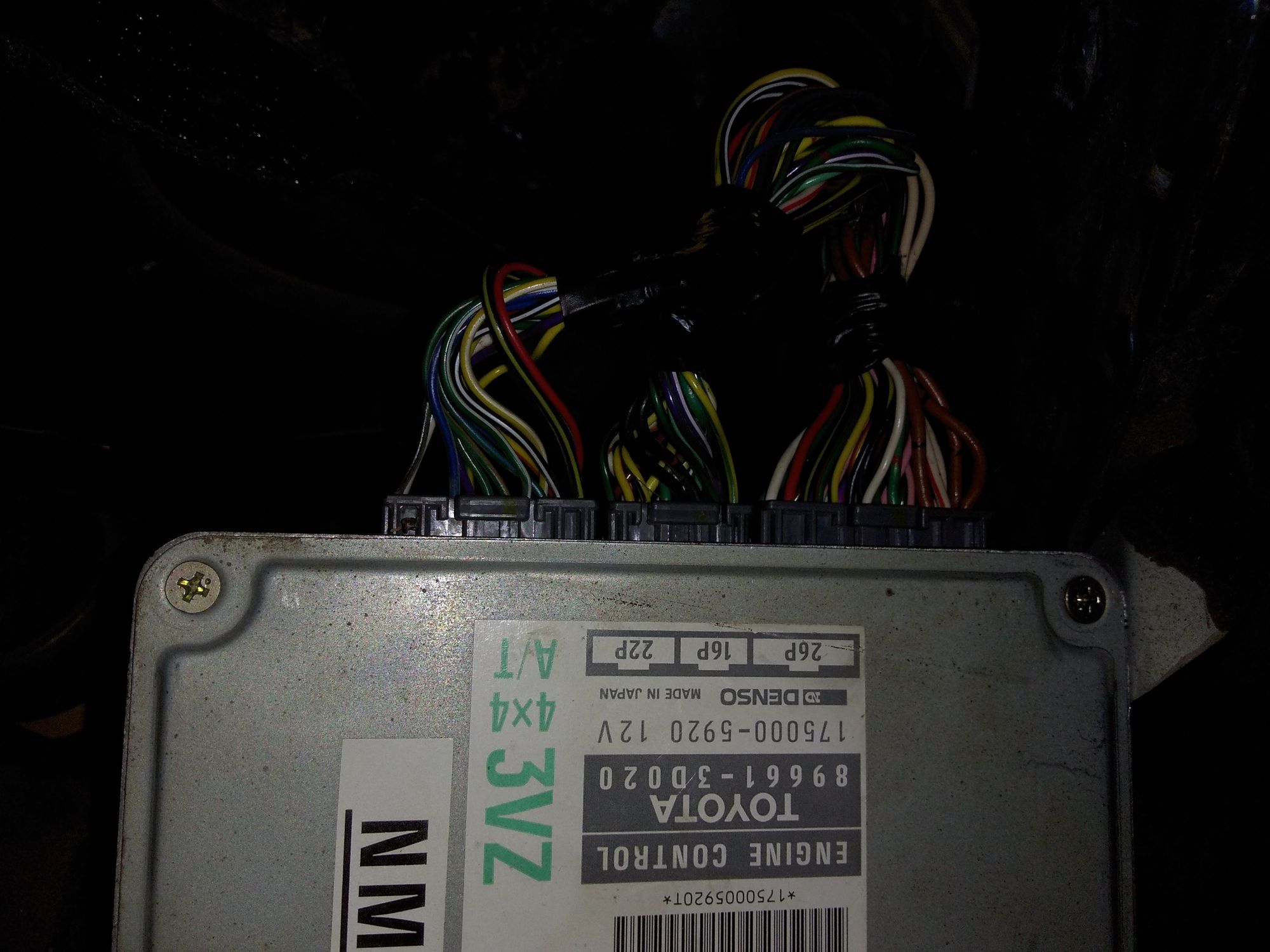

Just a few more things to undo, and this old "lump" will be free. All the bolts are out of the bell housing, all plumbing is disconnected, and now I'm stuck​ on the wiring. I don't know if the computer controls anything other than the engine itself.
Gonna do some digging.
After that, I'll weasle my way down to the mounting bolts and wrench them out, so, I can wave bye-bye to the 3VZ-E.

So, what plug runs the auto transmission and engine? I'm willing to keep the ecu to simplify things, but don't know what plug(s) to pull.

If you are going manual trans and mech pump with an ecu delete look into how the car seated trucks were wires.
Thanks for the input! Yeah, I am going mechanical, and manual. I'd like to keep a/c, and possibly cruise. So, I'm not sure if I need the ECU for that.
The wiring diagrams in my Hanes manual are difficult for me to read (I've got no experience with this). They have a separate diagram for each system, so I get lost quickly 😁
