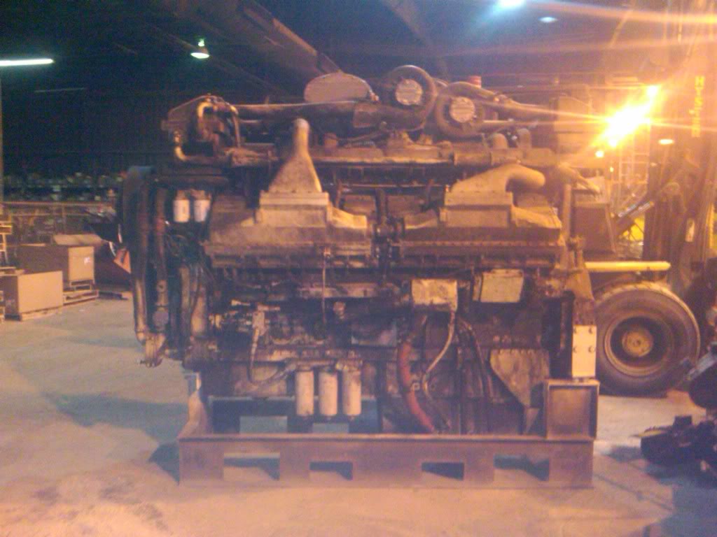

Be a man...
Model Cummins QSK60-L
Type 4 Cycle
Aspiration Two-stage turbocharged intercooled &
low temperature aftercooled. 8 turbochargers.
Emission Certification U.S. EPA Tier 1
Rated Power @1900 min-1(rpm)
(SAE J1995) 2 014 kW (2 700 HP)
Net power @1900 min-1(rpm)
(SAE J1349) 1 920 kW (2 575 HP)
Maximum Torque @1 500 min-1(rpm)
10 630 N.m (1 084 kgf.m,7 840 lbf.ft)
No. Cylinders 16
Bore & Stroke 159 x 190 mm
(6.26 in x 7.48 in)
Displacement 60.2 L (3 674 in3)
Starting 24 Volt Electric

wow, been a while since i have seen on of those. a qsk60 is a little guy. they are mainly used for gen sets. look at EMD's and GE's.
you can pick up a qsk60 piston and rod assembaly. the EMD's and GE's you have to use a chain fall.

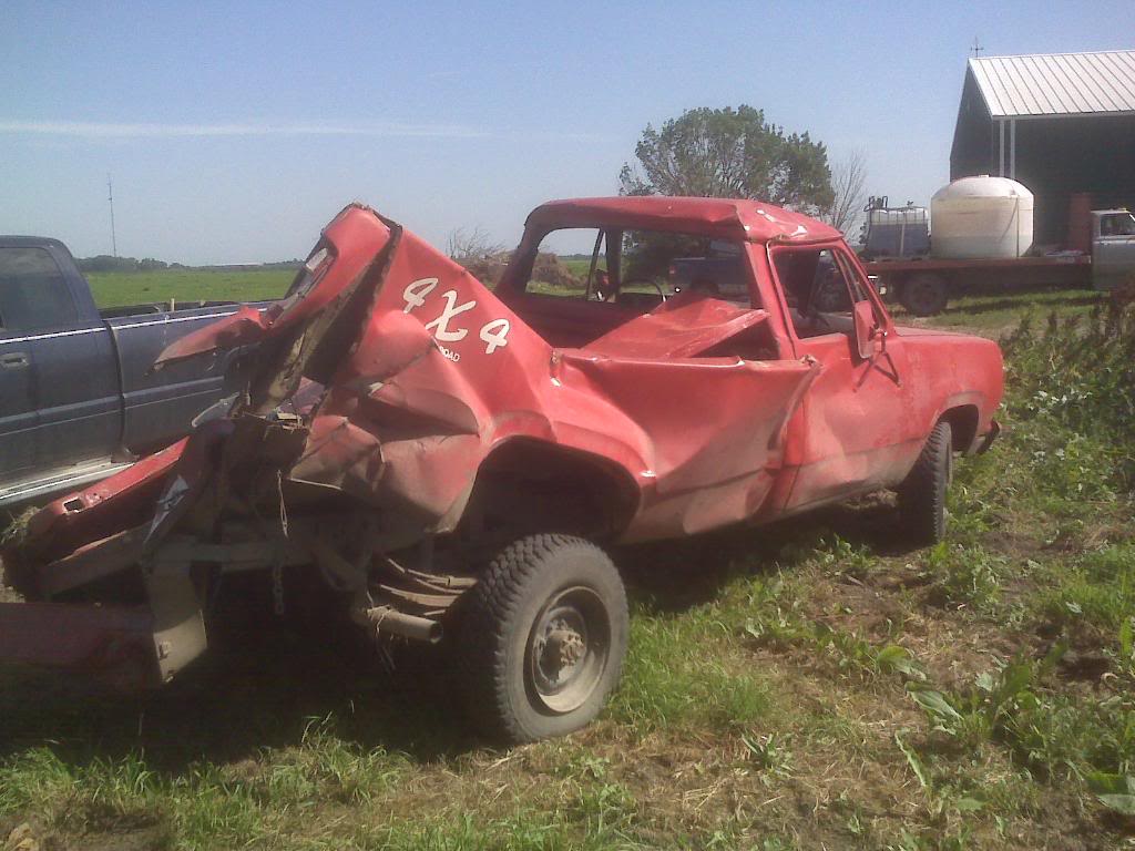

Just because you CAN doesn't mean you SHOULD! And just because you have the power doesn't mean you have the means to tow. Just look what happened to my dad last summer pulling too heavy of a load with too light of a truck. Sure we had the power, but not a heavy enough truck to keep the load under control. That trailer was EMPTY! Imagine towing a whole 'nother vehicle with a puny little mini truck. Sure, you'll have the torque, but your frame is built for towing, you may have the axles, but your truck isn't going to weigh 8-9k lbs like a 3/4 or 1 ton pickup that's actually built for towing. My dad was going 30mph!! Imagine trying to tow something at 55-75mph! And don't forget the most important thing, BRAKES! There's no way your going to have the braking power to stop your load, because your trucks going to be too light to stop your trailer, which is what happened here...
