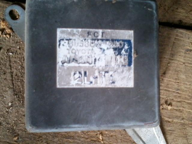

When I was in Afghanistan, I found a 2nd Gen runner (Surf) with the diesel it. Dont remember what size it was but did get the computer (I think it is) out of it. It was rolled on the road side and they just abandon them there.
Seen you mention a stand alone computer. They are not very big. Here is what it looks like. Hard to see the part numbers as it is faded. Looks like 2L-T1 or 2LTI.

Terre,
Yep, looks like a 2l, there was a member on here selling a 2l with transmission for $500 in Ohio IIR . 2L, 3L, 5L were diesels, then the 1Kz came out in the 90's followed by the 1KD and 2Kd in 00.
