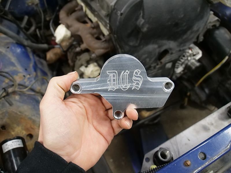

I have a vacuum delete for ALH available too, for anyone that might have some clearance issues back there. It came about for ALH diesel drag cars for racers that wanted to ditch the gerotor style pump off the cam to eliminate that wee-bit of drag on the engine. But it would work for anyone that's clearance challenged too. It's a direct replacement for the OEM Tdi vac pump and uses the OEM o-ring from VW. The white one is just the 3D printed test version.

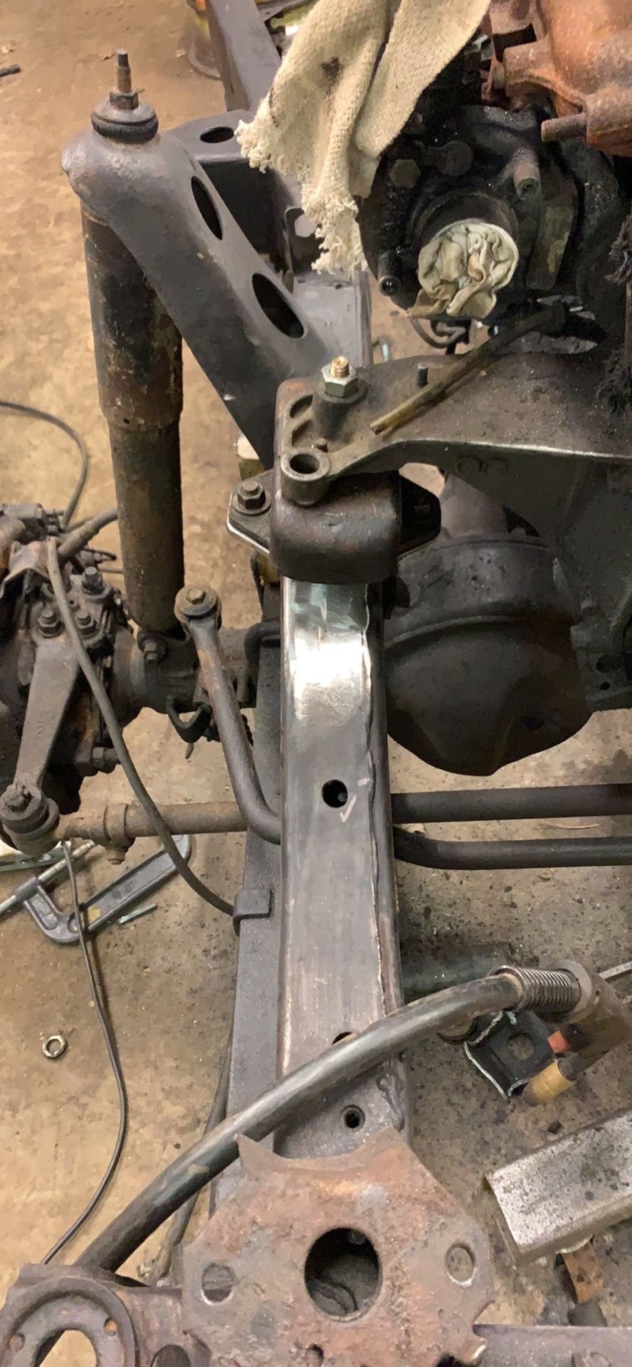

And the crossmember. This thing definitely cleared up the space issue with the t-case oil drain and getting to the driveshaft flange fasteners. I have a third truck underway that has dual cases, so I'll have a replacement crossmember available for that too.

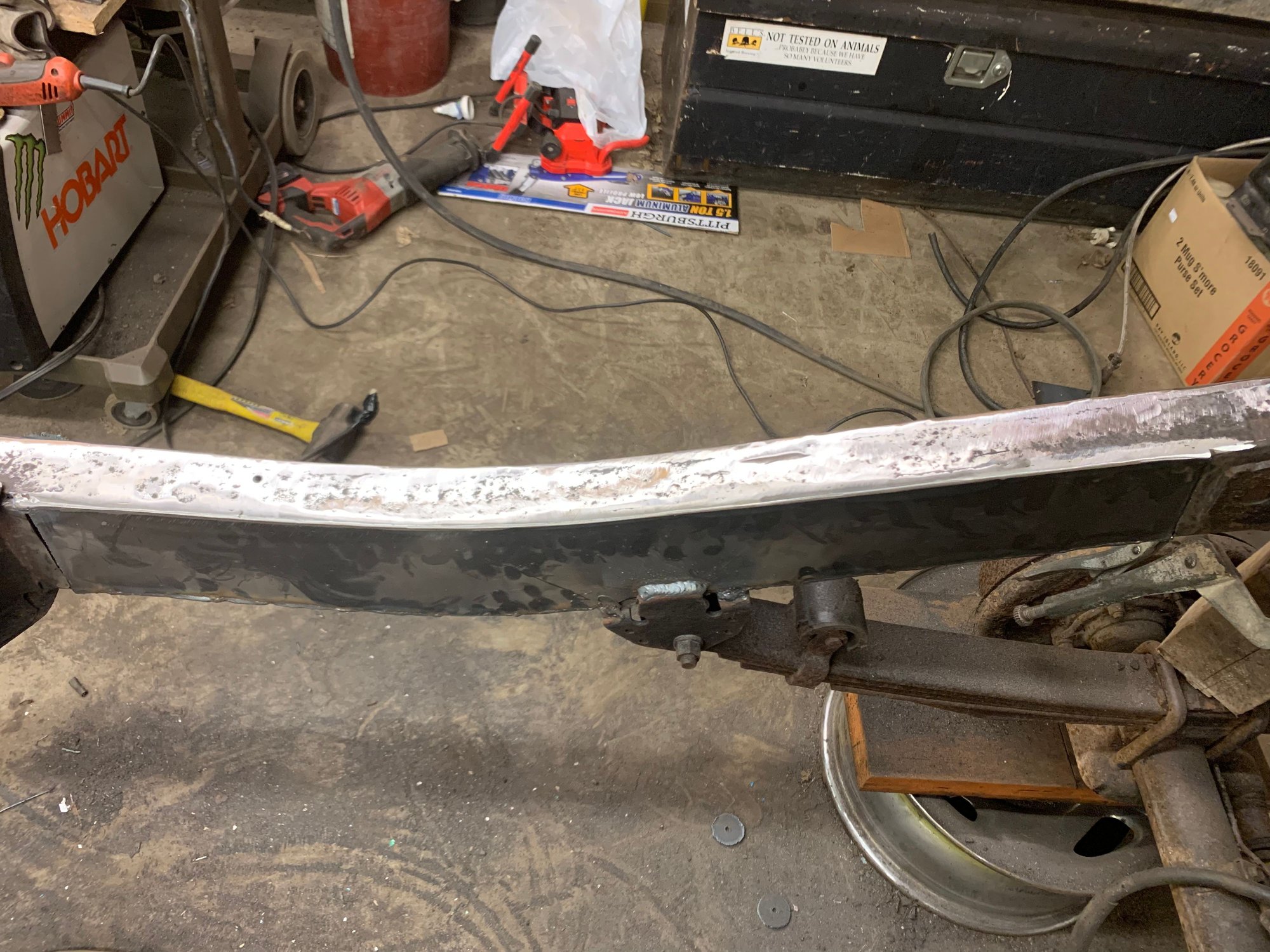

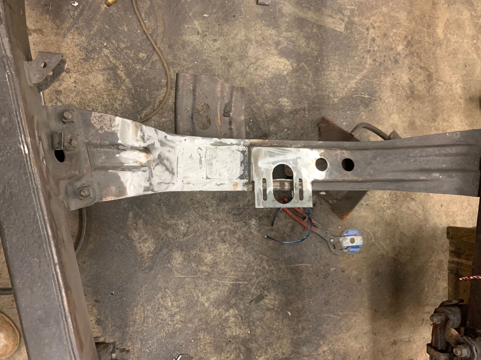

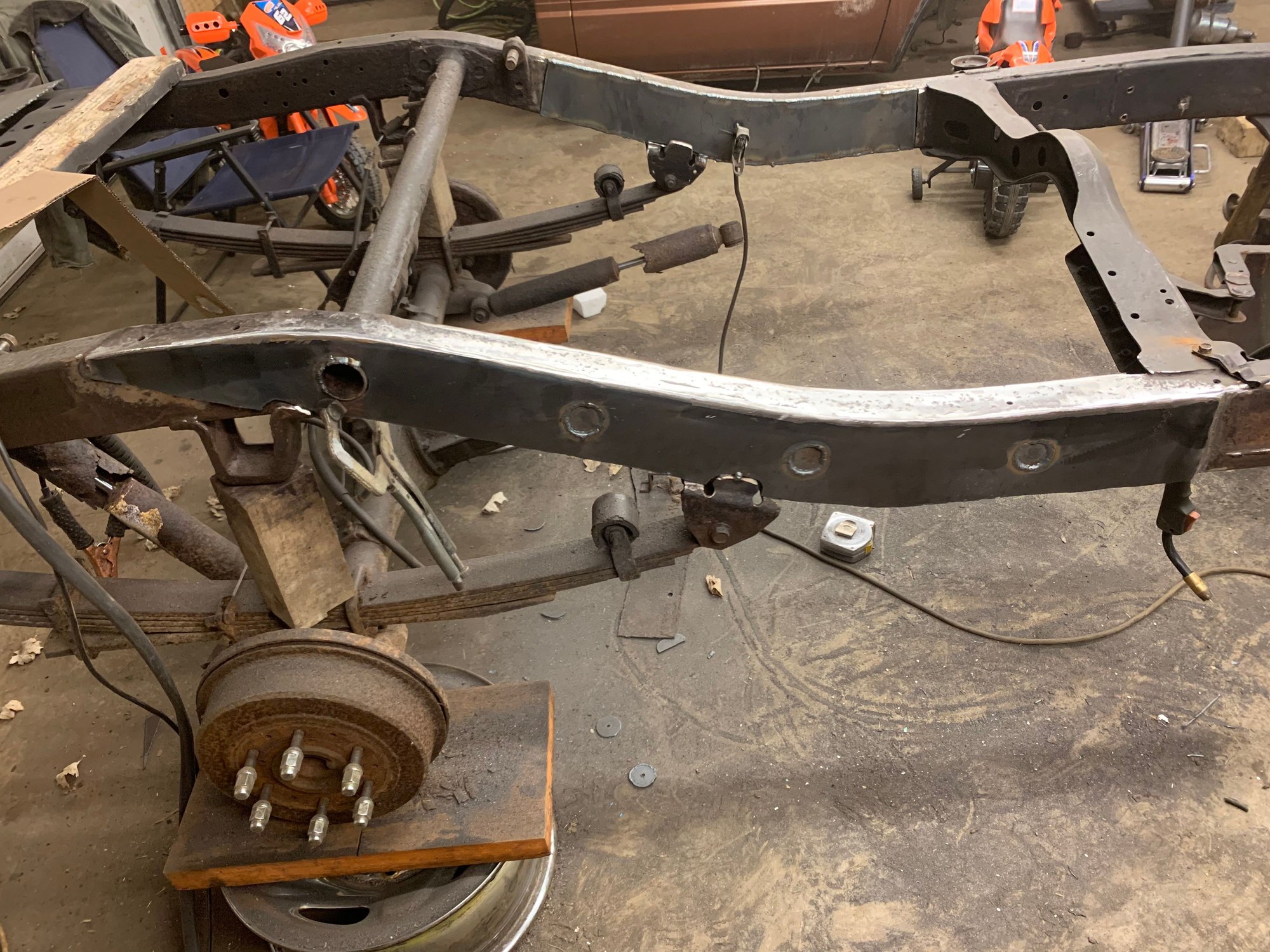

Almost done with frame work on my AHU swapped 85. Using parts from DCS kit.
Pass side mount using vw mount and 22re isolator
Drivers side mount using original vw mount and 22re engine isolator
Little reinforcements

Thank you frame looked solid with just visually inspecting it. Decided to open it up to spray rust converter in rails and glad I did if you ever wondered why they rot right here it’s because they put this stupid reinforcement plate inside the rails that is wet from the first day it’s off the line I cut mine out and redid everything also had big mice nest in both side of rails

These trucks are really great, but they were just not designed to be in areas were salt is on the road. I brought my 1984 extra cab to Wisconsin from California in 1994. It had never seen winter or salted roads. In just a few years and very few miles body panels had rusted through . The frame did last for about 10 years, and then I plated it like you’re doing, and then it lasted another five years. By then things had just gone too far and I was fighting a losing battle. As I see interest in these older trucks rising along with the prices, I am thinking no first or second generation truck or first gen 4runner should be on the road in winter where road salt is in use. My first generation 4runner has been mostly off the roads in the winter for the last 10 years. It was originally a California truck that someone brought to Wisconsin. The frame seems very solid right now, but is any of us who has been inside one of these frames knows, if you can see rust on the outside, it's 10 times worse on the inside. In the next year or so, I am going to source another frame for it from someplace in the southwestern United States, a frame with absolutely zero rust, I am going to sandblast it and pickle it and coat it inside and out with catalyzed paint. And then it will never see salted roads again.

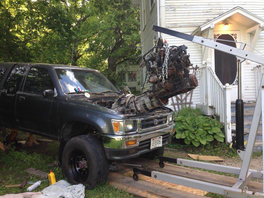

The engine is out of the Toyota. I have a 2002 Jetta donor vehicle. All I need now, is a good adapter.
My truck. Soon to be powered by a Volkswagen turbo-diesel.
Engine, transmission, and transfer case out without a scratch on the vehicle.
The 3VZE engine having served a long and useful life is retired. If you look closely, on the side of the block, you can see a hole where a connecting rod exited. I paid $1000 for this rig with a bad engine. When I complete the TDI swap, it will be the first time I have ever driven it.
