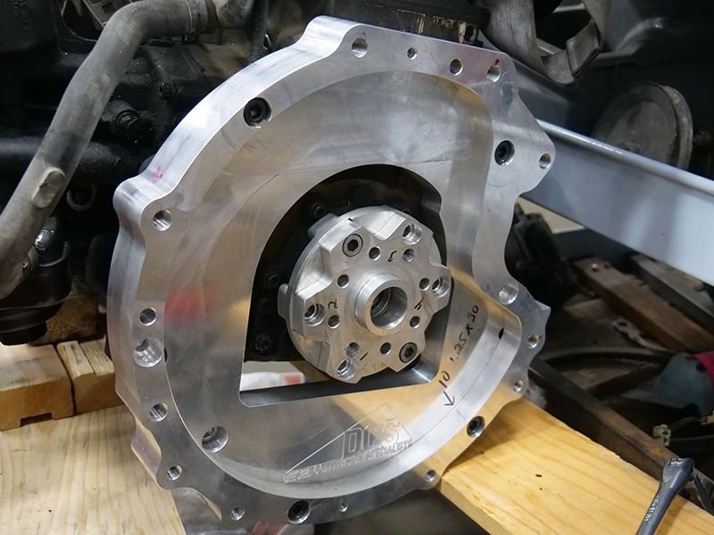

This is 3.0 delete version 1 (or ALH to R150). I made the crank adapter out of aluminum as a test just for the sake of time--and so I didn't have to clean out the mill just to run some steel. I wanna get it in the truck next week.
Adapting the OEM Toyota 8 bolt 3.0 flywheel to the 6 bolt tdi was the challenge, and keep the stack height right. I got past the 3D printed stage to actual machine part, now I just need to get it in the truck early next week and make sure it all fits in there. I am goig to at least try and do this first one with no lift kit. I realize it'll for sure require some oil pan mods, but I'd really rather do that than use a lot of lift.

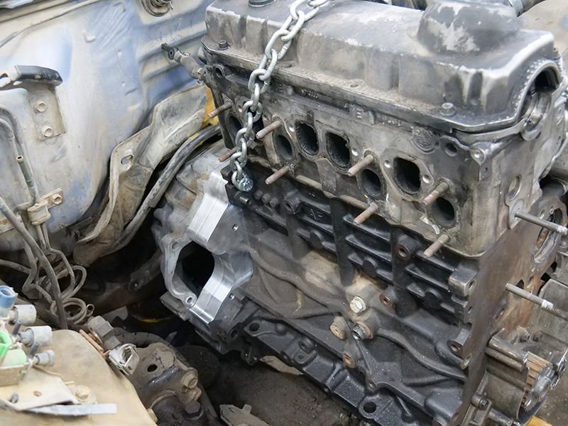

Got the 1.9 into the V6 with no lift--so far, so good. It will for sure require either modifying the oil pan, or, if we get ambitious, we'll just offer one that fits.

On the 88 the engine trans is forward an 1.750, and does have a lift. The only IFS lift I could find that moved the diff down was the 4.5 inch from Rough Country, I didn't really want that much lift, but (and if someone knows of one that's less-do let me know), it did provide lots of clearance for the OEM oil pan. Couldn't go any lower with the engine though without getting into the steering. The V6 truck has the entire drivetrain in the stock spot--(which is conveniently farther forward than the 4 cylinder trucks, and it look like even the Vacuum pump can stay!)), and that worked out really well, that is definitely the more conversion friendly truck. I just wanted to see if I could do it with no lift and try and keep as much stock stuff as possible. So far so good. Motor mounts changed a bit from the first pic, but, I think they'll be pretty user friendly, and no welding/cutting. So on the V6 truck, for sure with a lift you could keep that OEM oil pan.
