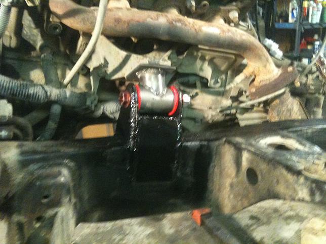

Ya im working on the motor right now...i just brought home the belt they sed was the right one but they are full of crap so im gonna try again... im not sure how to load pics on here but i will when i figure it out

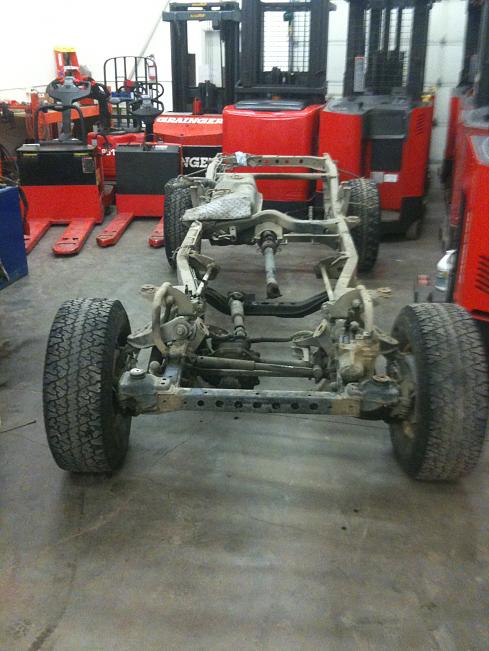

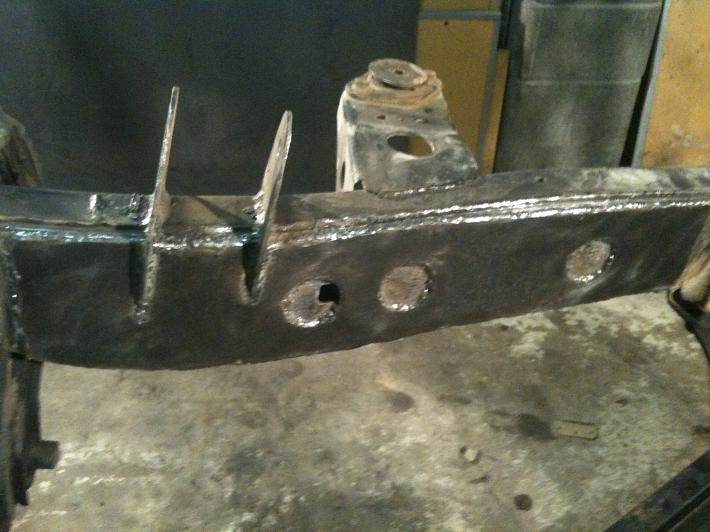

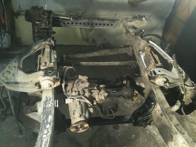

haha ya that what i do for work i fix and sell them....so Im building a long travel 4 linked race truck but im going to keep with the same body and moving the motor back behind the front A arms il keep the pics going as i get farther im hoping to have the motor in the frame by friday

and thats the tundra diff in the 91 frame

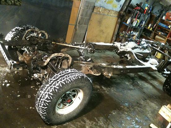

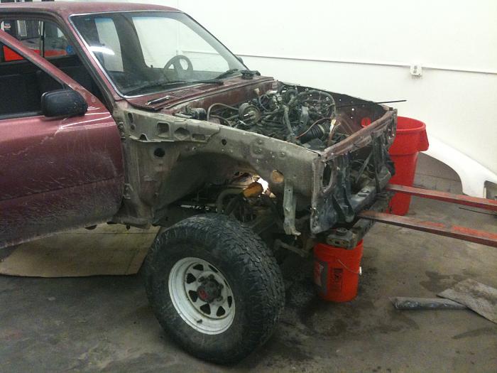

motor and tranny in truck

starting to look like a truck again
