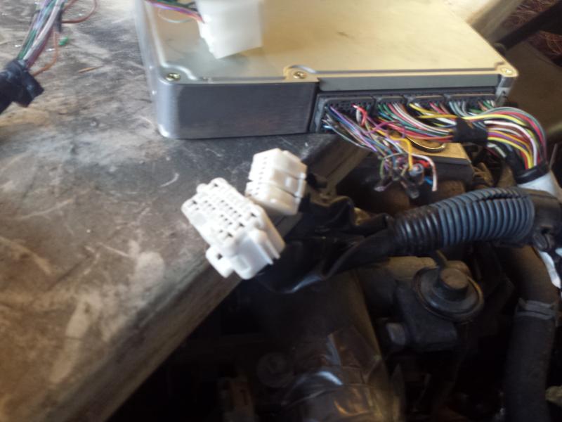

Those 2 connectors are the problem. They join wiring harness. I can not find any info on these connectors. I fear that they will have to be traced, and That is was i was missing i think. joy!

Some of the Tranny wires come thru the engine harness. So if your running manual then you can remove those, egr, trac control, those each run multiple wires. You can actually loose quite a few wires out of the harness and make it much easier to work with when routing into the cab. Funny how the sub 02's are part of the body harness though... Anyway awesome to see you working on a motor home.
