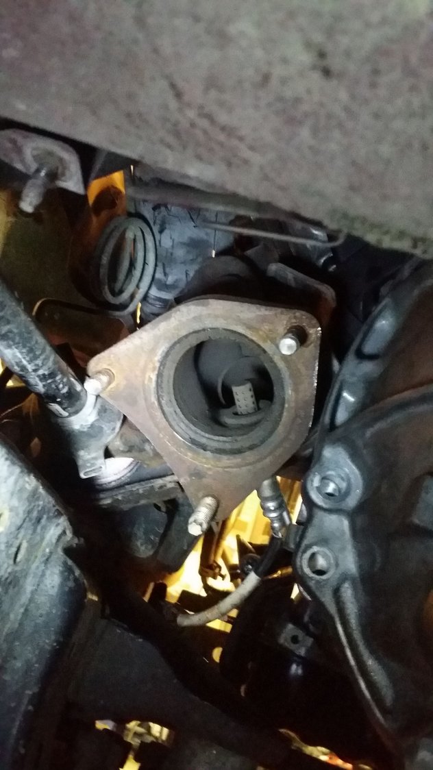

I will have to cut and turn the manifold plate so that they dont interfere with the torsion bars. The exhaust manifolds interfere with the upper control arm if I am too far forward.
Driver side manifold

So I think I have a solution to some of these clearance problems. I was playing around with the engine placement, and it turns out that if I get the oil pan within an inch of the center link, the steering arms actually clears the exhaust manifold. Barely but it does. Now for the steering stabilizer tab on the center link, I am thinking I will just cut it off and use a couple of U-bolts with a plate to hold the stabilizer to the arm. I have seen aftermarket kits do that on super duty trucks, not sure why it wouldn't work here.
The valve cover contacts the brake booster, either will shave down the valve cover or knock a small dent in the side of the booster. You know, precision fabrication here.
I had cut and turn the exhaust manifold flanges, but they were still interfering with stuff on the truck, so I cut part of the flange off on each. Will have to redrill and tap for a third bolt now. I should have thought ahead and bought universal exhaust flanges to weld on.
