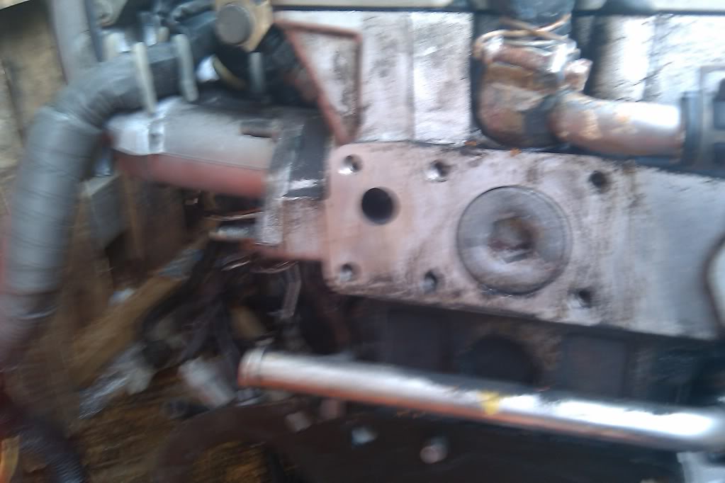

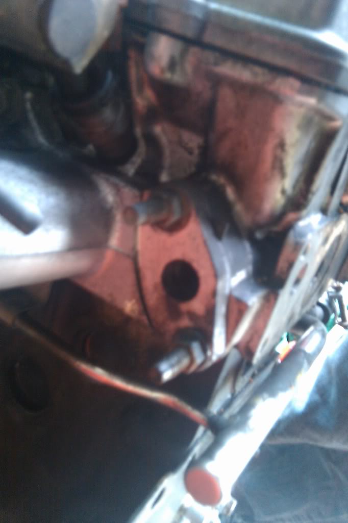

ok im lost on this hole on the back of the head. i have no idea what it does or what it goes to. ill bring some pictures tonight to see if anyone can clue me in

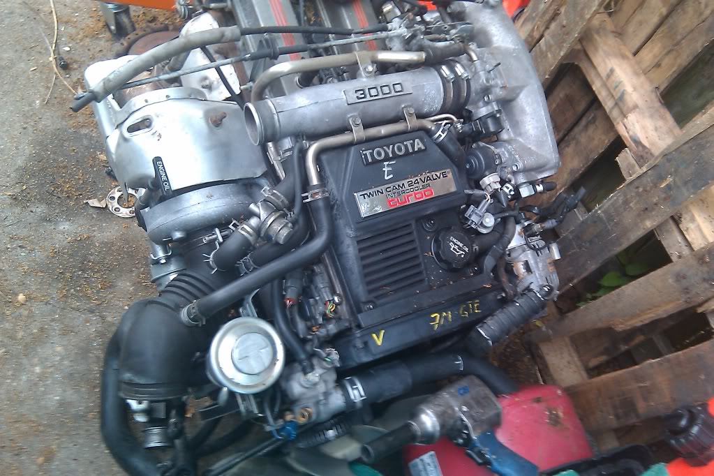

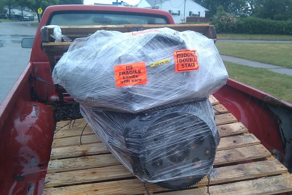

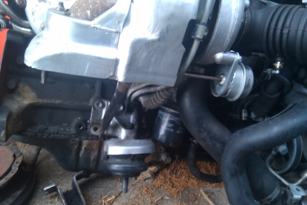

ok i got pix of the port im confused about, and some pics just to show u the condition of the engine. paid $1,400 for it.

isn't that the egr port?

i have absolutely no idea, i was looking at it closely and it looks like its just a port to the hole on the other side. but im not absolutely sure

Yes that for the egr port.
On the USDM engine's the exhaust from the no. 6 cyl, where that small plate (can just barely see it in those pics) at the back is, gets channeled by a small manifold of sorts that bolts to the back of the head.
Exhaust goes from the hole on the back (exhaust side) through the other hole (intake side) then into a valve and finally in the rear of the intake manifold.
JDM engines don't use exhaust gas recirculation, so there's small steel plates on the head and intake manifold to block those holes.

ok so I went to see how the engine will fit and I can't get the engine low enough to bolt the the tranny. I think I do have to cut the oilpan.. this sux. I also have to make the new mounts for the engine

I take it that you are trying to use the supra pan in an ifs truck, and if so, cutting the pan or an SAS are probably your only options. As I mentioned before, NA 7m bell/clutch/pp/fork, a cressida pan/pump, and 22re rubbers connected to engine mounts from a 5m supra/celica will allow the motor to bolt in. Mine fit great. Redrill the dipstick hole and set the length to show full at 6 quarts. If you make mounts instead, post lots of pics.
