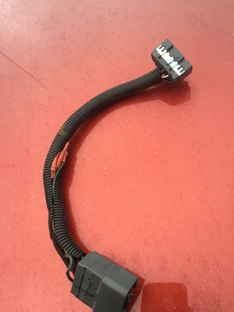

Adapter harness I built for the 1UZ to pickup body harness.

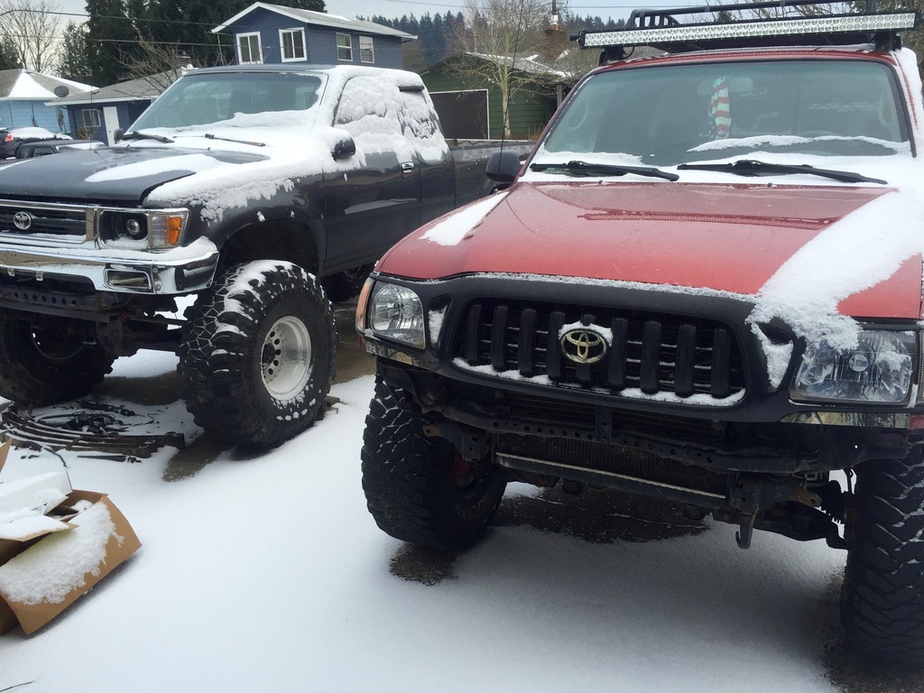

The Yota got a bit of attention during a snowstorm..

Update: The first ''thinned out'' wiring harness i had a buddy help me with didn't turn out very good, so I figured out a better idea. Using the female end of the 1uz engine to body harness and the male end of the 3vze's engine harness, an adapter harness was made, so limited wires had to be repinned. This is a great idea and i would definitely recommend it to anybody doing this swap.

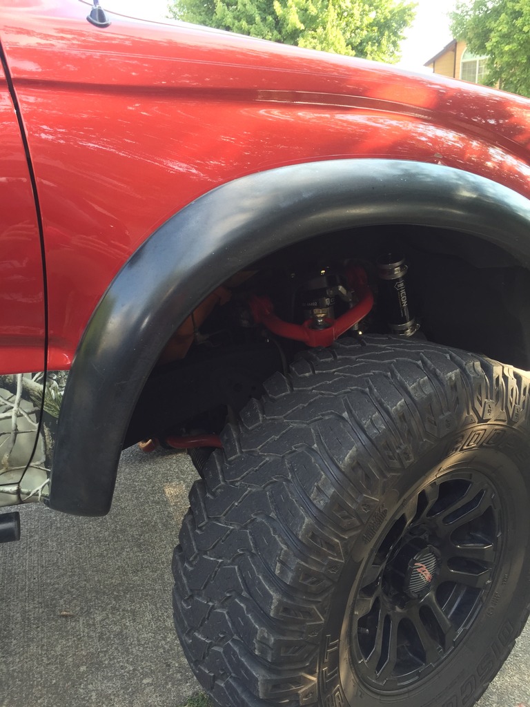

37s fit well 37.5x14.5r15 Toyo open country with trail gear 3" front 4" rear springs. Doesnt rub somehow ��
