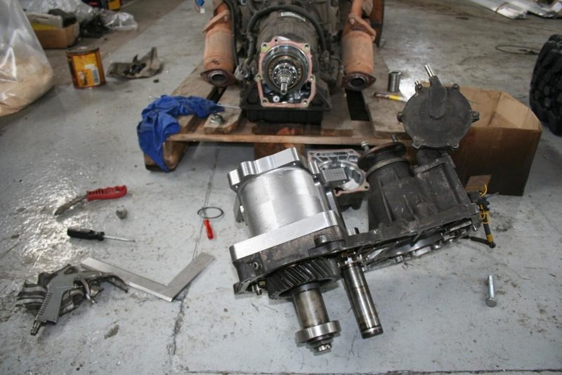

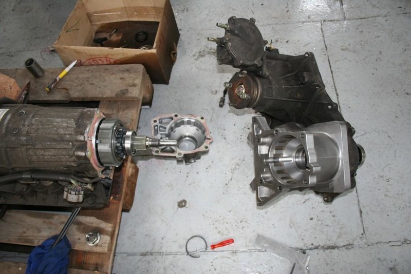

Hey serg4x4, that's a nice adapter in the last picture. Where did you get that? I'm still new to this, so I don't recognize that transfer case - what is it? What did you do to couple the splines?
Thanks,
Chris
Old 01-21-2015, 08:25 PM
serg4x4's Avatar
Join Date: Jan 2012
Location: Russia
Posts: 31
Received 1 Like on 1 Post
Hi Chris.
A-cad.
3D model
CNC machine

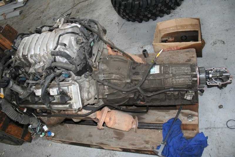

OK. So here's a small update. Progress has been pretty slow. But the engine is in:

The biggest obstacle was coupling the transmission to the t-case. As I showed above, coupling the splines was the easy part. I then had to make brackets to hold them together.
I had to modify the transmission tailshaft housing. These holes were already there, but I had to re-drill and thread them to attach brackets:
I also used the original transmission to t-case housing as the basis for the new bracket, but it needed some significant modification:
