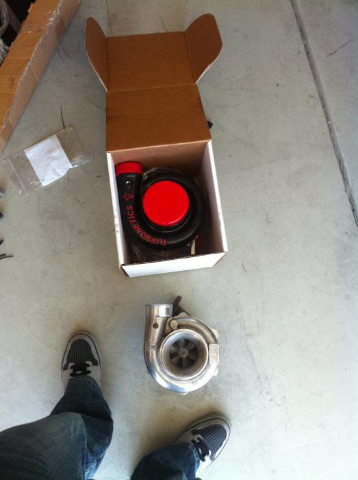

Old turbo went bad and had a crack in the turbo manifold so got some new goodies
Old and new turbo..... little bit of a difference lol

Old turbo you can see how it was scraching the hell out of the housing cuz there was too much shaft play. EBAY SUCKS!

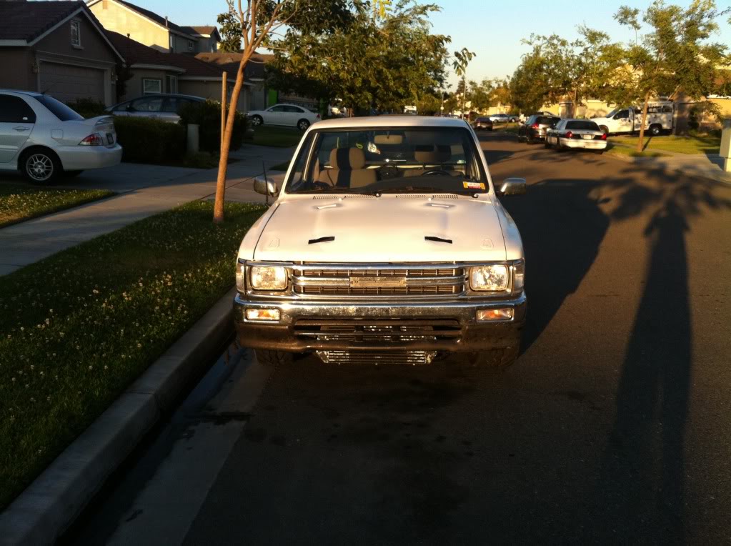

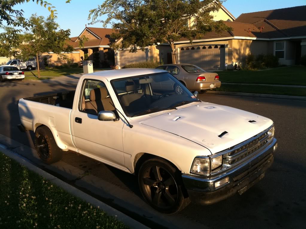

exterior shots with some slicks on it. Running RX8 rims all the way around.

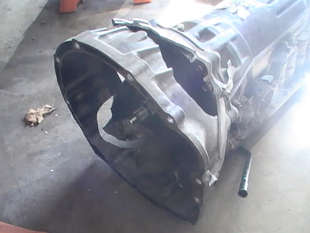

what bell housing did you use???

A 1jz bellhousings was used. And sorry for no replies. I had this set to let me know when anyone posted on it but today is the first time i got an email. Now I would like to tell you all that at the point of the new turbo is when I took ownership of the truck. Everything b4 that was done by a friend.

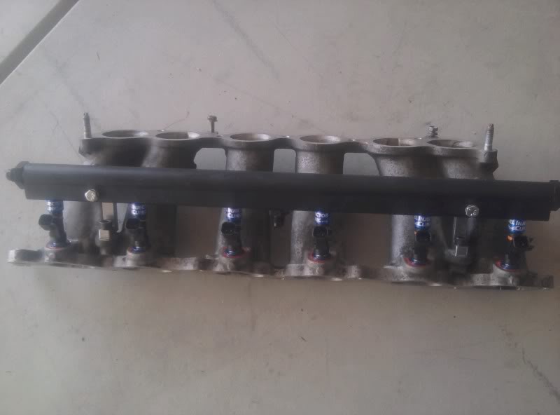

The truck has been down due to an idle issue but think we have it fixed and have also upgraded the fuel system with new high flow fuel rail, 900cc injectors, all new 6an fuel lines, 2 walbro 255lph fuel pumps, and lastly a 16 gal fuel cell. Will post all the pics up tomorrow.

900cc injectors... what boost level are you running?
Old 02-02-2012, 07:00 PM
MattMcCarthy's Avatar
Join Date: Oct 2011
Posts: 14
Received 0 Likes on 0 Posts
Going to run 20 for the street tune and 25+ for the track tune.

the 900cc injectors are a little big, wont use all the potential = lower injector cycle rate.
Old 02-02-2012, 07:29 PM
Join Date: Oct 2011
Posts: 14
Ok got what your saying. As far as the supra community says that there not that big. We will see. I cant push more then 650hp due to the internals and the trans.

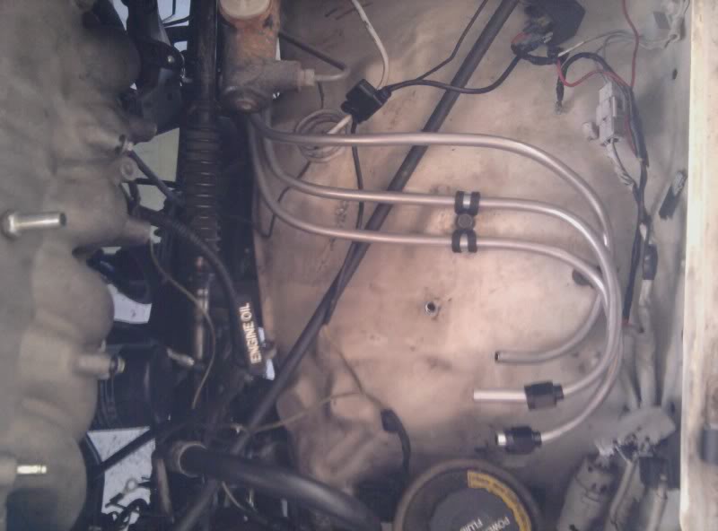

Line running
Size:  38.3 KBName:  FuelLines2.jpg

Injectors and fuel rail mounted

Fuel lines almost there. Getting flared today for the AN fittings then just need to run the braided lines to the rail and test it out.
