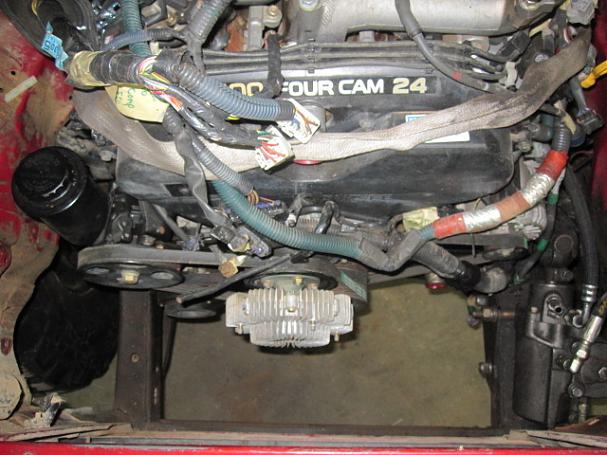

for example, here is a clearance shot for the radiator and fan on my setup:

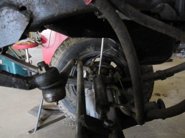

Next is the transfercase mount. I'm using an aftermarket mount from Front Range.. looking at this, it actually appears you COULD keep them in stock location. Notice the four bolts on the frame with the first transfercase mounting area between them.

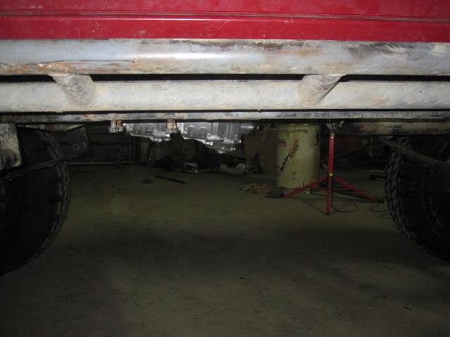

The last one shows why I needed the oil pan swap..and that was with a suspension lift. With no lift, I dont know if it would clear the front axle or not..

hey tatonka
Is that a 3.o truck/runner pan?
We are talking about SASing this truck after the swap is all done and wondering if I would have to change the pan? Not that is a big deal......but one less thing is always good. I would probably end up with 4" Marlin springs up front if that matters.

dntsdad- That is an 85 22R truck. As you can see, I dont think the other pan would clear the axle/steering components. The oil pan is the one ORS recommended.
