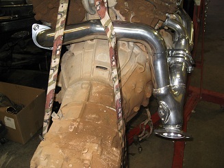

I chose a set of Doug Thorley Headers for my 3.4 swap because they were the shortest headers which allowed me the most flexibility to reroute the crossover to the driver's side. I just cut and sectioned the original crossover, reusing most of the pipes with a 6" flex fitting and adding some pieces from a 2.5" J-tube from Summit. Once all the finishing welding and test fitting of the trans and starter was finished, I had it all ceramic coated like the original Thorley Headers are.
thats one sexy looking motor. love the red valve covers
