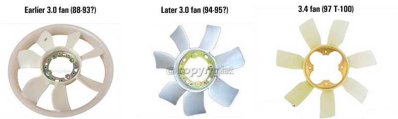

Fan comparisons
Here is a quick pict I put together of the three different fans. The early and later 3.0 (dont quote me on the years, I am going from carparts.com) and the 3.4. It should also be noted that the 3.4 fan in the pict is for a 97 T-100. I don't know if tacos or 3rd gen runners are different.

i had the 3.0 fan with the ring but am now using the 3.4 fan out of the '97. but its far enough off that even a smaller fan would be noticably offcenter. only thing i could think of is having the mounts on the wrong sides but being as i changed mine one at a time with the motor installled, dumb i know, i dont see how i could've switched them.

Just for your thought process, I am using the ringed fan from the 3.0
