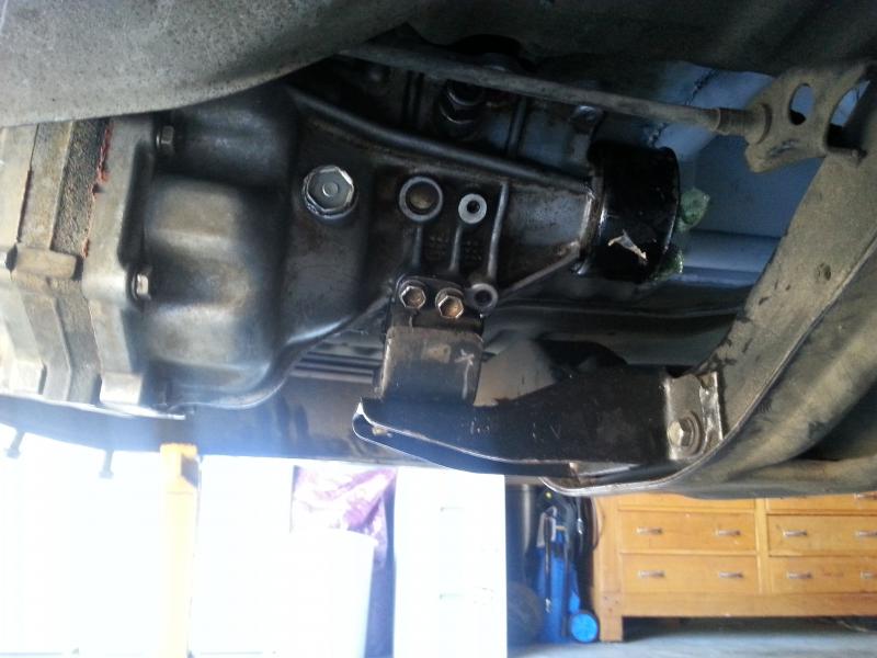

So i just finally went to drop in my 3.4 5 speed w/2wd t100 oil pan into my 2wd 4cyl truck and was totally bummed when it seemed to not fit! I searched and searched through endless 4x4 swaps for info on a 2wd swap and stumbled onto this tread. Funny thing is all of the people chiming in with similar problems are building prerunners and members of dezertrangers.com like myself! Looks like I need to track down a oil pan, pickup, baffle and dipstick from a 2wd 3.0 V6 damn it. Also the R150 trans has 3 mounting points on each side where the rubber trans mount has two, does it mount reaward or forward? Thanks!
