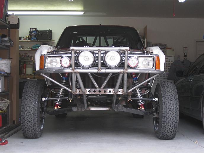

What it looks like now at least:

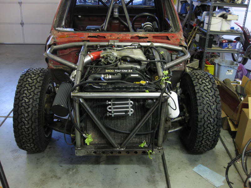

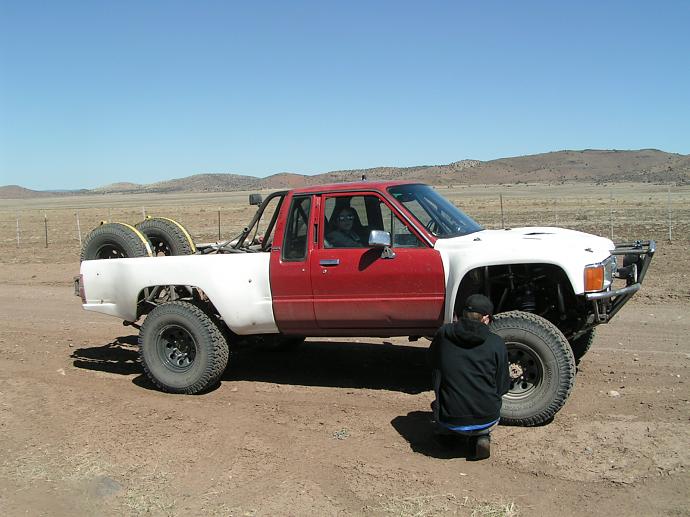

Little update, ive had it running and driving for about a month now and put about 3-400 miles on it. Motor runs absolutely perfect now.
It might also be for sale if I get a reasonable offer. So if anyone is seriously interested, PM me and Ill give you all the specs.
Attached Thumbnails My 87 22r to 3.4 swap-img_0262.jpg   My 87 22r to 3.4 swap-toyota-run-001.jpg
