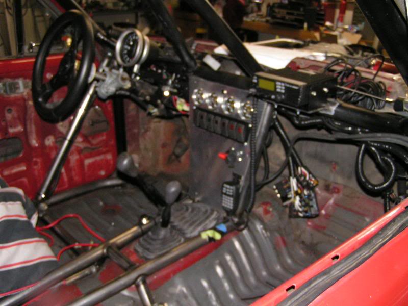

And the interior, which is nothing more than a jungle jym of tubes, the ORS stand alone harness, and a steering wheel...
I'll be working on the electrical again today.

I like it. I see alot of wires with tape on the end :O

Yeah, the majority of it is for gauges and lights/switches. There's really not a lot to connect actually. Where to mount all the fuse blocks and relays is my biggest problem right now...

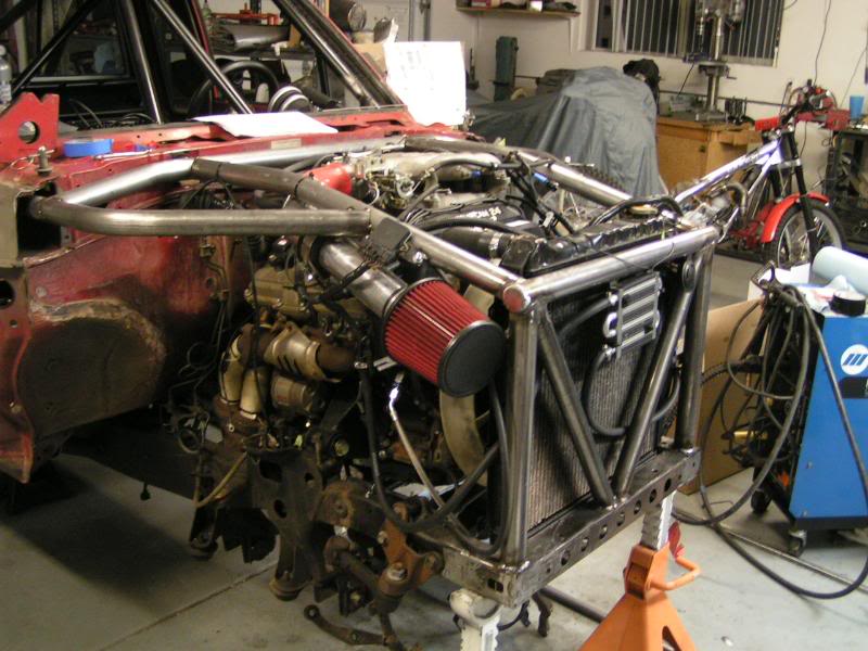

Been slowly tinkering away at it over the last couple weeks.
Got the radiator mounted, 3.0 shroud won't work so I guess I will just get an electric fan. Maybe a Taurus fan. Are their any other decent fans that fit the 3.0 radiators?
I also picked up a used Total Chaos Uniball kit so I ripped the old front end off. I'll be running a dual rate 10" Sway-a-way coil over and SAW bumpstops.

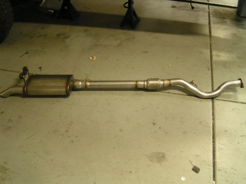

Also built a simple exhaust. Im using an o2 simulator so I ditched the cat completely.

Got most of the electronics and gauges mounted, minus the fuse blocks.
