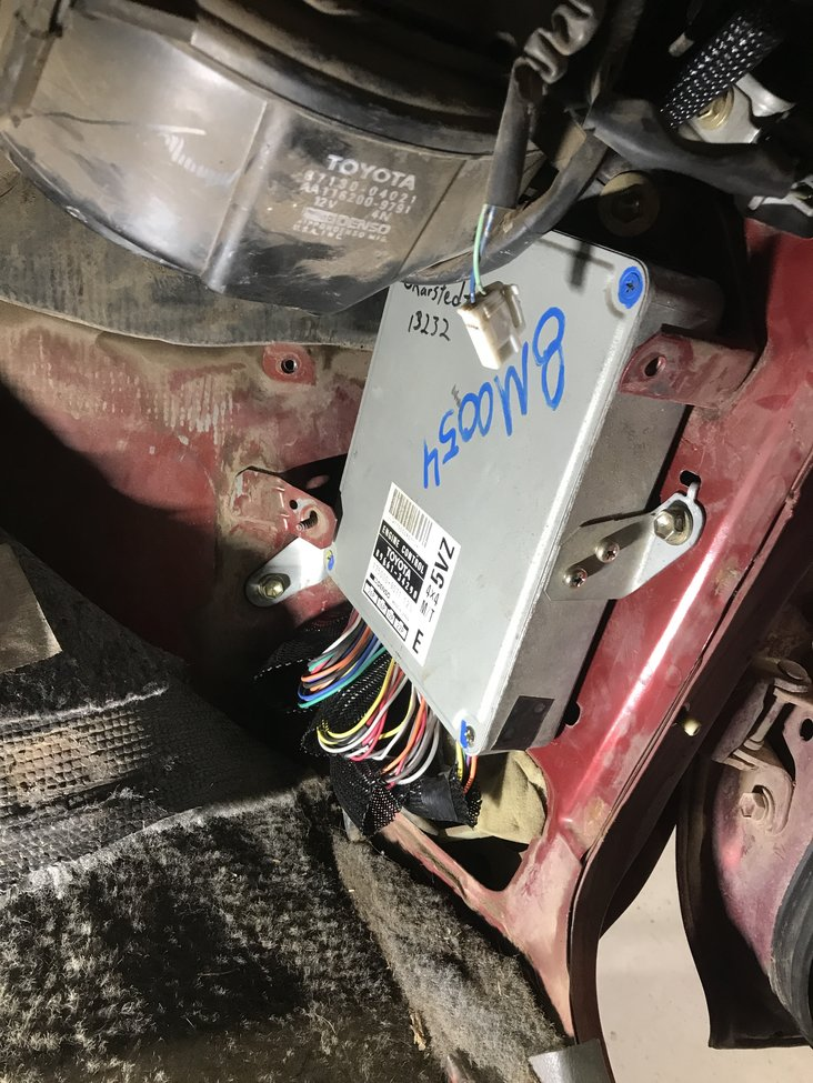

Hey just wondering how is everyone mounting their ecu? Mines just sitting on the floor it doesn’t look like it would fit in the original spot. Can someone show me how they did it?

I just mounted mine in the original location. The front mount is off the old 3VZ ECU. You can only use 2 mounting points this way but it works fine.
