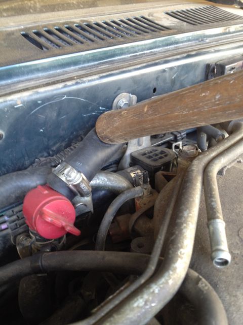

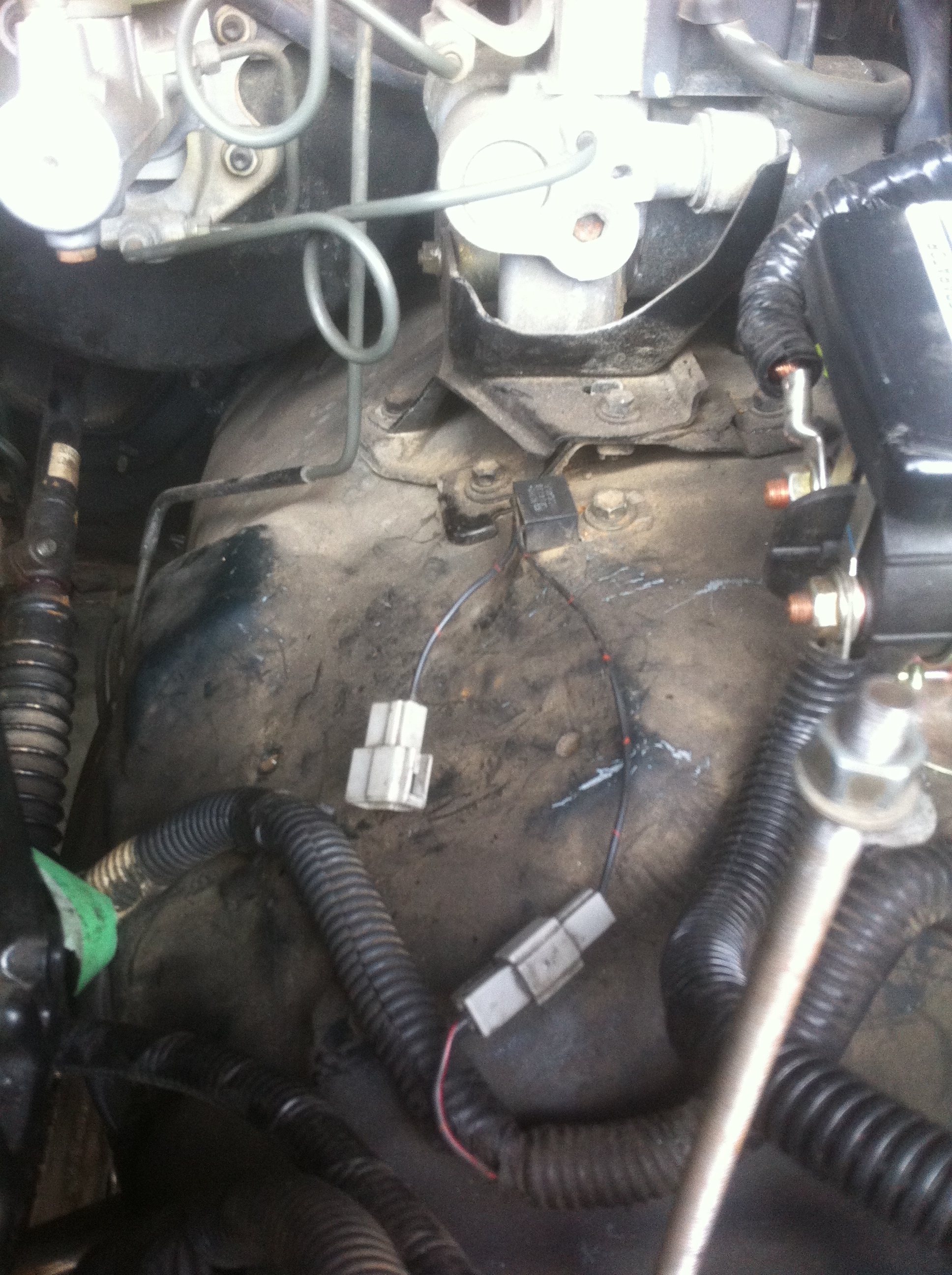

Finishing my swap, but it seems I never marked these two little random parts. The first is a vac line off the back of the block, second is a random little black box under my master cyl.
1995 v6 4runner 4x4. Here are the photos:

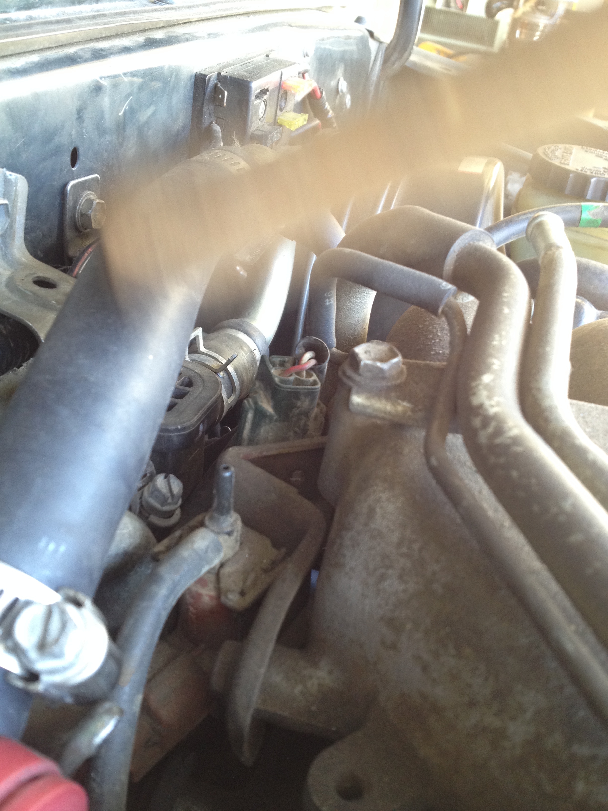

the vac line

donor must be early tacoma or t100. The ectrical connector is missing the part that bolts to the block its a noise filter.
the vacuum line is for the fuel pressure regulator "system" it needs a vacuum source from the small vacuum line above it I believe... But you might want to just google vacuum routing for what ever the donor was.

Noise filter? Interesting. So if I get a spade connector and round connector stick it onto the block all my noises should be filtered?
Im digging through the vac diagram now. Donor was a 95.5 taco.

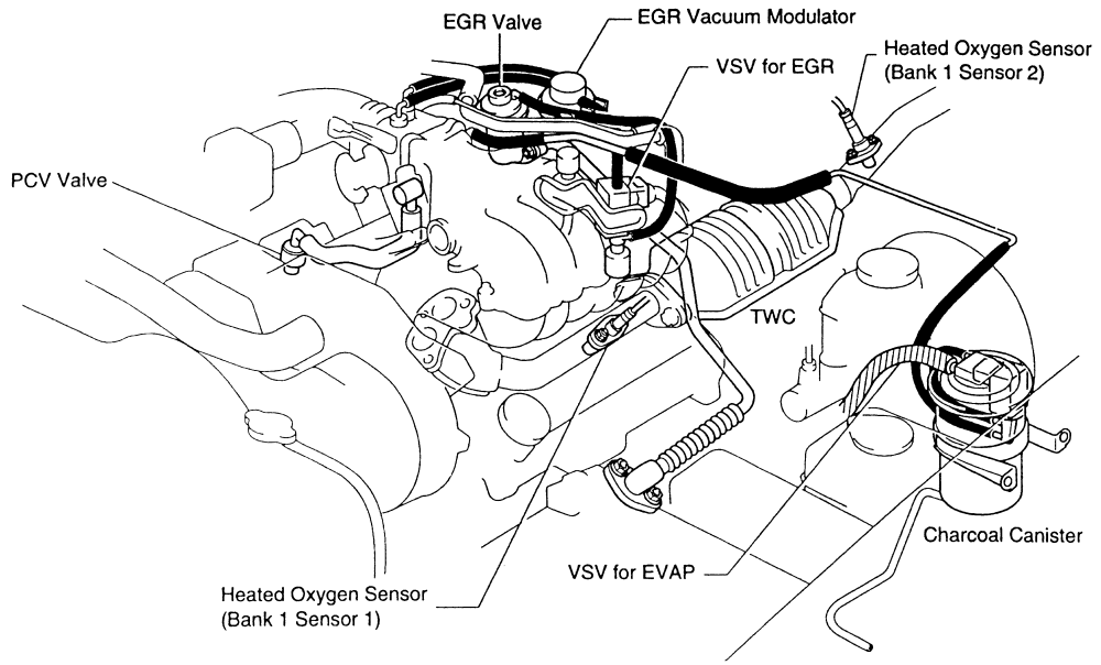

Reading up on the 3.4s apparently they "did away" with the EGR stuff, so I'm a bit confused on this diagram. I certainly don't have an EGR valve. Going to look harder for a better diagram.
you don't need it .. it is to supress the noise from the distributor to the radio .. 3.4 does not have a distributor

that port is for the fuel evap system . I don't have my "notes" in front of me at the moment to tell you exactly how to route it .. I'm sure some one on here will chime in
: > edit ..vital22re said it all above
