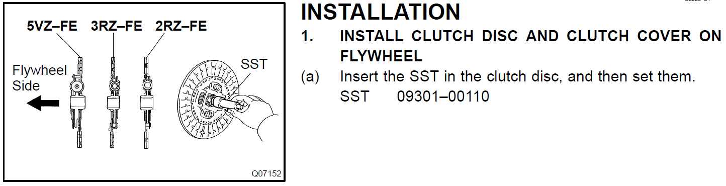

I searched around when putting in the clutch disk back in and everything I found said to put the side with the springs protruding out towards the transmission. Flatter side towards the flywheel. That is how I installed it. However the FSM shows the 3.4 being installed the other way. Was I correct in following the instructions for the 3.0? Any other ideas as to what I might be dealing with?

yea hthat image dont look right, the springs are always facing out. I used the same clutch in my swap and the springs were facing out
Old Aug 29, 2018 | 11:15 PM
Kolton5543's Avatar
Joined: Mar 2013
Posts: 422
Likes: 27
From: Safford, AZ
Its not unusual to be misinformed by the FSM. The springs side should be toward the trans. There's usually not enough space in the flywheel for them to go. Even if it were back wards, as long as it doesn't hit anything I don't see how it would keep the clutch from completely disengaging. If it were touching something you should hear it. Slave cylinder bolted down tight? Are you positive its bled completely? what flywheel and pressure plate are you using? 3.4 or 3.0? what were you using? you didn't accidentally put a 3.4 release bearing in did you? It should actually be longer but weirder things have happened. Sometimes the pedal just needs to be adjusted a little tight. Maybe with little driving it will break in. You didn't replace the slave or master cylinder did you? the wrong one could cause this problem.

Thanks for the replies. My clutch components are all OEM aside from the MC flywheel, and it was functioning well with my last 3.4. I'm pretty sure it is supposed to go in per the 5vz FSM. I started pulling the transmission last night and just have the bell house bolts to go. I'll report back with results one way or the other after flipping the clutch disk.

It all depends on what brand clutch you get. The early clutch disks and covers were designed with the springs were about 70% of the way protruding out of the disk. That style clutch disk needed to be installed facing the flywheel. Most of the new and aftermarket clutch's have the springs 90% sticking out one side and will often have a label or punch marks showing which way to face the clutch disk. I haven't seen the old style clutch's for a while. Most should be phased out. When in doubt, check for a marking on the disk.

I'm still waiting for some replacement parts, but I have found numerous places that note even if the clutch has markings on it (as mine did) you MUST install it with the springs facing the flywheel. From the ORS website:
When I dropped my transmission I found the clutch disk was actually contacting the transmission output shaft beyond the splined section(keeping it from going any further back). This mushroomed the output shaft to the point that I had to do a little file work to get the release bearing off. The heat generated even melted the fwd edge of release bearing inner race. Apparently the clutch disk for the 3.4 is the only one that Toyota has ever designed to be installed springs/protrusion facing the flywheel.

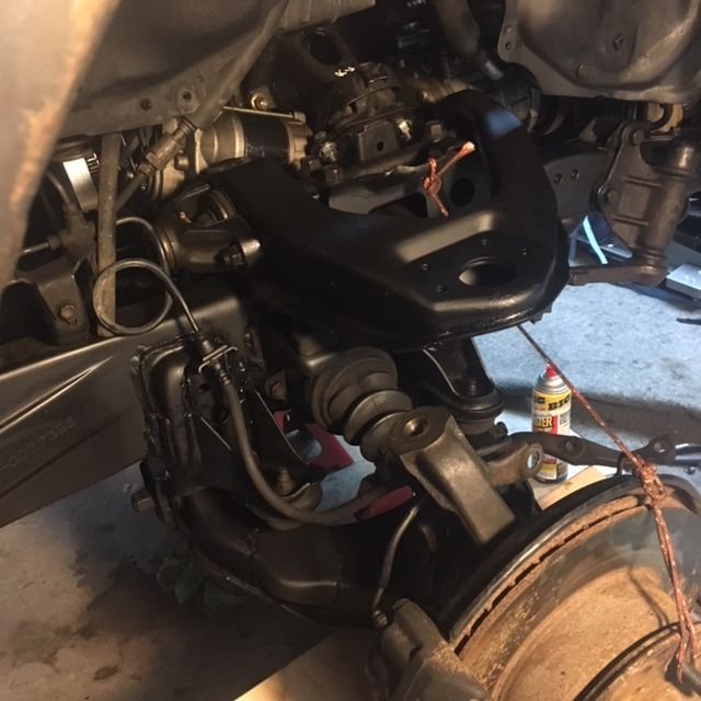

Cleaning Up the front end for new ball joints, torsion rods, BJ spacers and shocks

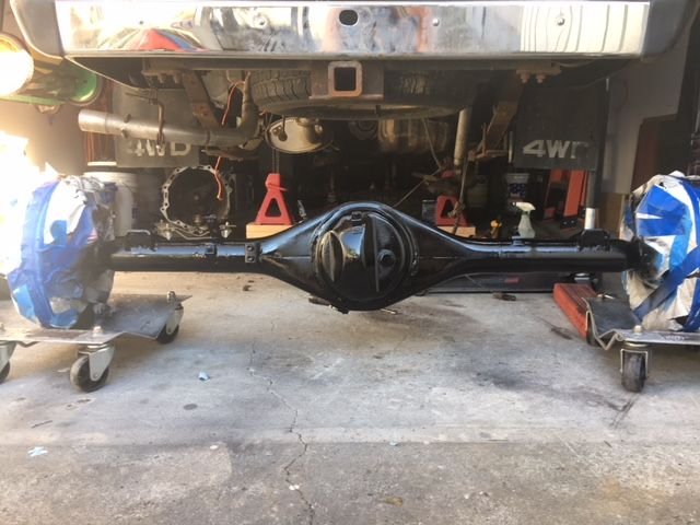

Cleaning up the rear axle for a flip kit, Wheeler's bump stops and new shocks
