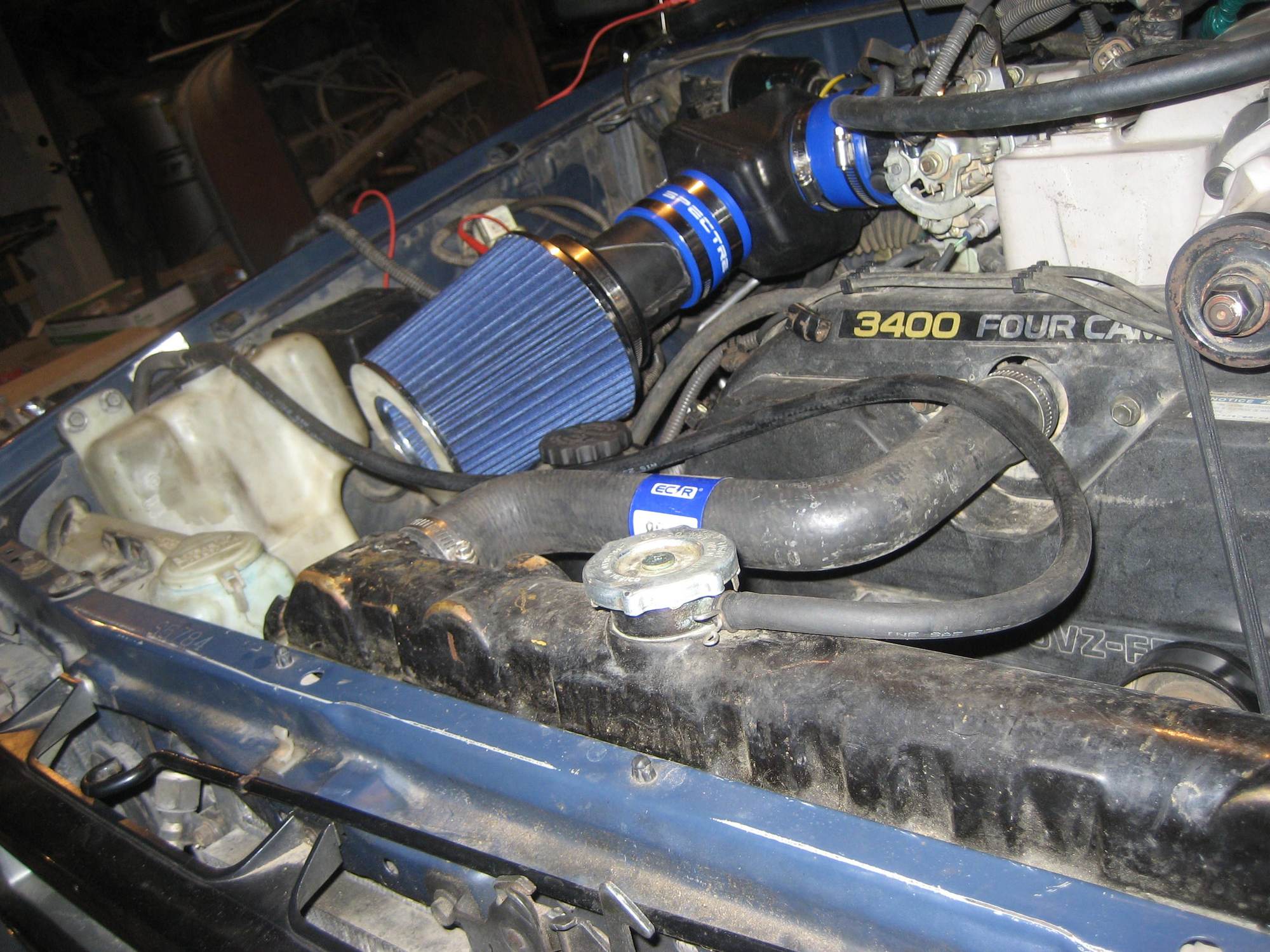

More than 5 years later! I parked the 4Runner in 2012, and it's been sitting in storage ever since. I finally have the funds to resurrect the project, but unfortunately I'm going to have to pay for most of the work to be done. In the mean time, I thought I'd upload some very old pictures from the swap I did back in the day (with low funds!) in case they help anyone.

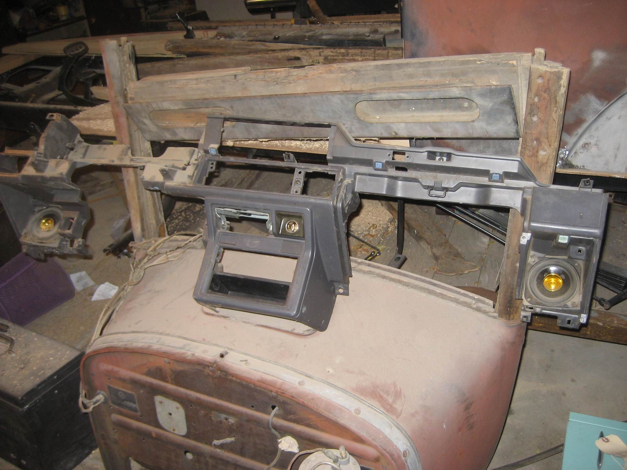

Dash
Dash
