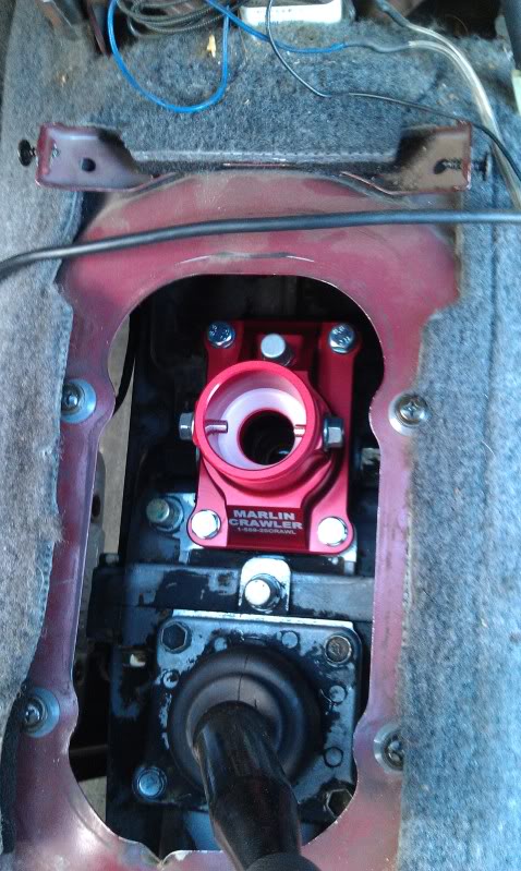

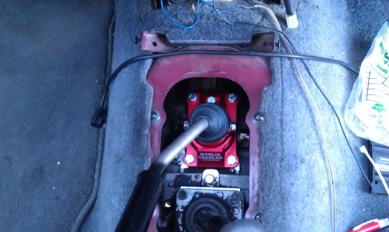

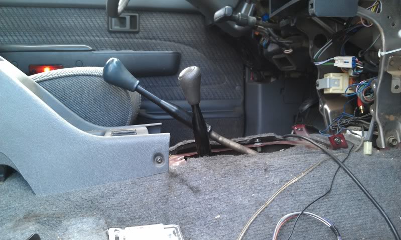

Marlin Short Throw Shifter
And for a bit a bling...Marlin's new short throw shifter to help with the interference from the body lift:
Installation was a breeze, 4 bolts and the old shifter base (with handle still attached) was out, some Toyota FPIG (same stuff I used on the oil pan and valve covers) on the base, 4 new bolts and lock washers.

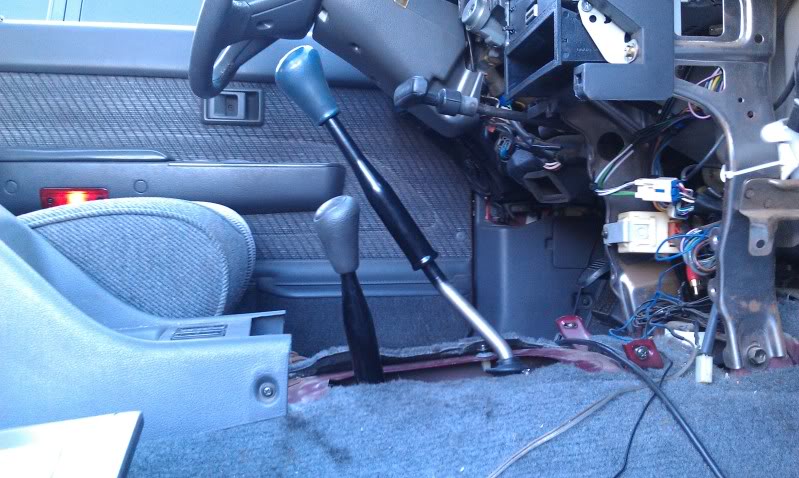

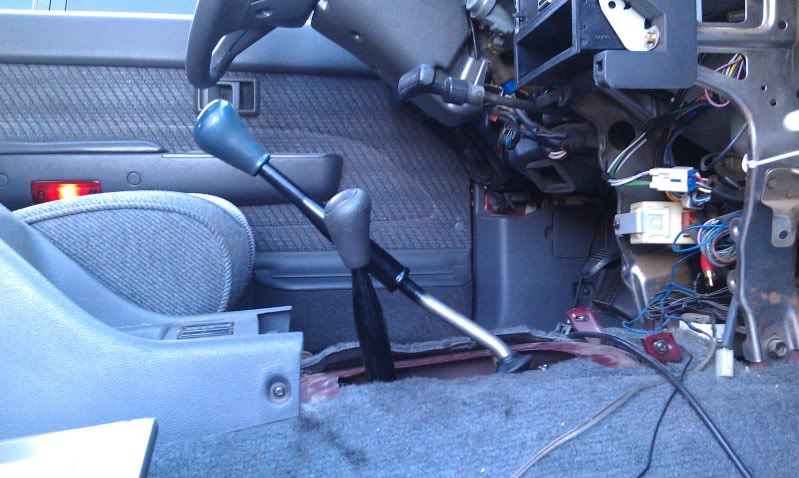

And for a bit of comparison, stock shifter:

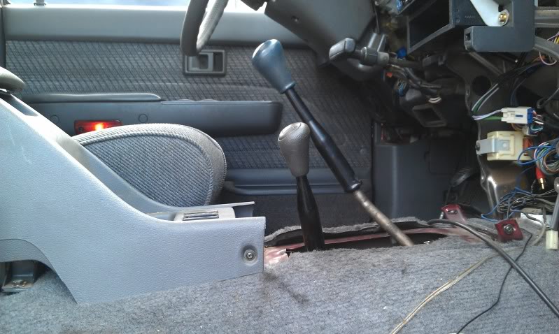

1st
2nd
Marlin's Short Throw:
1st
2nd
It's harder to see in the pictures of 1st gear, but 2nd is very noticeable.
As for functionality, shifts are super short, so short when I was first running through the gears I was sure I wasn't in gear but the shifter wouldn't move any further. Taking it for a test drive confirmed that the I had been in gear and that the shift were now THAT much shorter. The shifts are still a bit stiffer than I would like, but I can already feel the new bushing starting to break-in and the shifts starting to feel better.
And a couple more because pictures are fun:

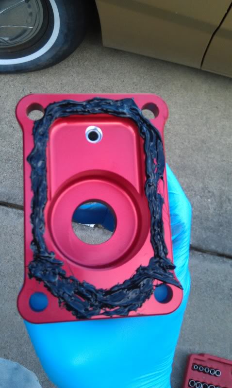

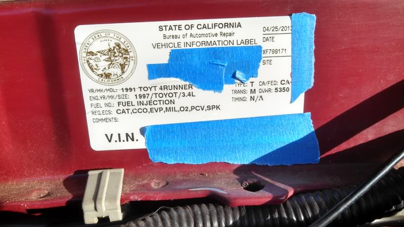

The truck's been running fine now for the last couple of months, had a smog ref visit in early Feb and failed, I was missing a ground wire in the OBD-II port that there scanner needed (but neither of my 2 scanners used...weird) and as part of the visual they grabbed the ECU and turned it over a few times to get the part number, which knocked a couple of wires loose causing the TPS and IAC signals to get lost, throw codes, all causing the motor to run a bit erratic; but otherwise he said everything looked good.
Well after a liberal application of hot glue (yes, the same stuff from the craft store) to the metal pins in the plastic connector housing (with the engine running to make sure they were in the correct position when glued) to prevent the problematic pins from moving around, it was time to set off on another round of driving.
Things went so well, that today I went and got myself a new $8.25 sticker:
The process overall, wasn't bad at all (they actually admitted that they have lightened up a lot over the last couple of years), wait 10 mins after my appointment was supposed to start while they finished the truck ahead of me, then they took mine back, and an hour and a half later brought it back with some forms to sign, the sticker and asked for the $8.25 before he let me apply the sticker (and yes, I was the genius that put it on with those air bubbles trapped inside).

Thanks for posting everything you have about your swap. I am about to start mine once I can find an engine for a decent price. I was pretty worried about the Smog part, as I also live in CA and need it street legal. Its good to hear they have loosened up a bit. Did he make it seem like only at that particular location, or all of CA has been a bit easier on the inspection?
Where did you get it inspected if you don't mind me asking. For some reason I get the feeling that if i try to do it in the bay area they will be a PITA.
Thanks!

In talking with the smog ref before doing the swap and getting it inspected (I called 3-4 times just to clarify that everything I was doing was correct), he more or less implied it was a statewide decision to loosen up the exhaust routing rules (just as long as all the components are in the same relative position as the donor from the factory.
I went to the Sacramento Ref at American River college and didn't have any issues except for some loose wires in the ECU connectors that would disconnect if the ECU or wires were touched (which was an issue I needed to fix anyway).
